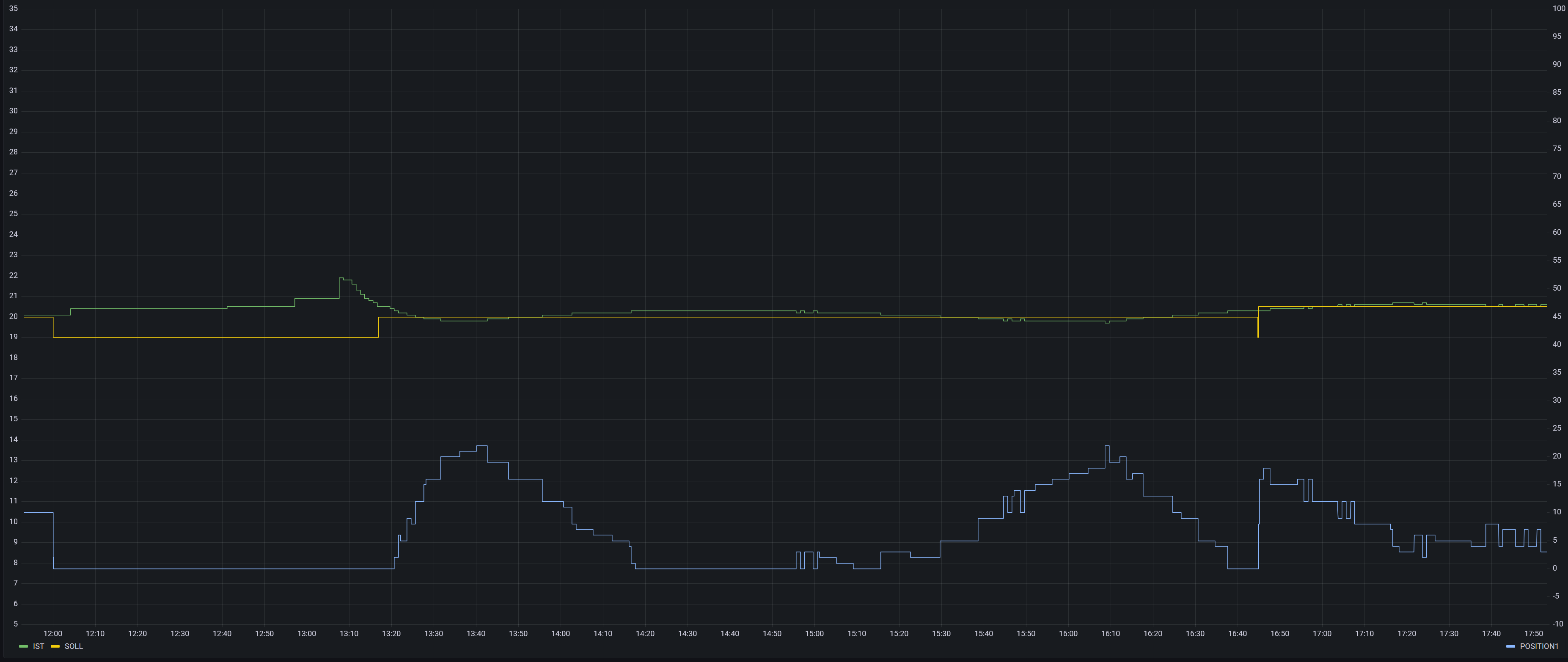

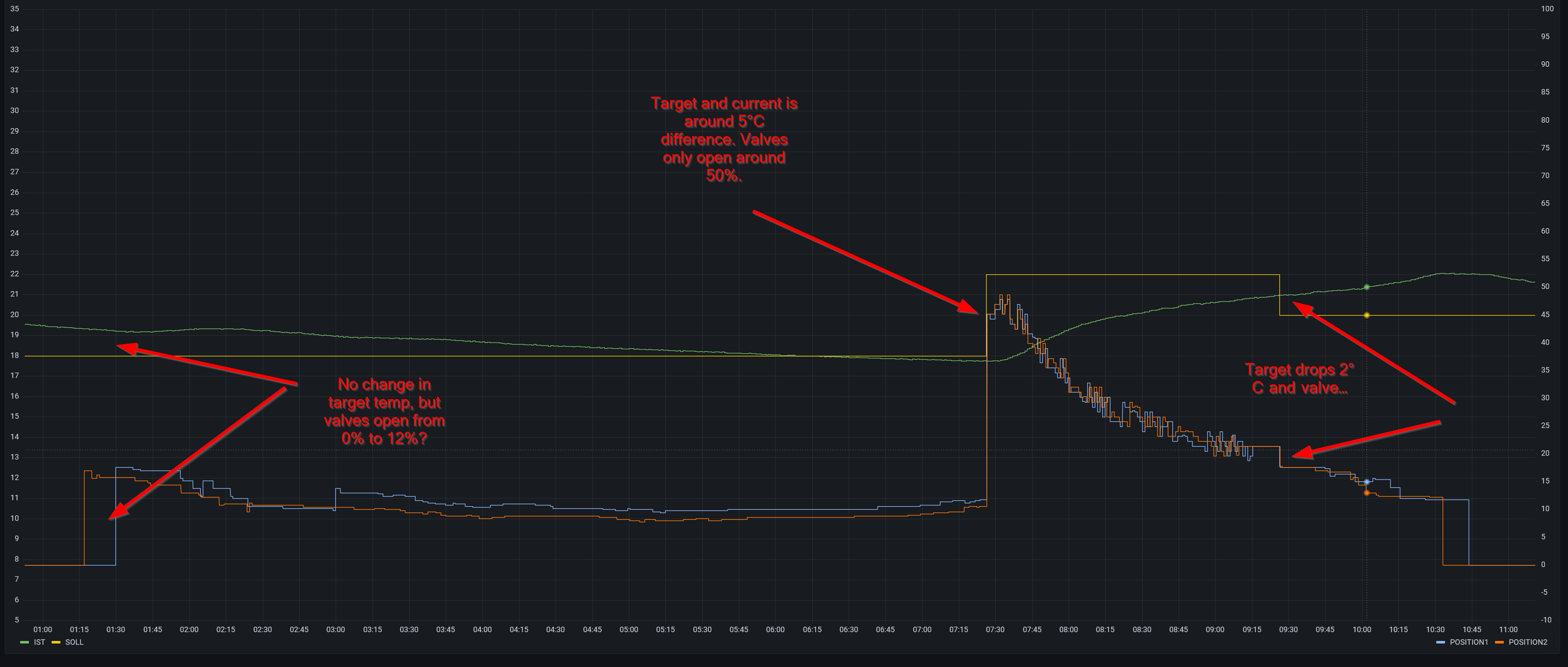

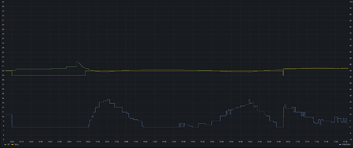

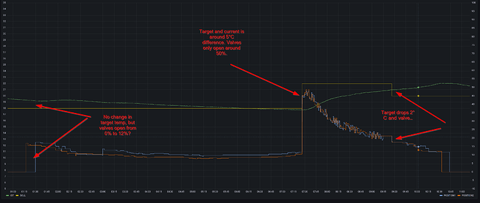

Even with the new firmware the TRVs behaivor is very bad!
I cant explain this bad behaivor.
I created an own PI controller for my Sonoff TRVZB.
This is how it looks like and this is how the W600 should act like:
Can someone confirm, that the E1 had the same bad behaivor??
E1 works great for me (although my house is cold so it never reaches target temperature anyway and I have my own control system to turn them full on or full off)
Nevertheless, operation and schedule and automation of E1 is reliable for me. I wish you had one so you could make these plots too.
