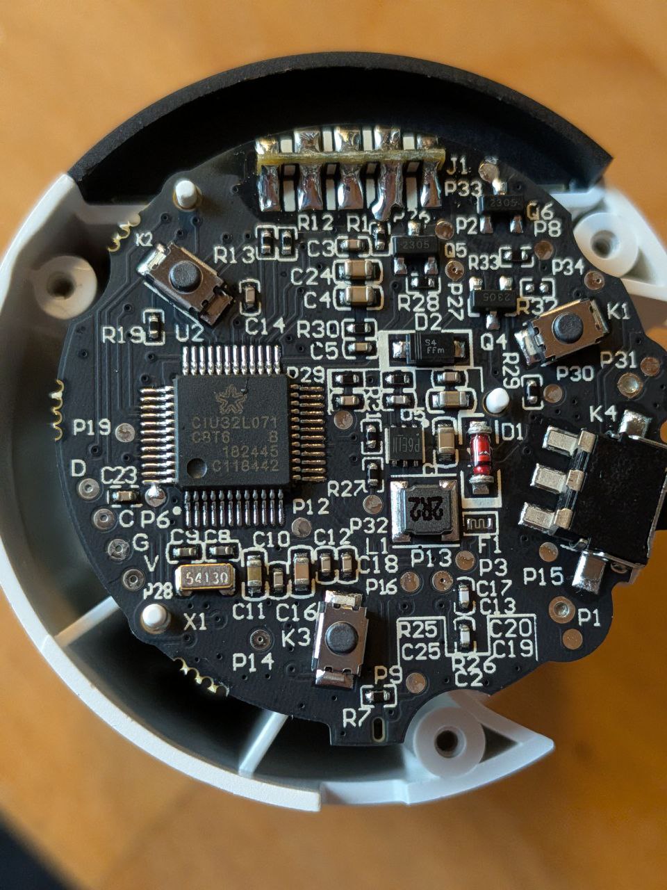

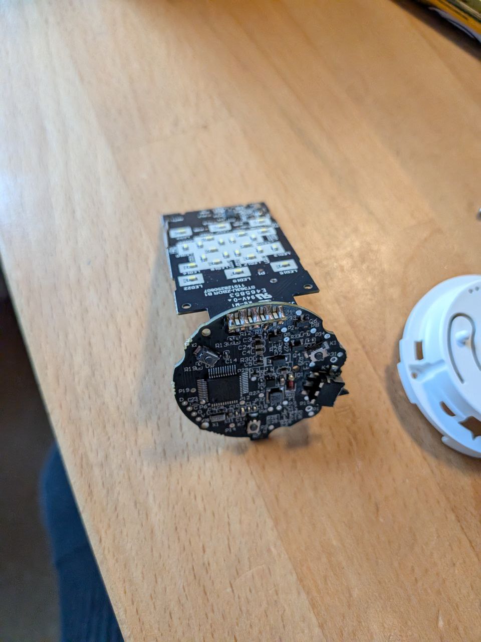

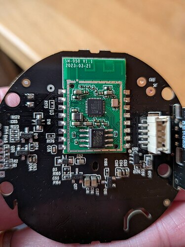

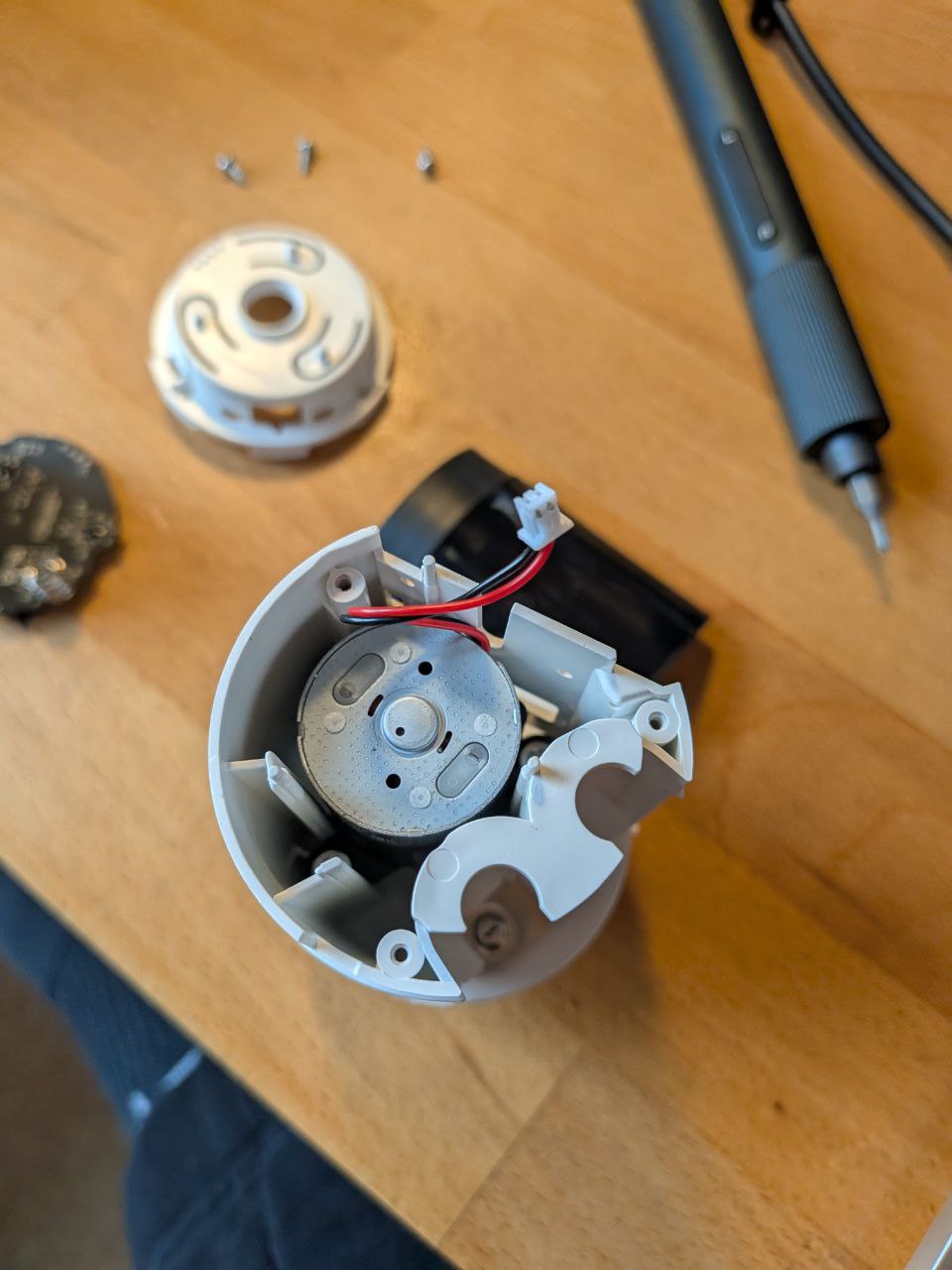

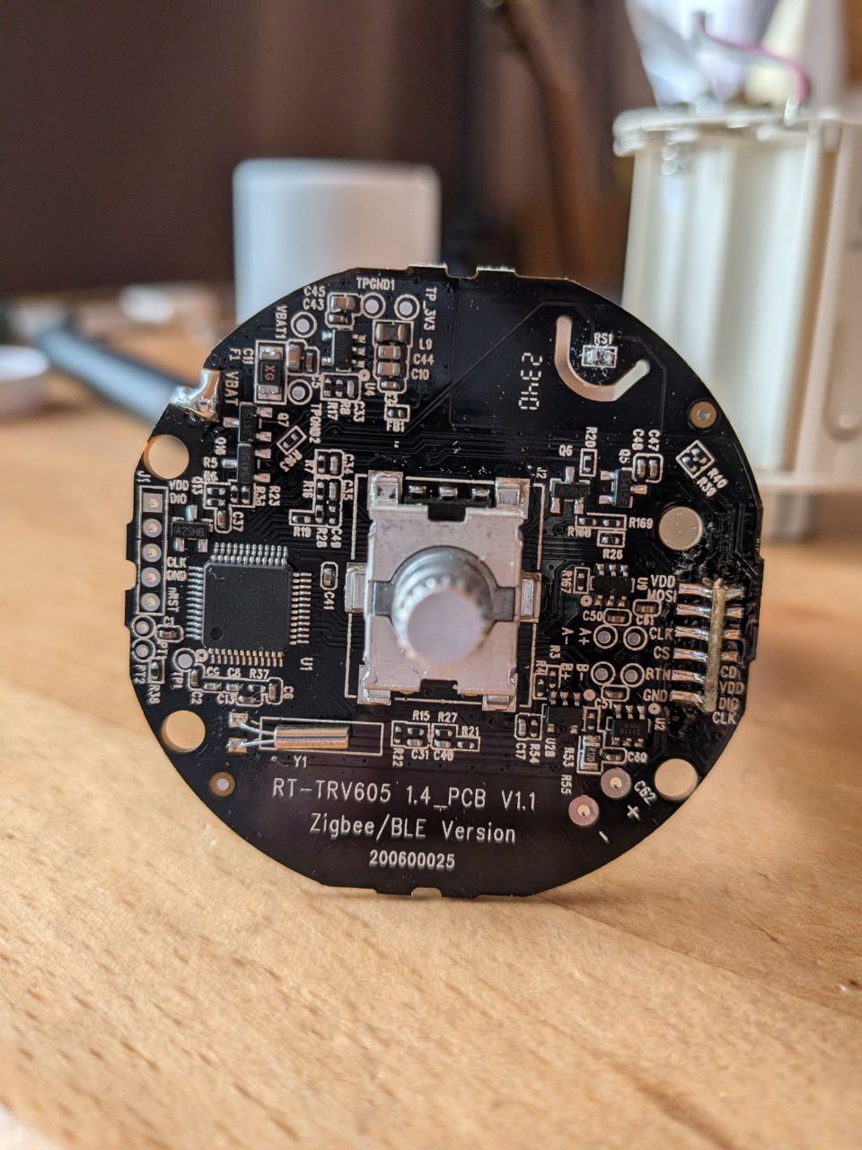

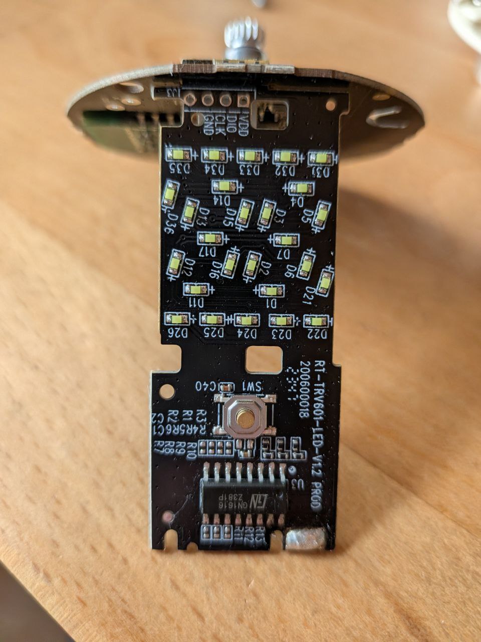

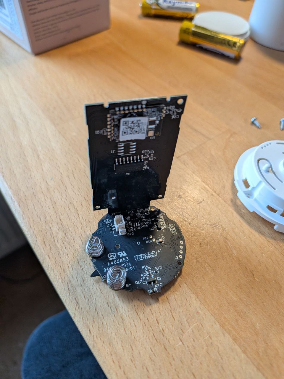

I did a small research on a w600.
The small dc motor looks pretty cheap.
Its only a 2 wire motor, so i guess the W600 is only reaching its positions with time and current calculations.
I like the electrical and mechanical concept of the W600, but its software is still very bad.
In comparison, here is a Sonoff TRVZB which costs the half amount of the aqara.
It has at least a 4-wire dc motor. So it could be a stepper motor or a DC motor with rotary encoder. Its hardware is looking more robust and it seems like it really can “measure” the valve position, but it doesnt.
Maybe someone wanna reverse engineer the W600 and make an acutall good software? :joy:
