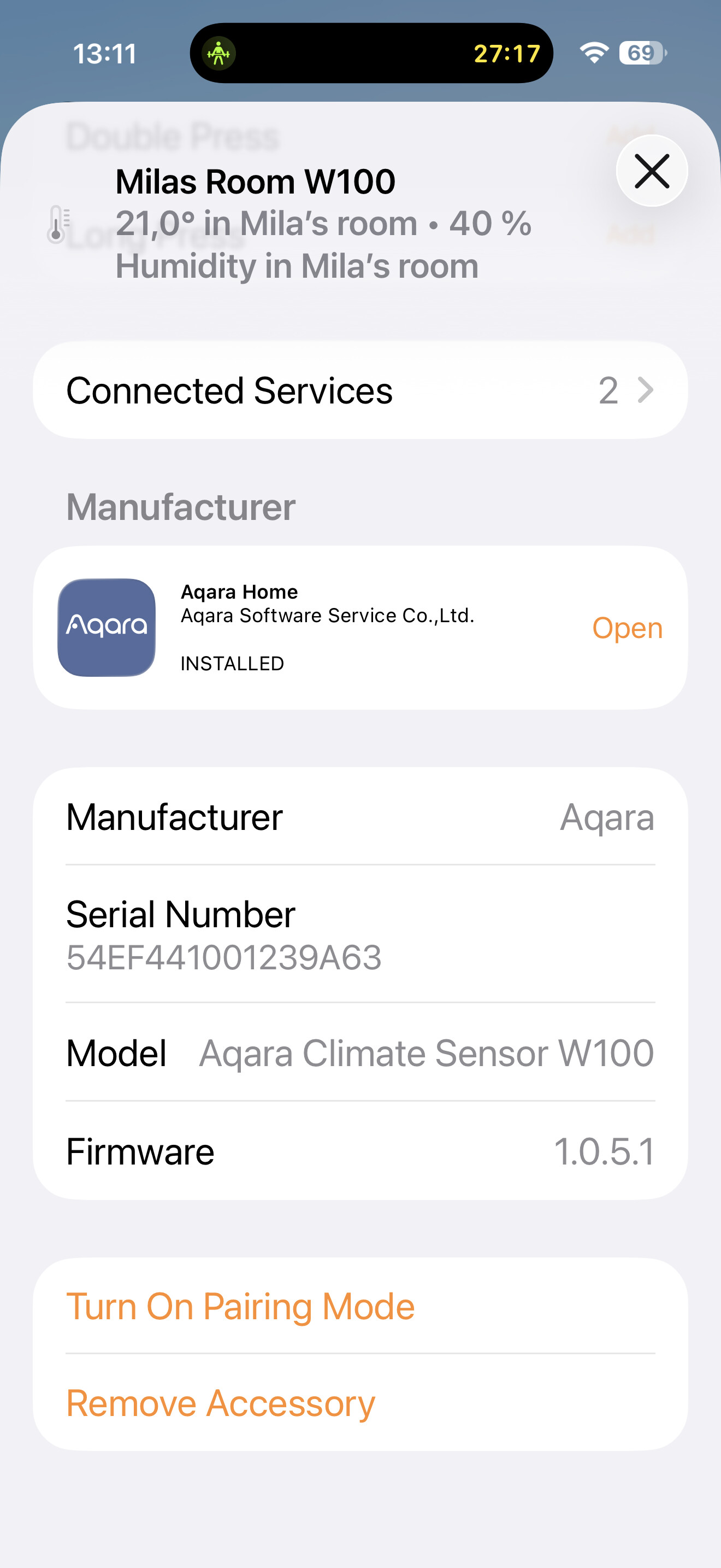

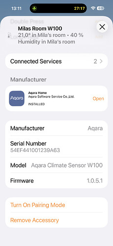

W100 is now selectable as temp source for w600 in thread mode. However it doesn’t seem to use the input.
It is already supported by z2m. But very poorly. There should be an expose for the external temp input at least. If you can connect an external sensor like the w100 to it, there should be an expose. Seems like someone has to do investigations with it.
For the Sonoff TRVZB it took long till they implemented the external sensor.

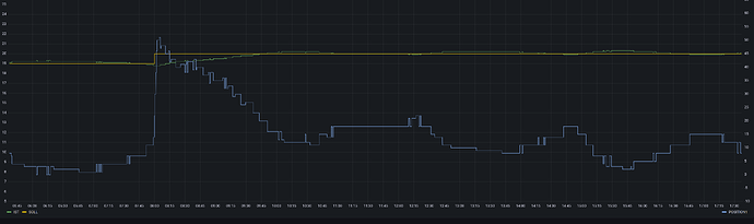

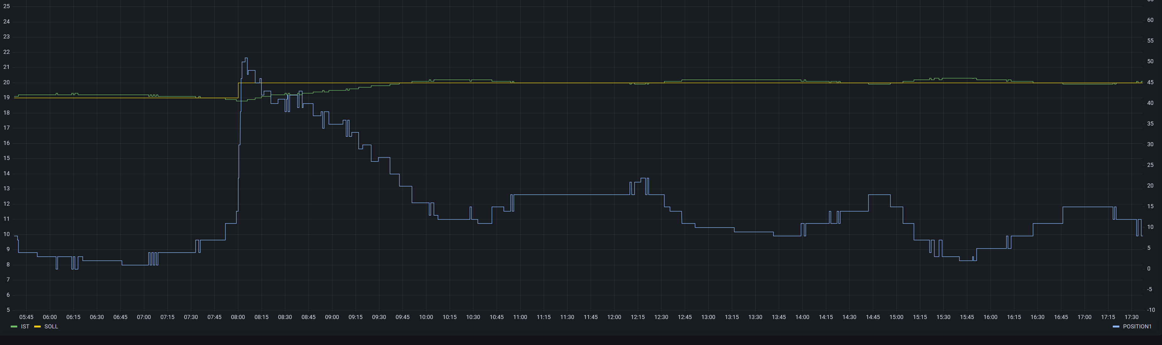

This is how they work for me. But iam using them with custom Kp and Ki parameters.
They just overshoot for 0.2°C and just go 0.1°C below the target.
They are working much better then the W600.

But i think i found out why the aqaras are working so bad.

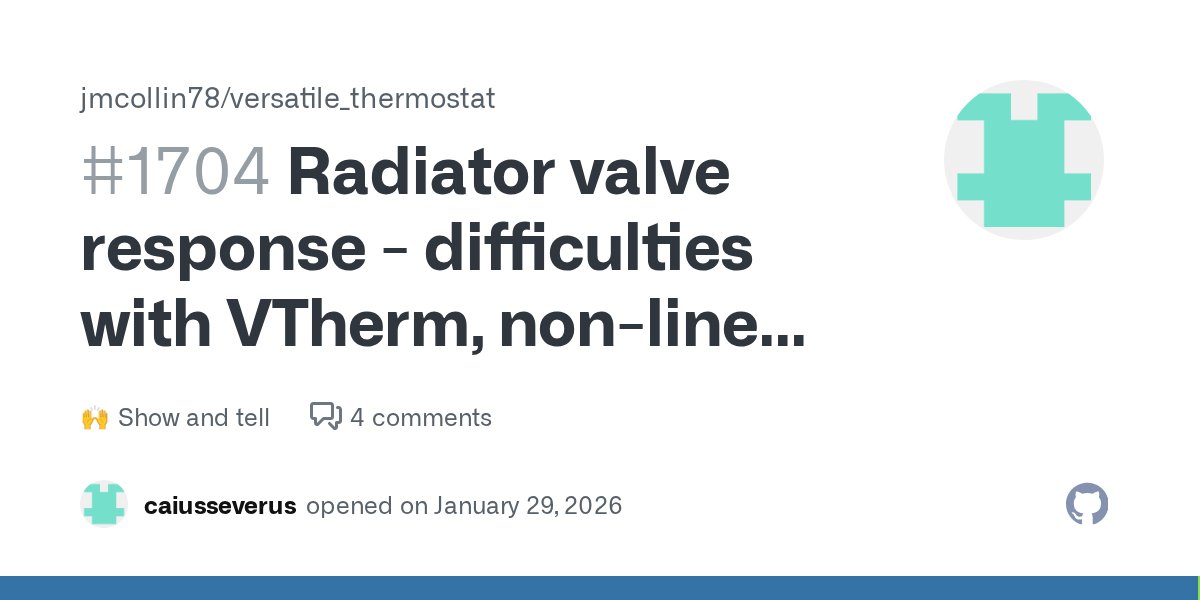

If you read this thread, you will understand why the heating behaivor is this bad.
If you understand, that the full heatingpower only can be controlled from like 5-20% opening, and you watch the aqaras valve positioning, then you can understand.
The “adaptive pid controller” isnt really that adaptive of the w600.
I think it will never be fixed, because chineses wont understand, that full waterflow in radiators mostly flows when the trv is opened only 20-30%.
And water wont flow if its below 10%.
If you read the linked github thread, you will understand it.
Great thread. Ironically, if they just deleted the entire PID controller and went back to on/off it would work better when such non-linear valve dynamics are present.

So, its basically an all-trv-problem. But in reality, the W600 doesnt adjust the opening correctly. The ITherm should increase and the valve should have open little bit more and more or otherwise.
For me, its just a static algorithm how they work.
This thread was gold to understand why the W600 is working so bad.
