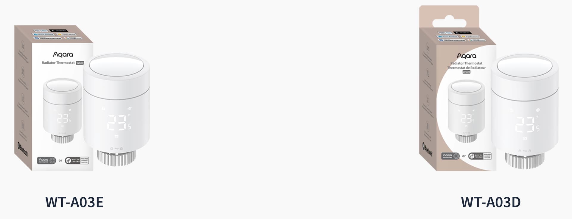

I asked about the improved version and hereby the answer:
Thank you for contacting us. The W600 is our new Smart Radiator Thermostat.
The improved version of the Aqara W600 mainly adds dual-protocol support with both Matter over Thread and Zigbee, giving you more flexibility depending on your setup.
It also offers broader radiator valve compatibility, improved scheduling options, quieter operation, and better integration with external temperature sensors for more accurate room control.
ok, so the impoved versions equals the normal version. everything that is listed, applies also to the normal version. so there is actually no impoved version.
There is a difference in the led icons - they changed every icon. I def prefere the new one.
So, did they even changed the fw and made improvements? Any news here?
The second version (WT-A03D) is not new.
It is in place since the release and has been even mentioned in the manual since then.
Please see here for an official statement:
I could assume those are just different versions for different markets/regions.
