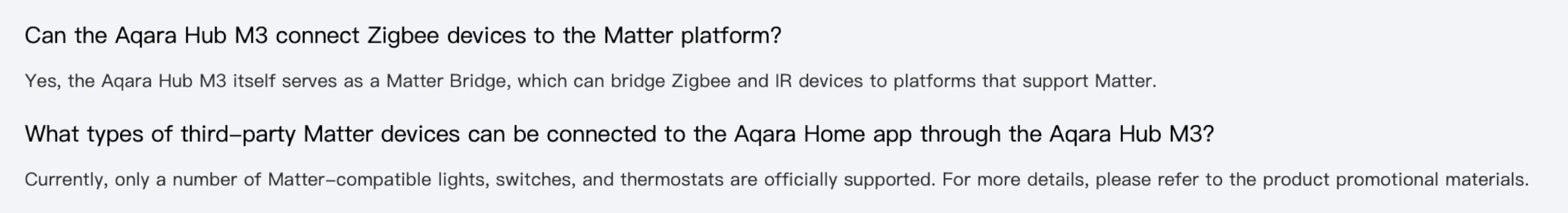

I looked around at the settings of my M3 hub in the Aqara Home app. I couldn’t find the answer. In the FAQ section this was the closest I could find:
