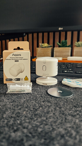

I received my FP300 and unpacked and started using it the same day.

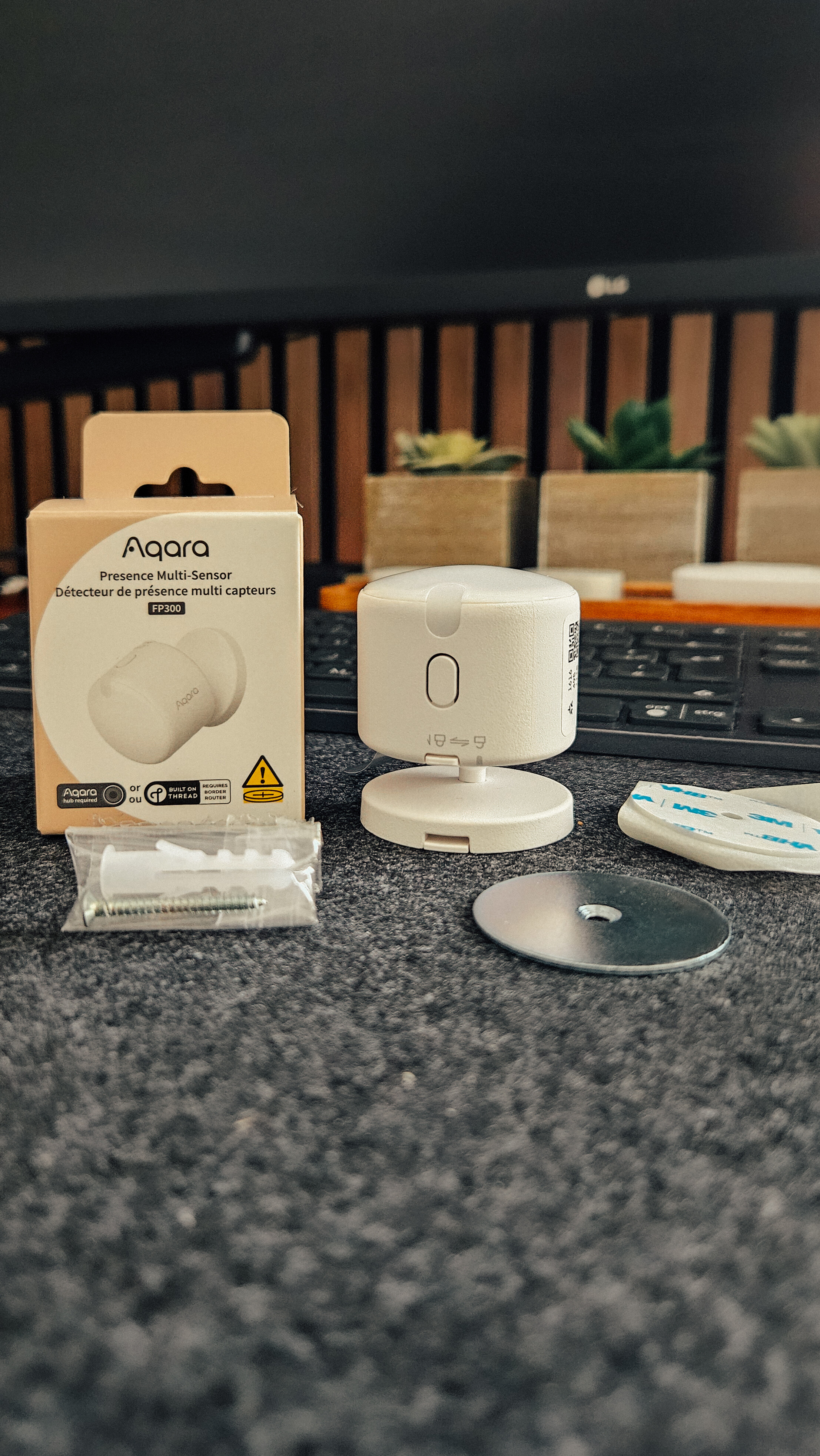

First of all, the size: the device is really small compared to the FP2. The feel is excellent, typical of Aqara, and the package includes the device and the user manual, as well as a small metal plate with mounting hardware. The Matter Code is printed on both the user manual and the device itself.

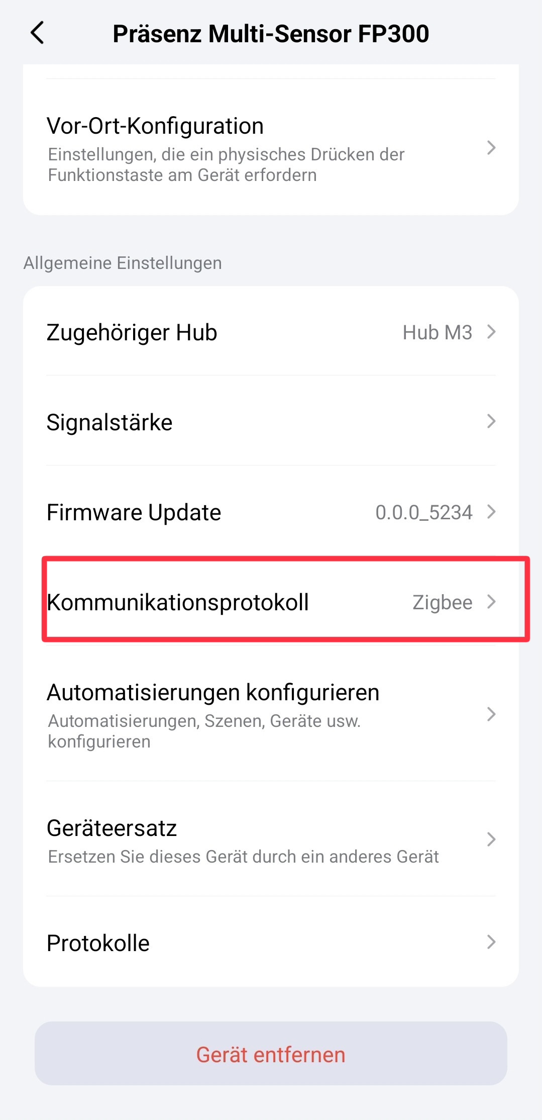

The device is in Thread mode by default and can be integrated into the known ecosystems via Matter.
However, if you integrate the device via Matter, you miss out on some really great and useful features, which I’ll discuss later.

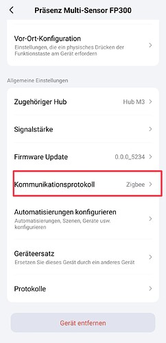

Since I was aware of this and personally prefer Zigbee, it was clear from the start that I would switch protocols and go directly to Zigbee.
I had no problems switching protocols

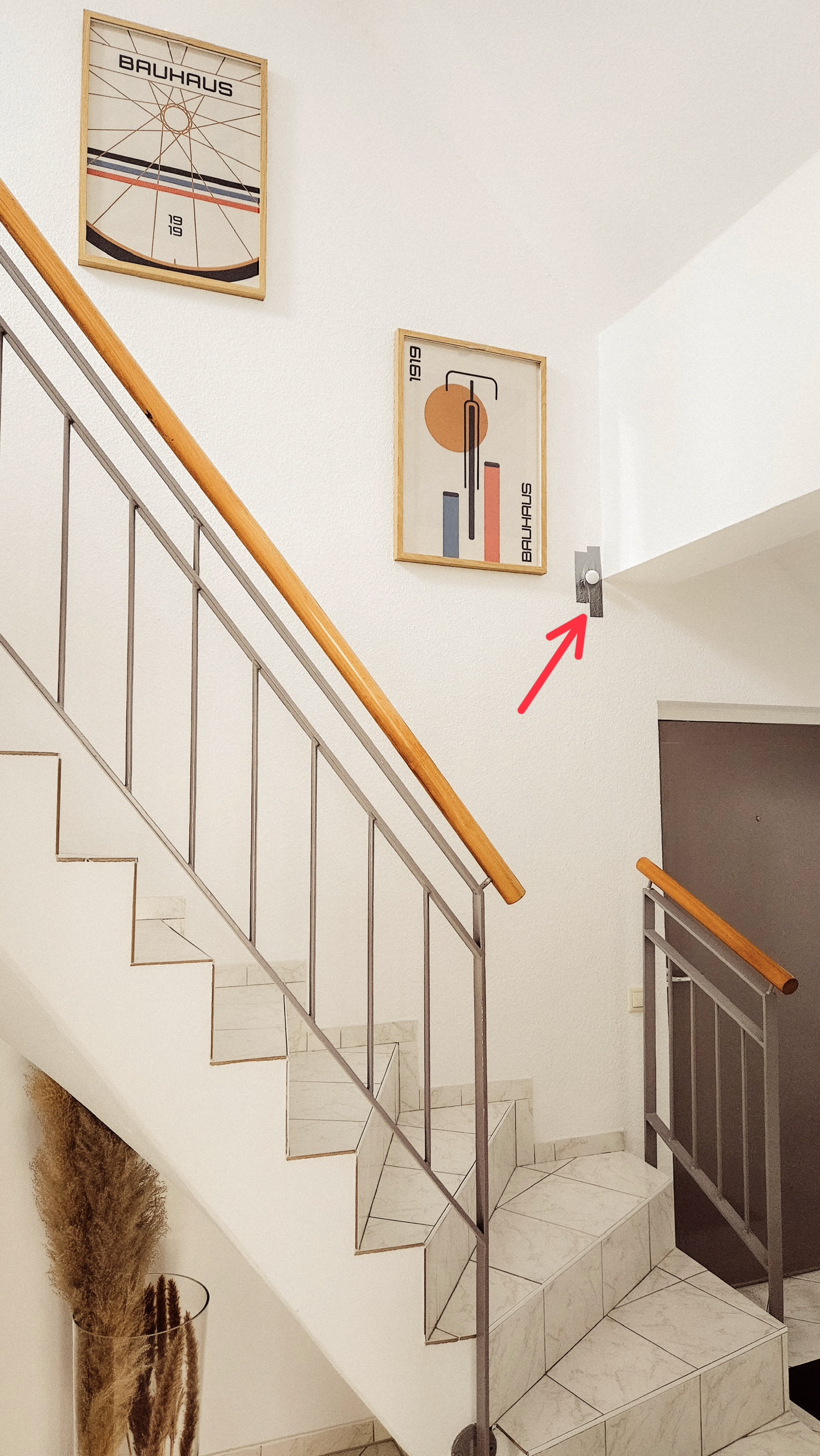

After programming, a suitable spot in the hallway had to be found, which, as with the FP2, was a bit of a challenge. I strongly recommend testing the device over several days and at different times before finally installing it.

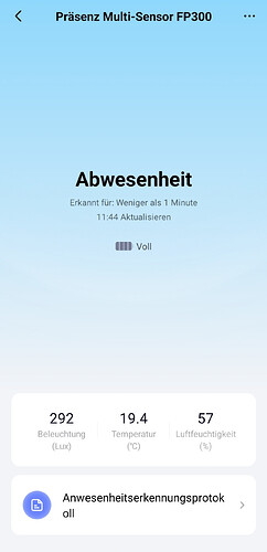

  • Light intensity sensor
  • Temperature sensor
  • Humidity sensor

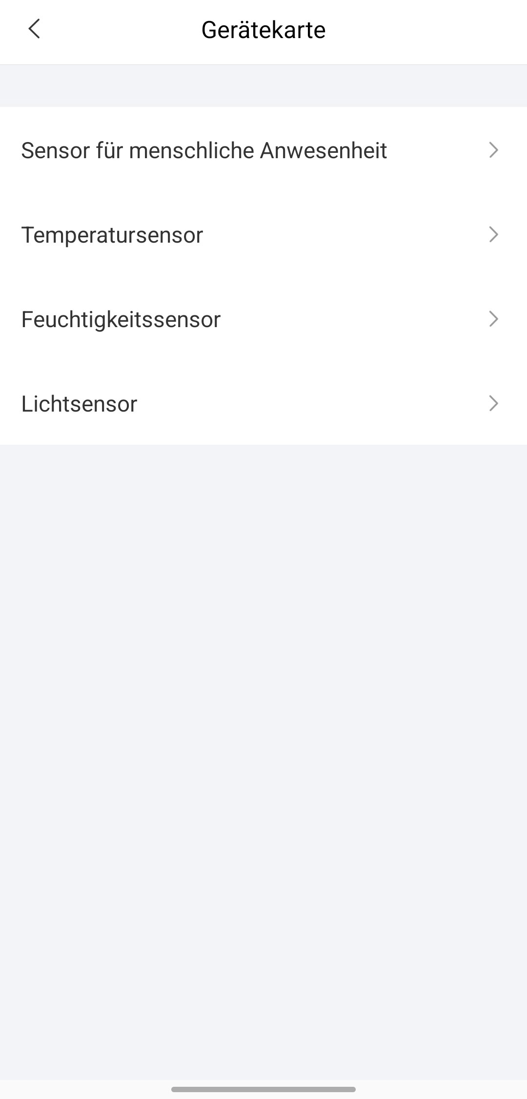

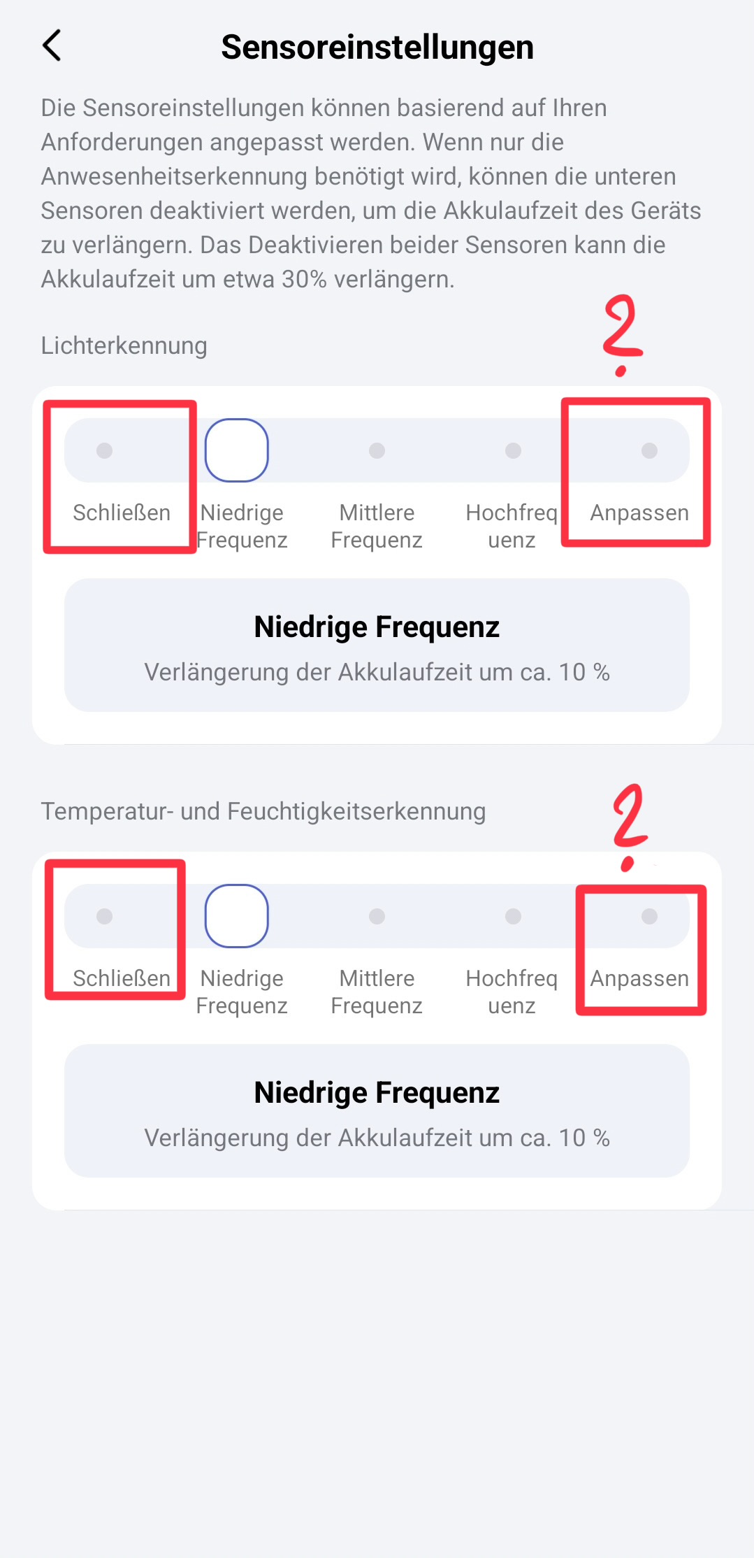

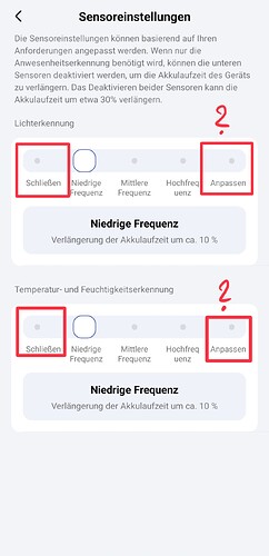

The light intensity, temperature, and humidity sensors can be configured or disabled! This is, of course, a really great feature, as you can extend the battery life by disabling, for example, temperature and humidity!
I noticed a few translation errors here. The word “Schließen” should be “Aus.”
I haven’t figured out exactly what the term “adjust (german Anpassen” means yet. Perhaps Aqara can give us a clue.

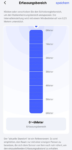

The range can also be adjusted in Zigbee mode:
However, I should mention at this point that the range doesn’t seem to reach that of an FP2. Furthermore, I’ve found that the height at which the sensor is mounted influences the range. The sensor responds best to head and/or upper body height.

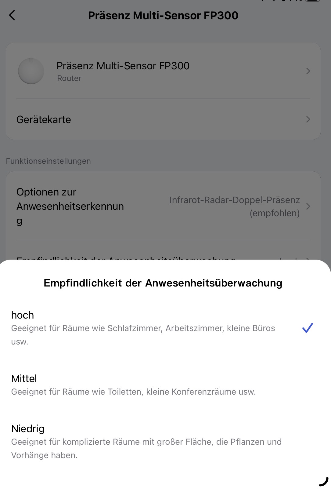

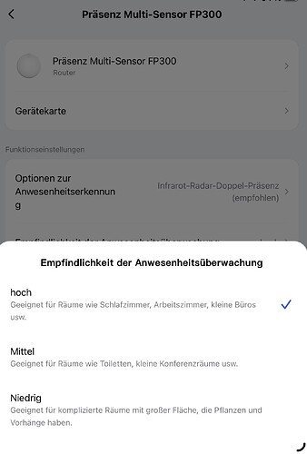

The sensitivity of the presence detection is also adjustable:

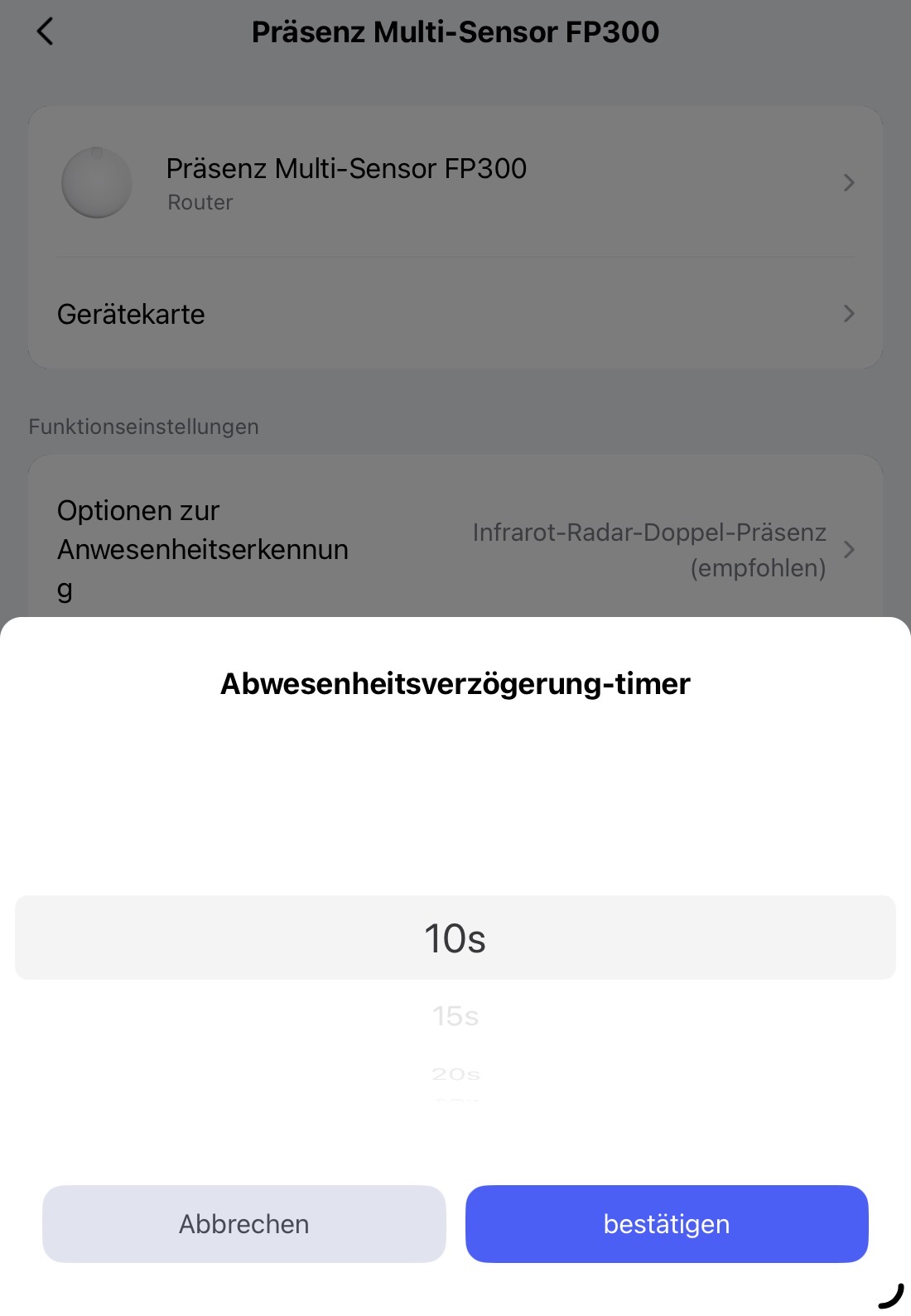

You can also adjust the switch-off delay from 10 seconds to 5 minutes. This will later affect any automations that are supposed to turn off the lights, for example. This is where you set the delay.
My hallway has a lot of corners and edges, which can be distracting. Unfortunately, the first attempt shown in the following picture didn’t produce the desired results because the walls and the sensor’s range interfered.

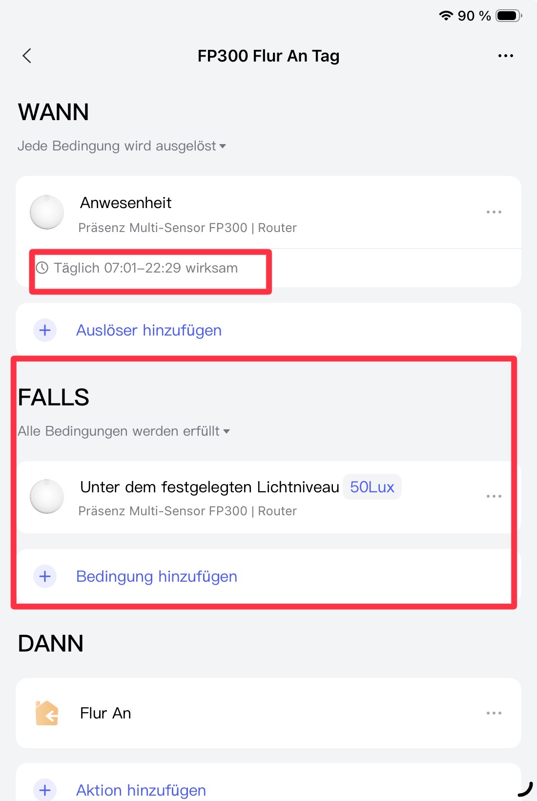

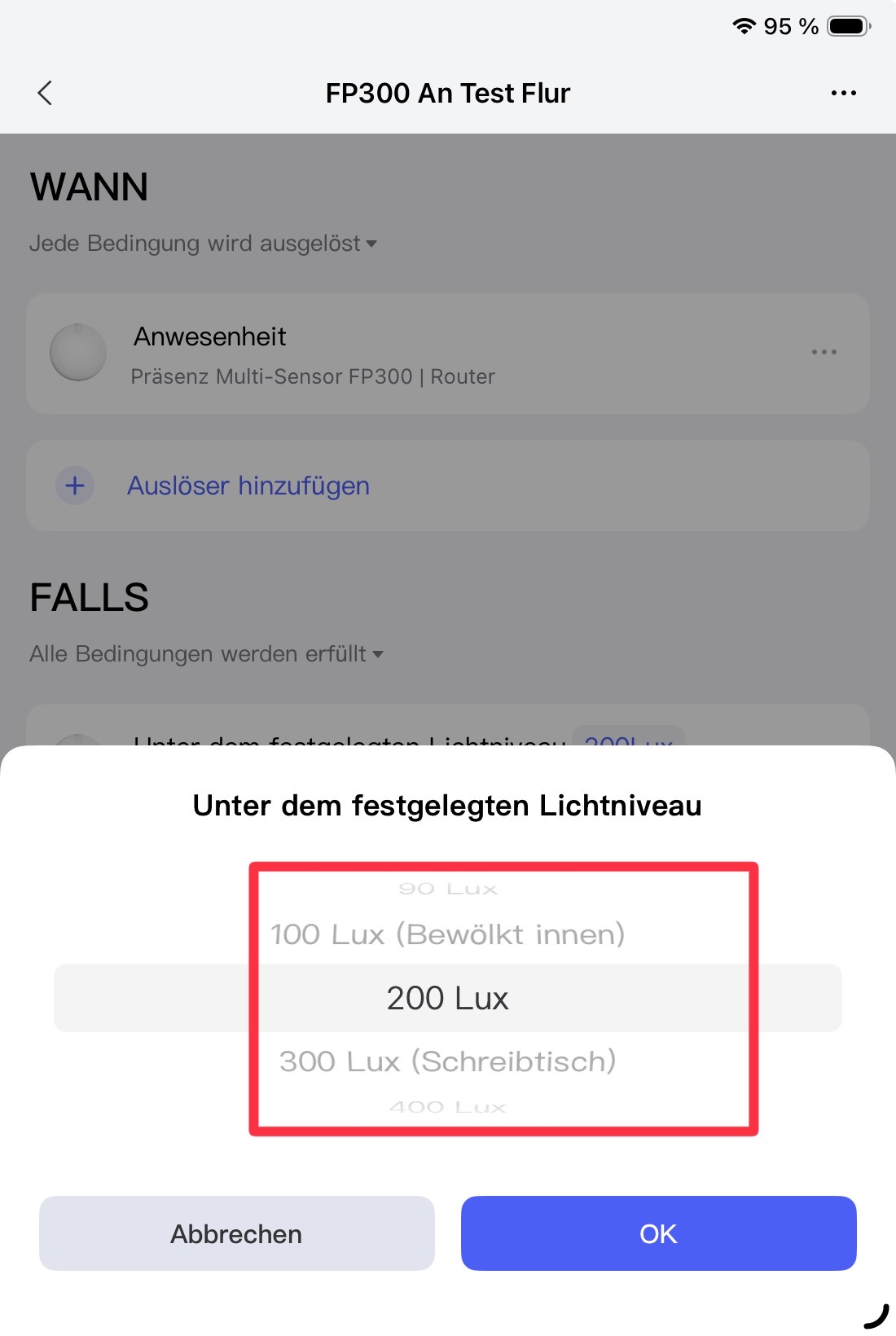

To test the sensor, I created corresponding automations in the Aqara app and was able to directly test the new Automations 2.0 function with its conditions.
First, I created three scenes:
  • Hallway On Day
  • Hallway On Night
  • Hallway Off
Then, three automations:
Hallway on Day (occupancy, 7:01 AM - 10:29 PM, below 100 lux)
Hallway at Night (occupancy, 10:30 PM - 7:00 PM)
Hallway Off (no occupancy)

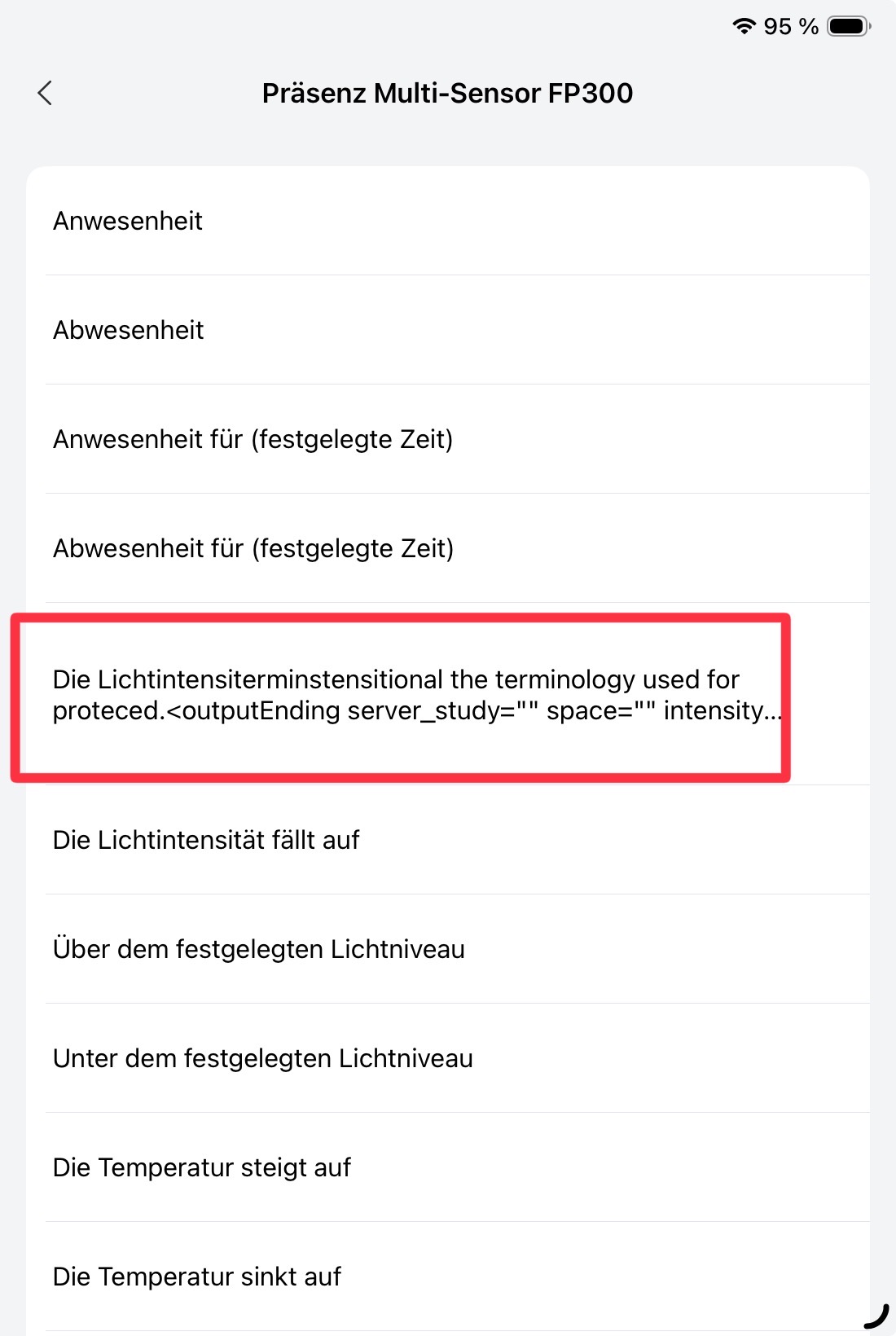

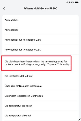

When creating the automations, I noticed the following errors:
Maybe @AqaraOfficial can fix this with an Software update.
There’s a small quirk with the sensor’s lux value if you want to use it in your automations within the Aqara app.
The lux levels aren’t selectable down to the exact lux level, as you might be used to from other systems, but rather in the following increments:
1-10 lux (individually)
10-100 lux (increments of 10)
200-1000 (increments of 100)
2000-10000 (increments of 1000)
20000-80000 (increments of 10000)

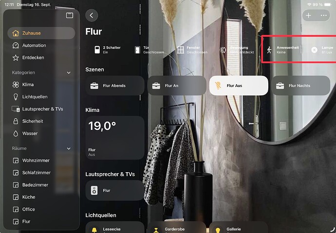

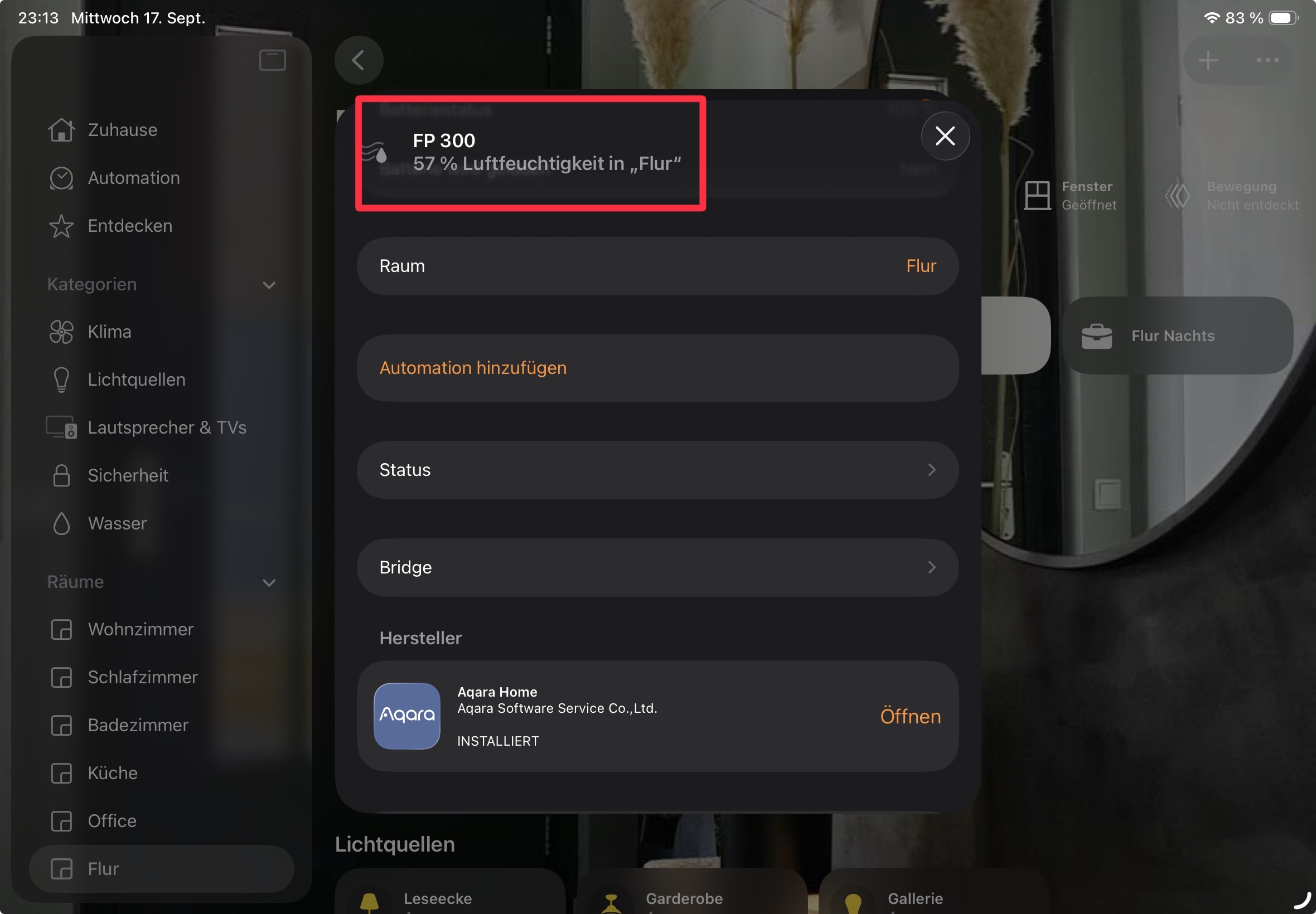

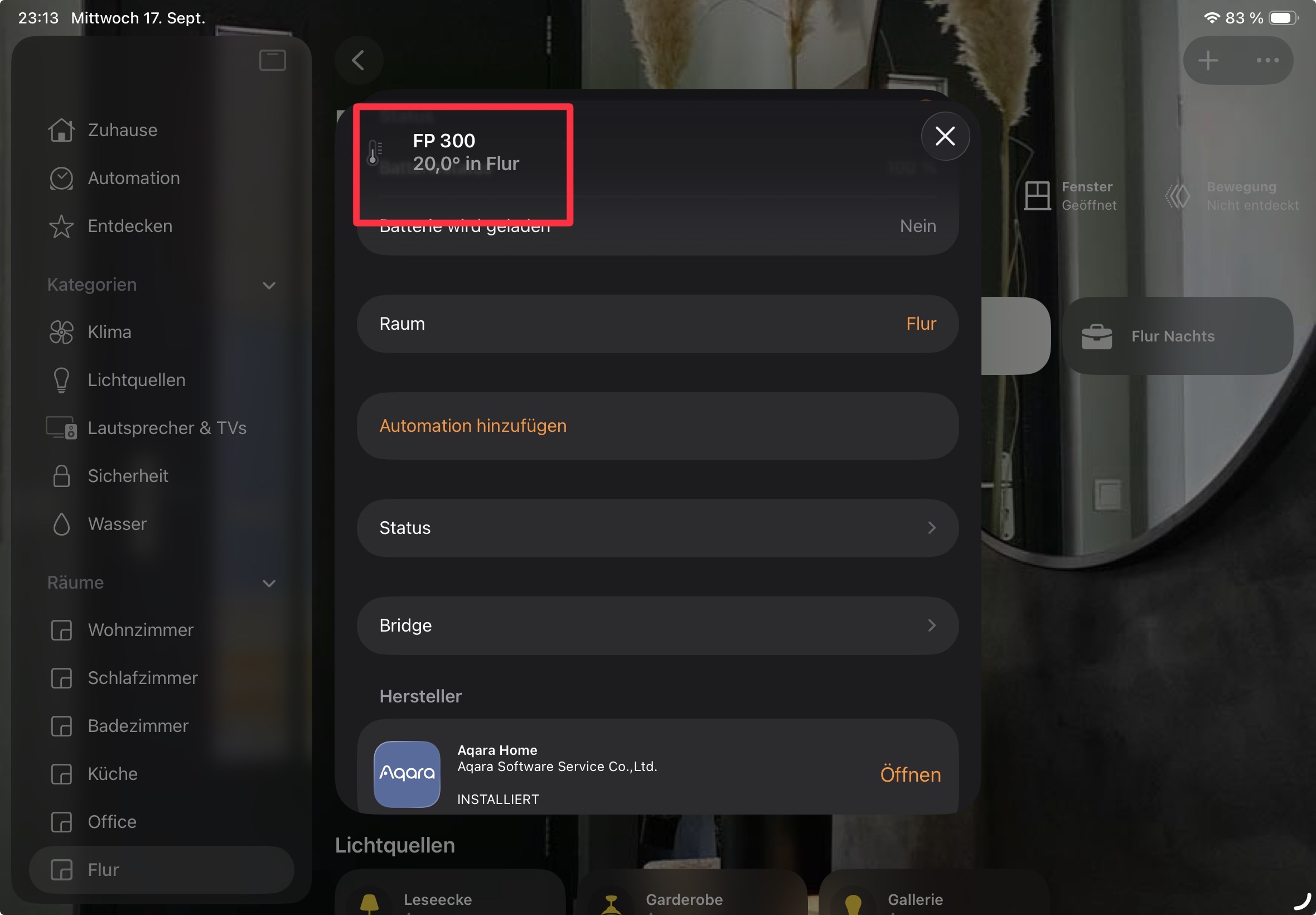

About HomeKit:
All sensors such as presence, brightness, temperature, and humidity are exported here and can be used for automation:

What a great sharing! Thank you for letting everyone see the real FP300!
This in English will be “Custom”
Not quite sure how to say it in German. Maybe you could give me some suggestions!
Thank you :v: Just testing :face_with_hand_over_mouth::wink:
I ment that i do not know what this feature does. The Translation is ok :wink:
custom means you could set the specific report frequency and so on
Hi @MakerMing for custom the right translation is benutzerdefiniert
But when it will be too long I would use custom there too . I´m sure 99% of the Germans will unterstand that as well
Thank you for this sharing. I now understand why I don’t get any configuration informations: I will not have with Thread / Matter integration.
I have to setup the device in the Aqara app to do so. I wonder if it is possible to add it into the Aqara App without Hub ?
If someone has the answer.
My sharing is there with different requirement: HA with Thread USB key (Sonoff z-dongle), OTBR and matter integration.
You can integrate the sensor into your desired ecosystem via the Thread wireless protocol using Matter.
However, if you don’t have an Aqara hub that supports Thread or Matter, you’ll need to connect the sensor DIRECTLY to, for example, a HomePod Mini.
Then you’ll only have the sensor in HomeKit and probably won’t be able to configure any of the things I mentioned above.
To configure the settings, you’ll need at least a Thread-enabled Aqara hub.
That’s my current understanding. If there’s anything wrong here, please correct me!

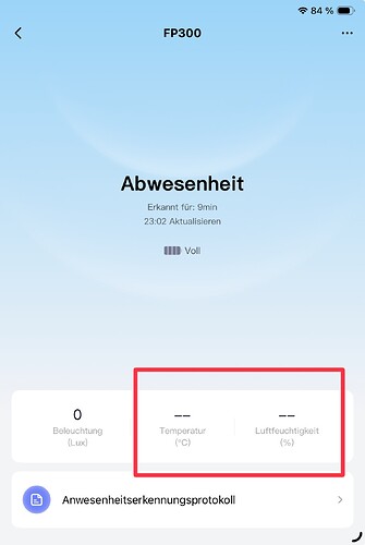

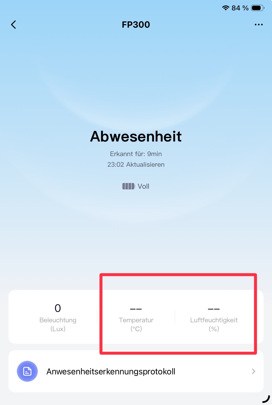

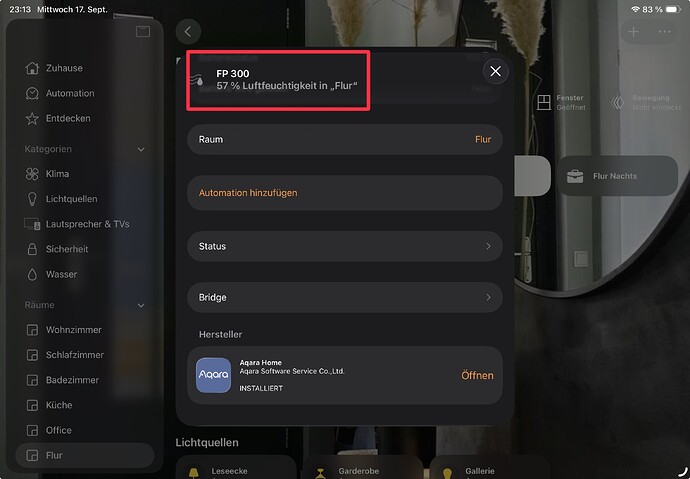

I deactivated the humidity and temperature sensors in the Aqara app for testing purposes.
Strangely, the values ​​are still displayed in Apple Home.
They are deactivated in the Aqara app. Is this a bug that needs to be fixed @AqaraOfficial ?
I use the sensor in Zigbee mode. Perhaps you could pass this on to your development team @Caroline_Zzz

How @DEChrisE said “benutzerdefiniert” would be the correct translation for “custom”. Since it’s a long word i also think “individuell” (custom/individual/personalized") or “manuell” (manual) would fit there. “Individuell” would be the best in my opinion
