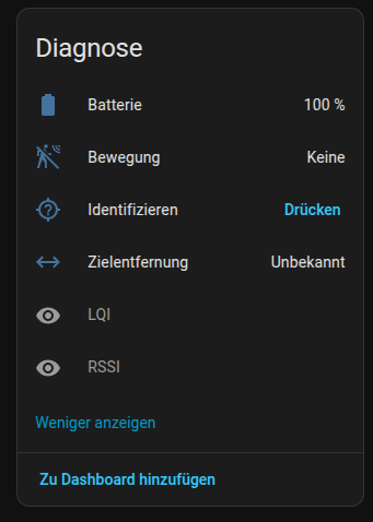

Thanks so much for your work on this. I recently got an FP300 and have set it up with ZHA and the custom quirks. I can see presence detection for occupancy in HA, but don’t see a seperate PIR sensor for Motion. Am I missing something or is that how it’s meant to work?
Hi! This question came up in the related PR as well (see here):
By default, the FP300 uses both sensors (PIR + mmWave) together to provide the Occupancy/Presence entity in Home Assistant. The separate PIR entity isn’t exposed like a “classic” PIR motion sensor, because the FP300’s PIR behaves differently (for example, it may be disabled after occupancy is detected). So it’s not enabled by default and is mainly intended for diagnostics:
That said, if you want it, you can enable the PIR reporting and then use it in automations.
