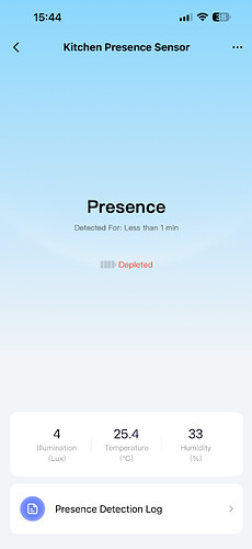

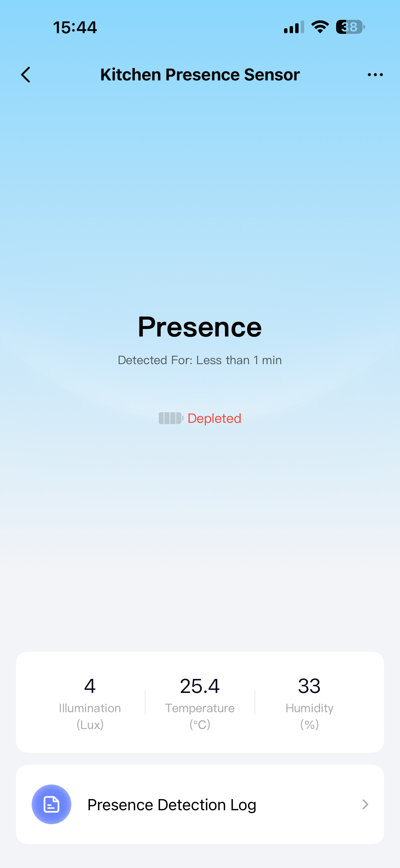

so, after 3 days, my FP300 is reporting empty battery state in Aqara app AND Home Assistant.
Rebooting it and the hub didn’t help.

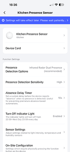

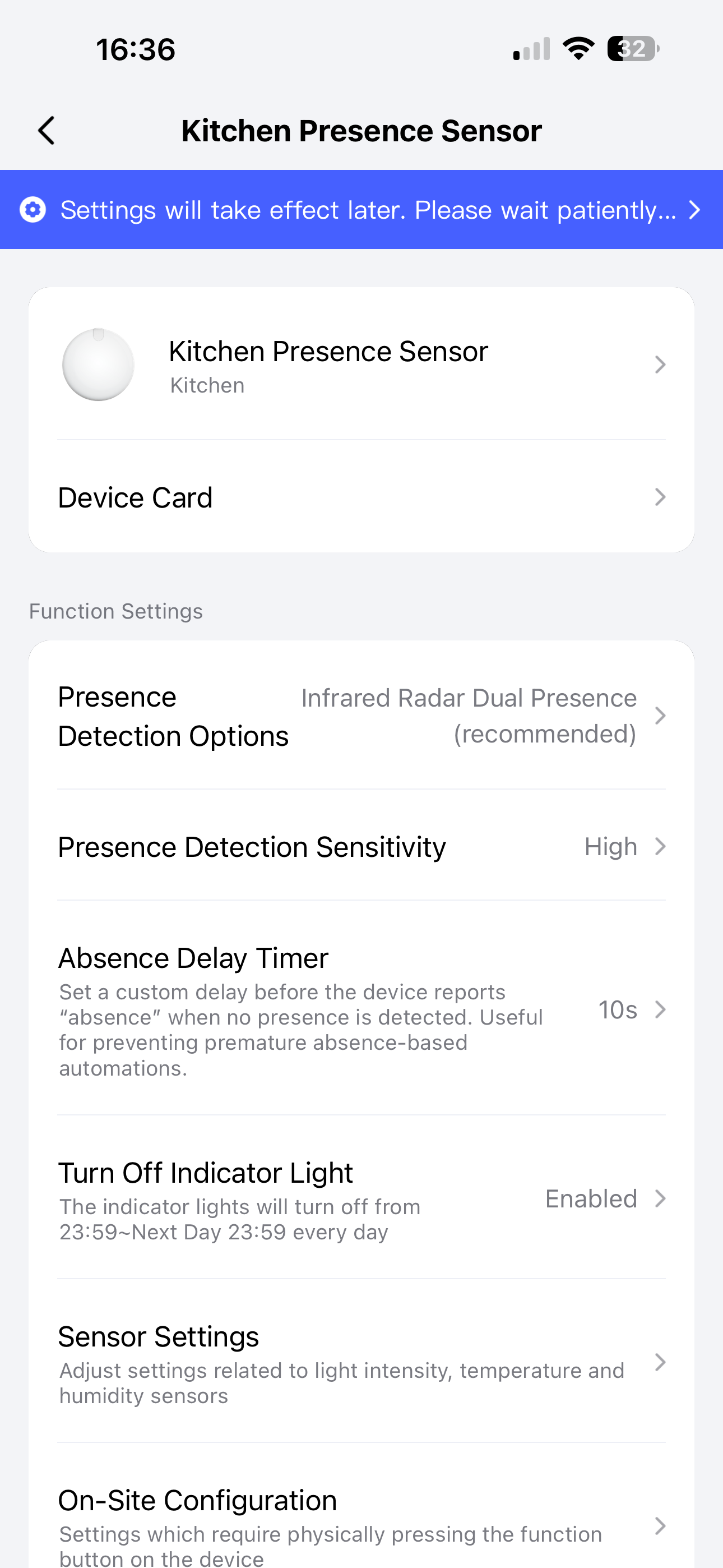

The constantly is reminding you that configuration not synchronized. You can click the sensor button or wait 1 hour to sync your configuration.
I have clicked the button multiple times and each time it cane back.
Is this legit? ![]()
Did you see the led indcator when you clcik the button?
If you clcik the button(just clcik one time). The led will flash and the configuration will be synchronized. And the hub will say device is connected. If the tip continuously displayed at the top isn’t normal.
Yes the LED did flash and the configuration was set. After a while the same message appeared.

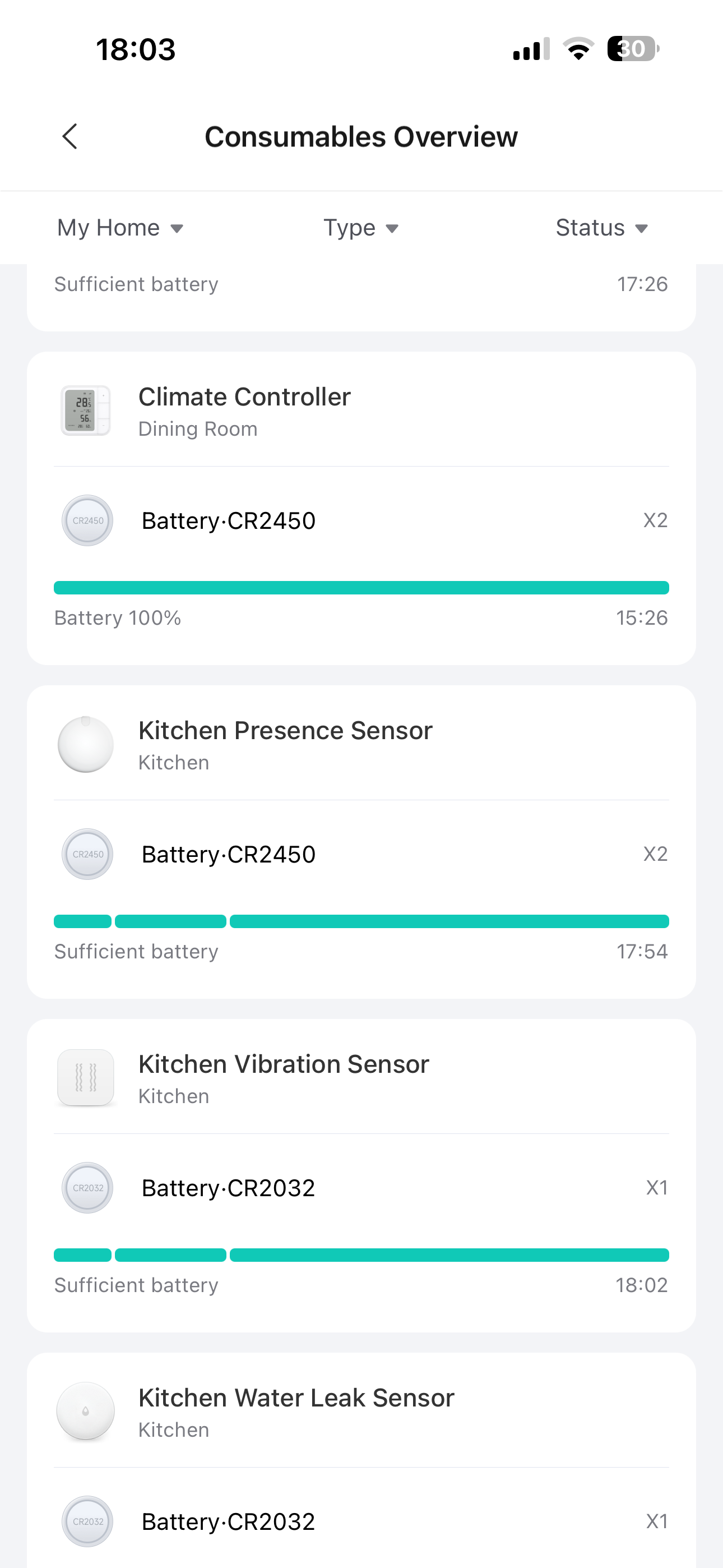

Today the battery is showing as Full.
Exactly same thing happened to me. I also had to change batteries already after a week or so. The blue line on top goes away after you press the button on the FP300 once and the hub confirm the connection. I suspect that the two things can be related so when it’s in that mode it drains the battery ![]()
Weirdly, it shows that the batteries are full today…
