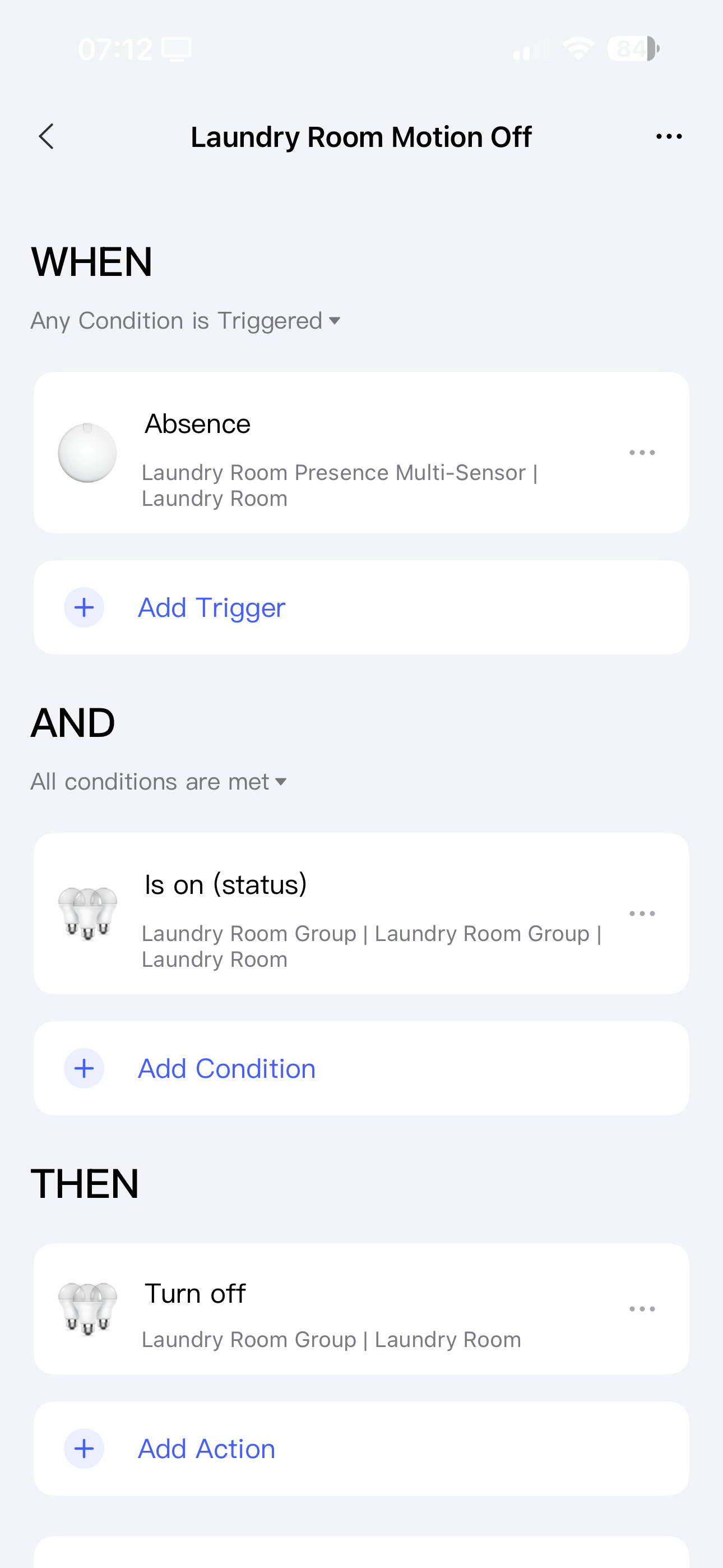

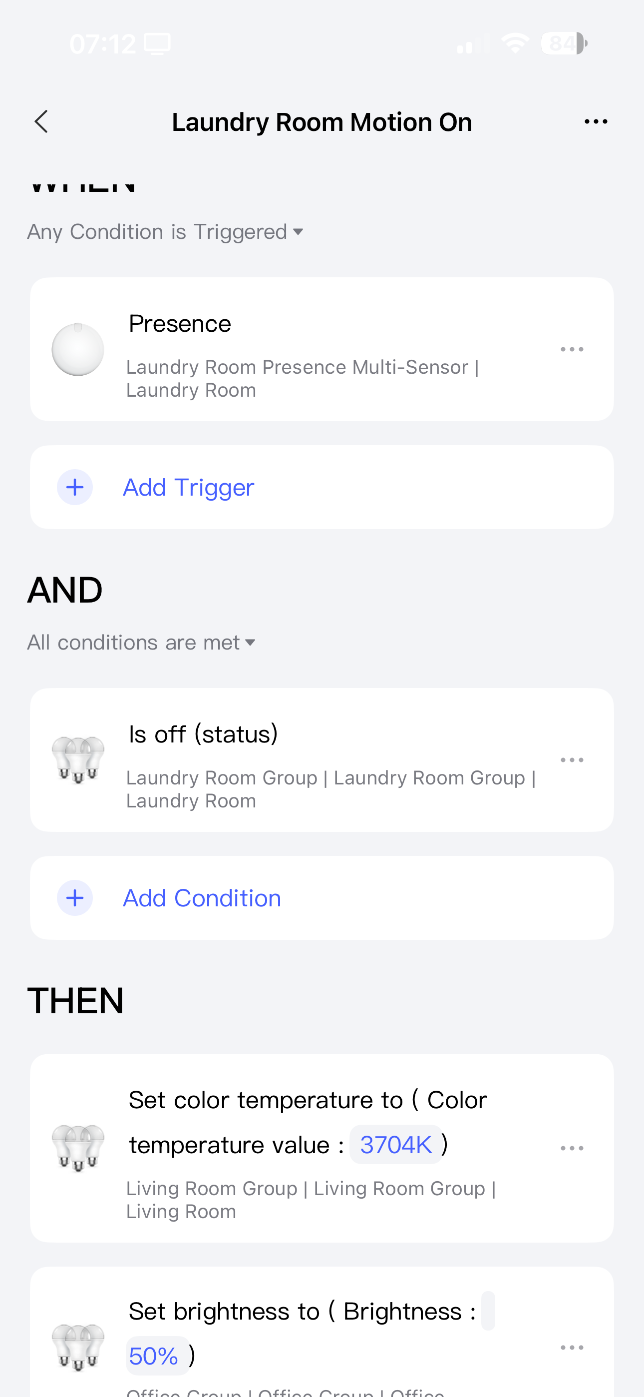

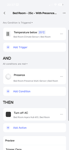

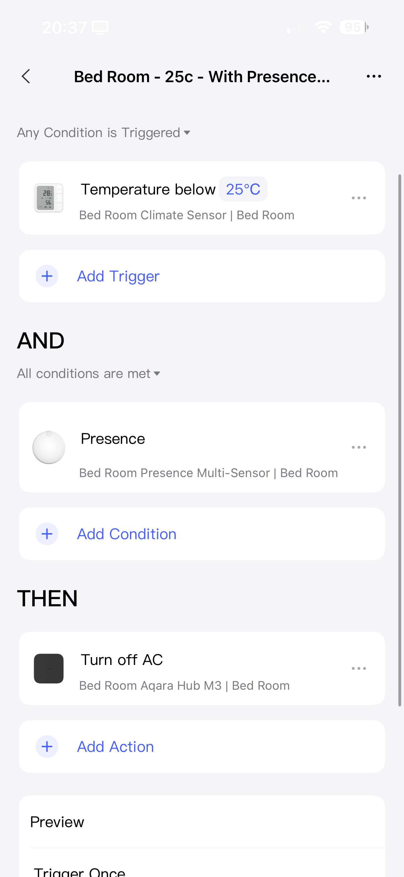

Show automation.
Just in case, check if your automations are CLOUD. Just to check.
All Local

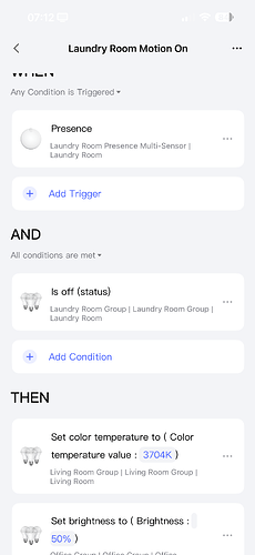

Looking at this again…90% of them are Local…the other are Edge…Im assuming its because of Grouped lamps vs single lamps respective correct?
I suspect that grouped, may be hidden cloud. I haven’t checked this.
This has recently appeared in the IF condition.

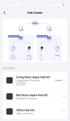

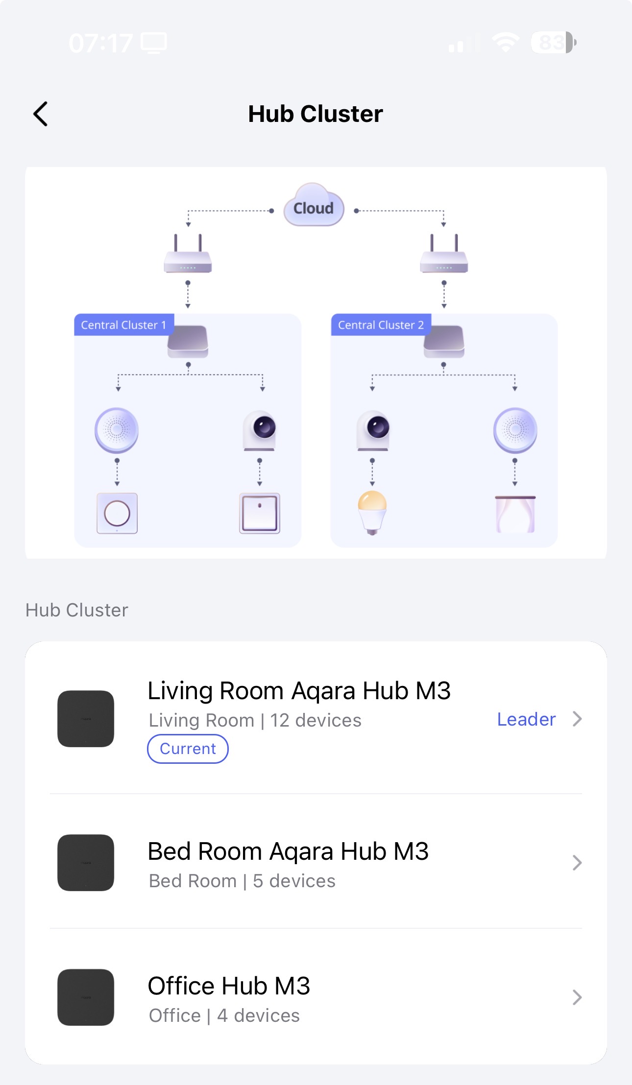

Perhaps your devices are on different M3 gateways and are connected to each other by a local network based on a router. In this case, there will be a peripheral.
So should i be using individual lights instead of groups?
ohh and BTW…The M3 are hardwired into an ASUS AIMesh Nework…and those routers are hardwired also…
3 ASUS Routers in an AIMesh…and Each M3 is Hardwired to each Asus Router…all Aqara Devices are Zigbee, and Philips hue lights mattered into Aquar and the light have zigbee logos on the Accessories page
I would try using the state of one lamp from the group as a condition in IF. Automation 2.0, lesson 8, using group lamp control using scene's

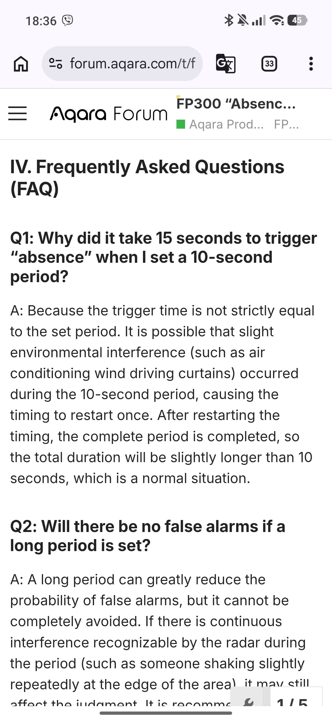

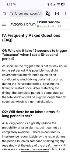

Read more here, the operation of the air conditioner is mentioned. FP300 "Absence Delay Timer" /"Absence Confirmation Period" Function Description and FAQs
After analyzing this description, I believe that using the FP300 to control an air conditioner may be problematic.
