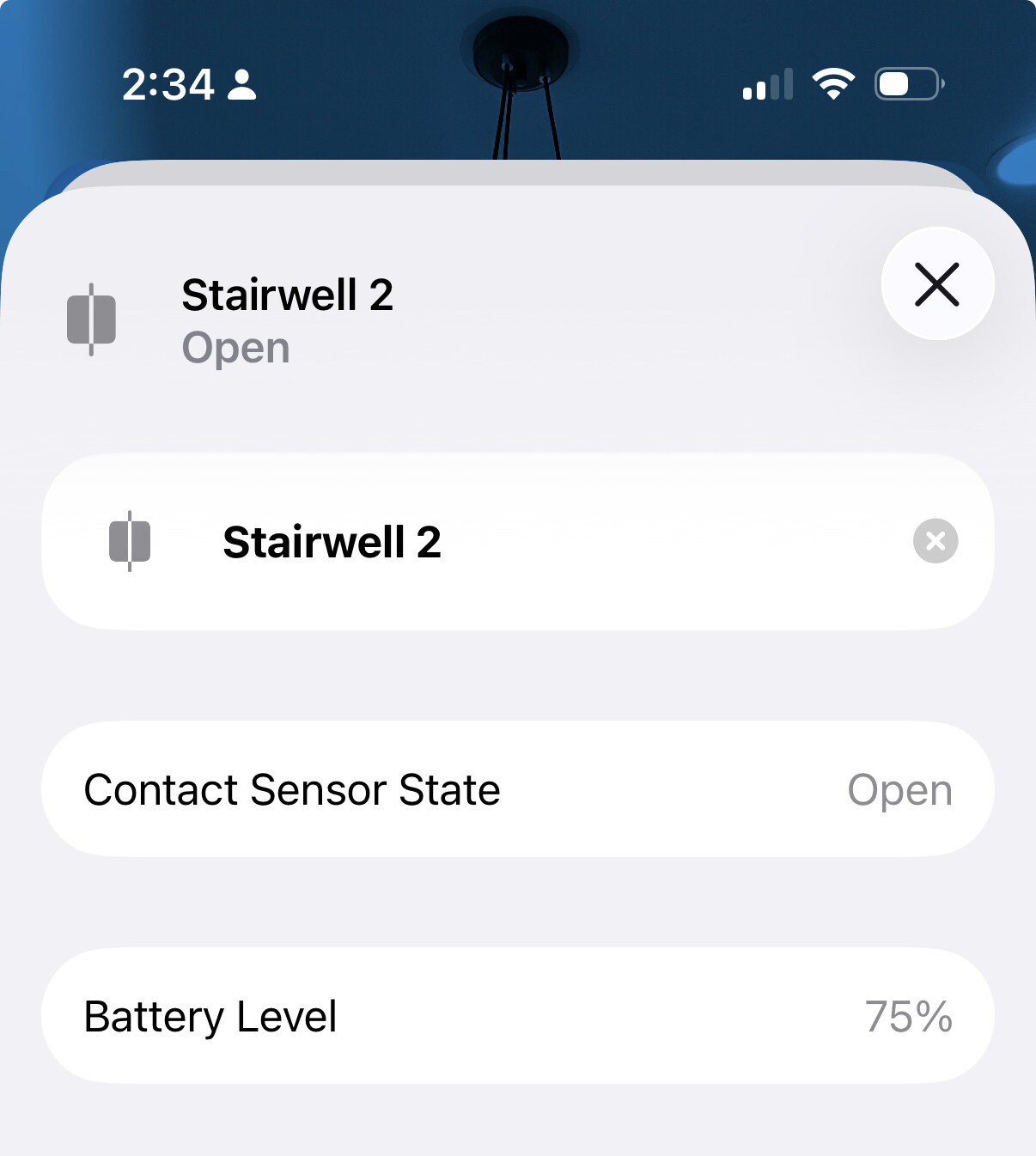

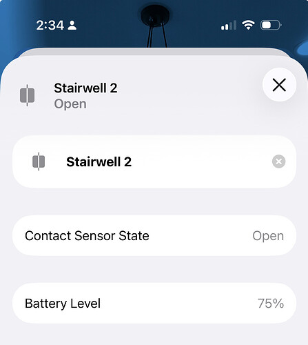

If I select the room with the P2 and then press and hold the sensor’s lux value at the top for a few seconds, a window pops up showing the current battery level.
Or is that not what you meant?
Edit: Did you mean the P2 motion and light sensor or the contact sensor?
I think it’s the P2 door sensor
didn’t know there were other P2’s. Edited for clarity. Thanks.

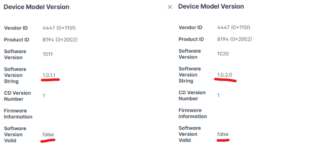

I’ve just checked the DCL and found that versions 1.0.1.1 and 1.0.2.0 have been recalled. coletti.robert probably received an update to a newer version earlier.
The same goes for version 1.0.3.0 of the P2 Motion Sensor, which has also been recalled. I don’t know the reason, but you can apparently contact support to ask if the update will be released for your account.
The recalled firmware updates for both devices apparently also include the upgrade from Matter 1.0 to 1.4.

In the DCL, it doesn’t start until version 1.0.0.0. And this software version is valid. I would have assumed that this is the software it came with, since no OTA URL has been provided. That’s probably also the reason why it’s not available as Matter firmware via OTA for you.
