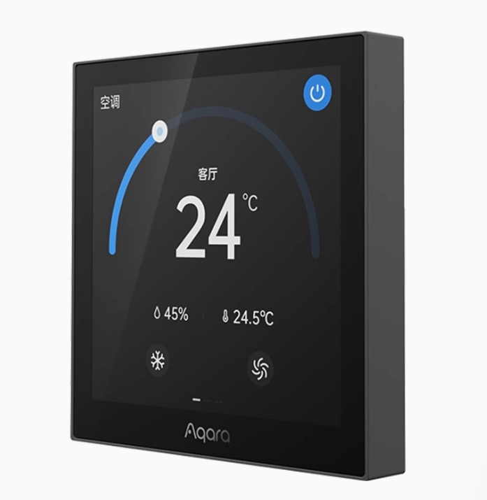

Out of curiosity I also ordered a W400 thermostat from China, since it can control not only heating but also air conditioning. The W400 is a much more complex device with lots of connection options. When you start it, you can even select the type of AC unit to control. I haven’t finished connecting and testing it yet, because the documentation is really basic and I don’t have all the knowledge myself. But here in Austria our summer break is ending soon, and once my electricians and HVAC specialists are back on site, I’ll dive deeper into the W400.
