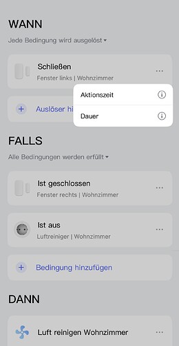

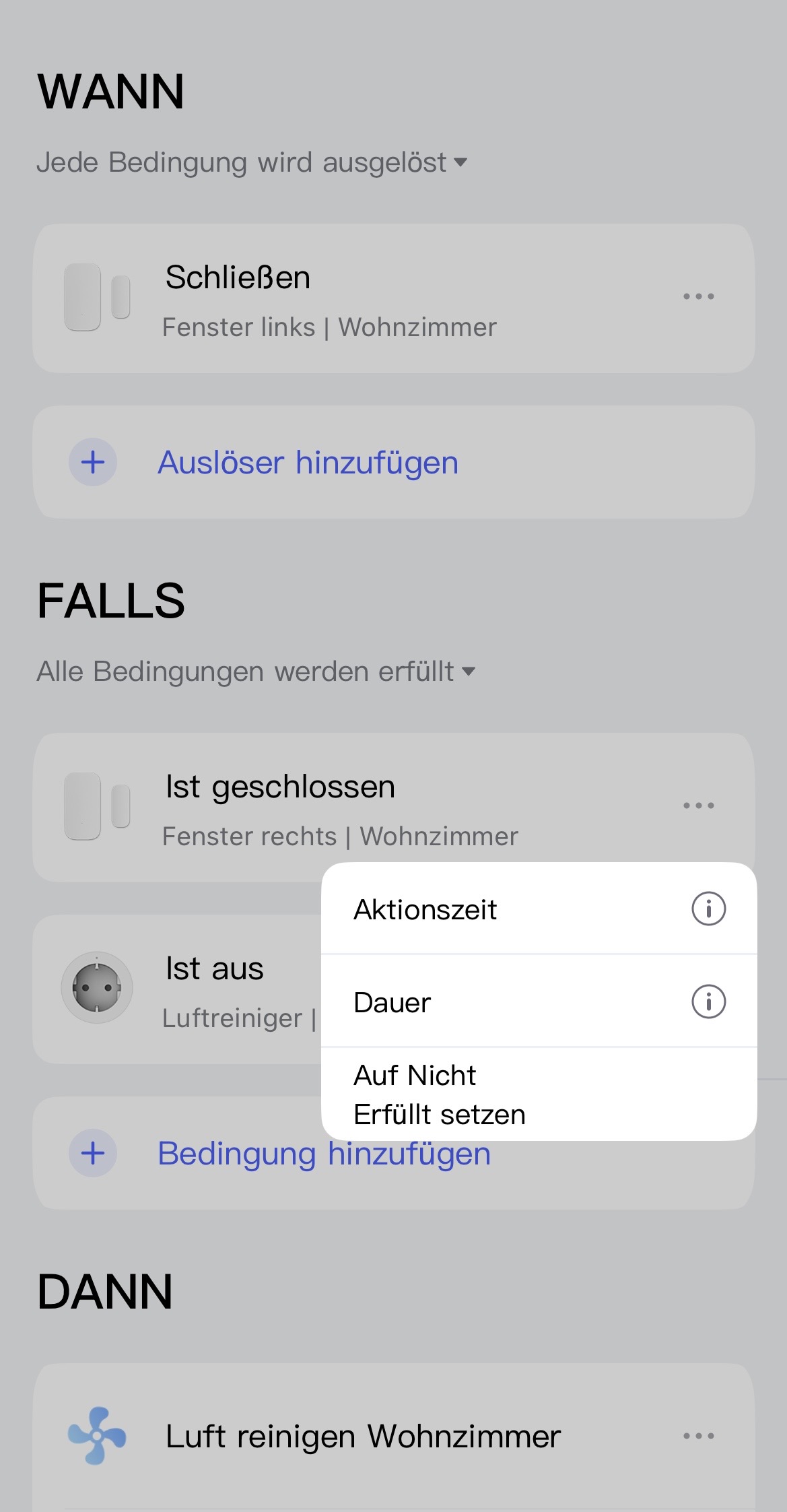

If you have a condition in the IF block, then you press the three dots and you can set a time period there!
The three dots → acting time is in the THEN block, which isn’t what I want - I want a single ‘time range’ restriction in the IF block before the multiple THEN options.

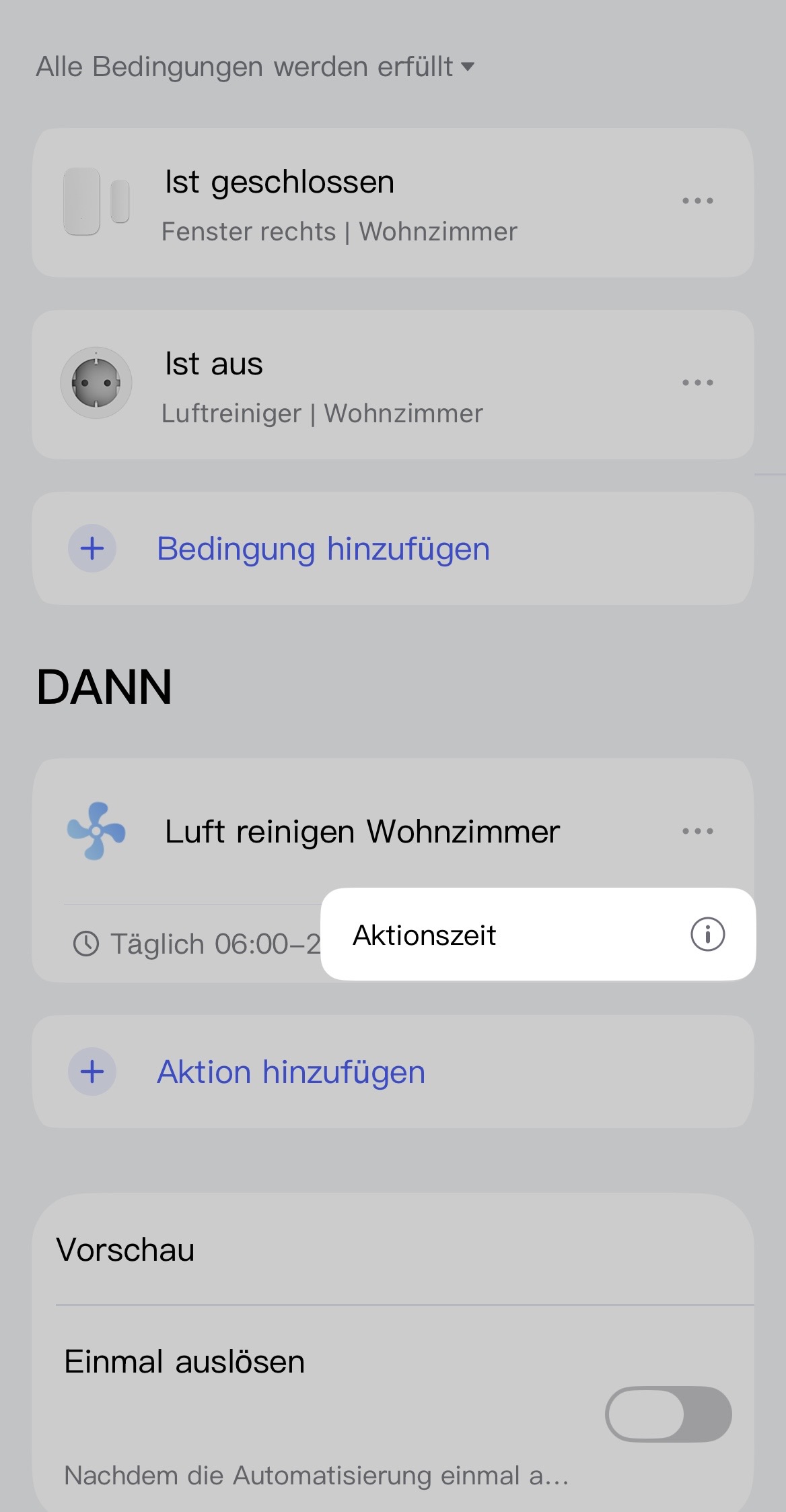

Sorry, but I can do it in the IF, WHEN and THEN block.
And if all conditions must be met, then it is enough to set the time period for only one condition. So it is a single ‘time range’ restriction.
If any conditions can be met, then a time period would have to be set for all conditions.

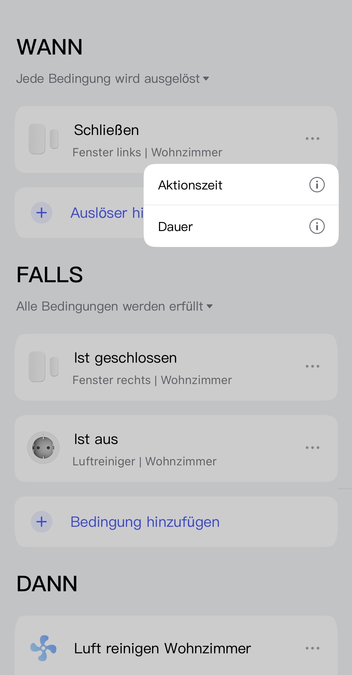

Here are the screenshots in German as evidence:
  • “time range” in German it’s “Aktionszeit”
  • “IF” in German it’s “FALLS”
  • “WHEN” in German it’s “WANN”
  • “THEN ” in German it’s “DANN”
I’m not adding an acting time to a condition in the IF block, the IF block is empty. The when block is the trigger and the THEN conditions contains multiple downstream actions.
I’m also not interested in duplicating the WHEN trigger into the IF block for the sole purpose of adding acting time. This reminds me of the stupid dance required to recreate IF (all conditions) from V1.
It’s much cleaner to have as a stand alone IF (between time) gate in the IF block.

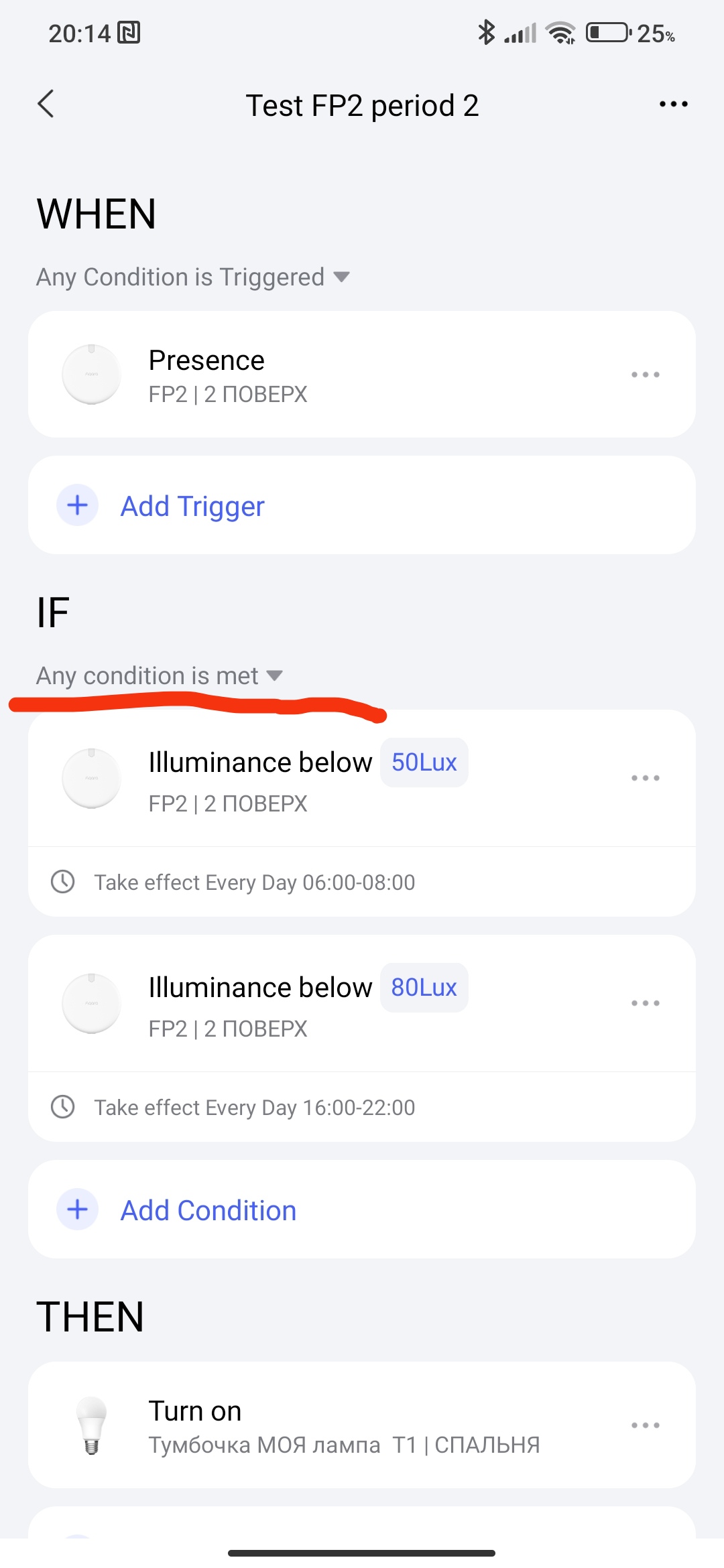

Guys, are you talking about this kind of automation? In IF, select “any” and set as many periods as you want.
nzjrs is talking about a “time-from-to” condition that can be added directly to the IF statement without any other condition.
And yes, that’s exactly the kind of automation I’m referring to.
