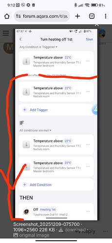

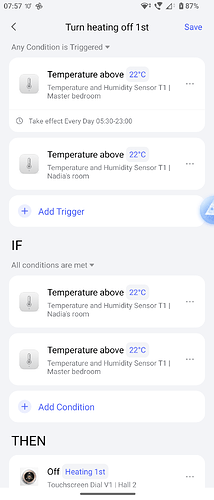

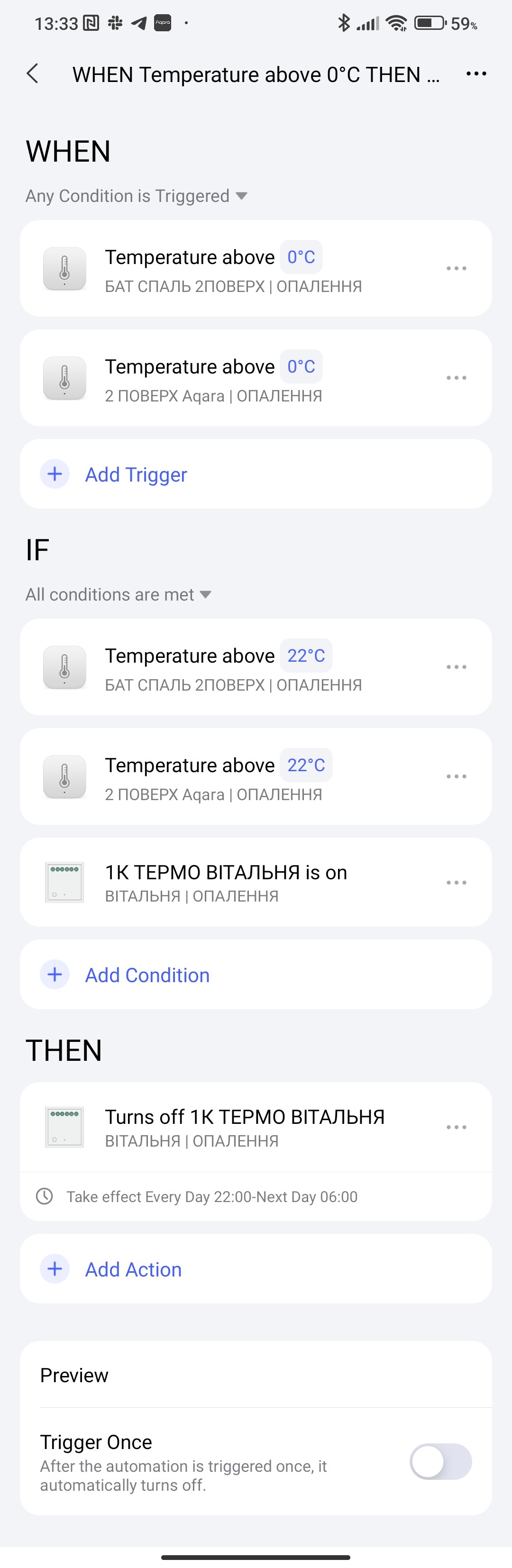

Here is my automation:

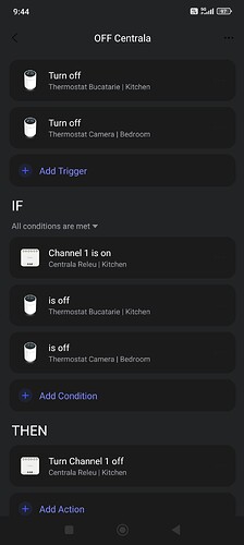

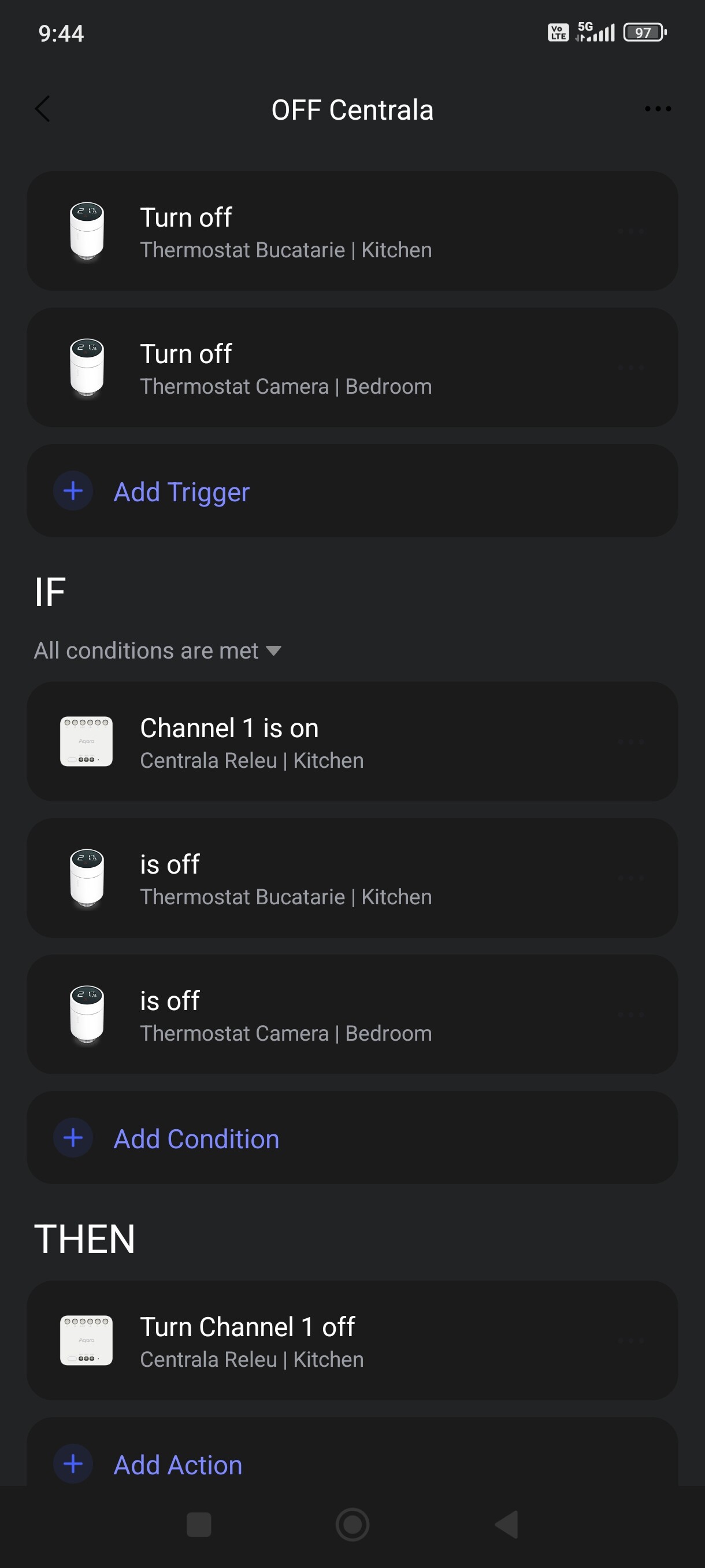

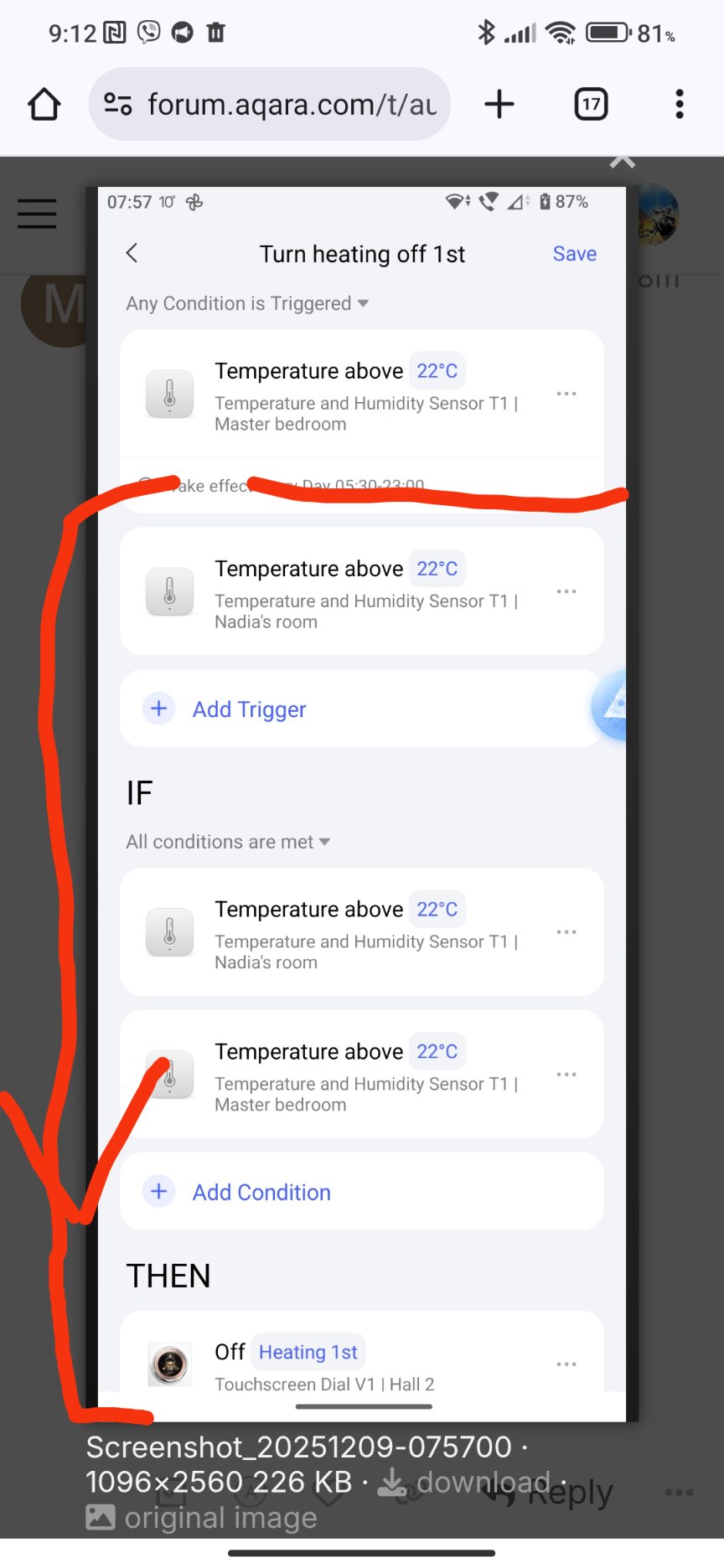

Do this.
try this

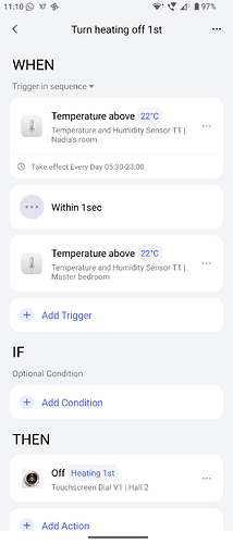

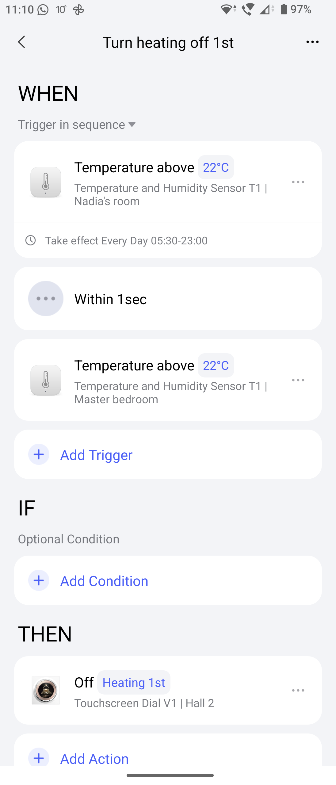

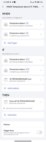

Thanks guys for responses. But both solutions don’t work for me. Only clearing the IF section helps. But it doesn’t let me use AND condition as WHEN section works only as OR. I don’t know know how. To solve the problem I had to use hacky solution:
It seems the problem is only with temperature sensors T1 because other automations that I have work with IF conditions correctly.
I don’t understand, my entire heating control system is built on my example, everything works. Maybe your temperature in the IF section never happens (T1 or T2 at the same time no more than 22°C). Have you tried to run the test without time limits?
It definitely happens. I had more then 23 degrees on both sensors. I also tried without time limits. I even tried to leave only one condition in the IF section. Nothing helped until I cleared it.
I generally do this configuration, only there is no time frame.
Explanation, the condition in WHEN with a value greater than 0 forces it to poll the IF section for execution each time information is transmitted to the gateway (the period is visible in the temperature graph log). The second feature is that you can change the control parameters only in one section (IF).
