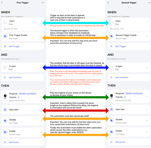

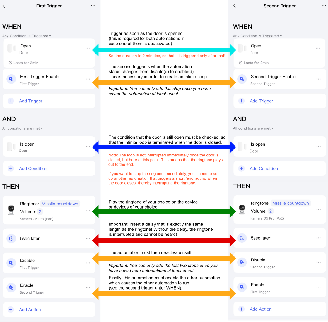

Hi. That’s how I would go about solving the problem: With two automations that run alternately, and are therefore executed in an endless loop until the door is closed.
Hi, here I wrote lesson 23 for your problem. You can use it. If you have any questions, I will help.
