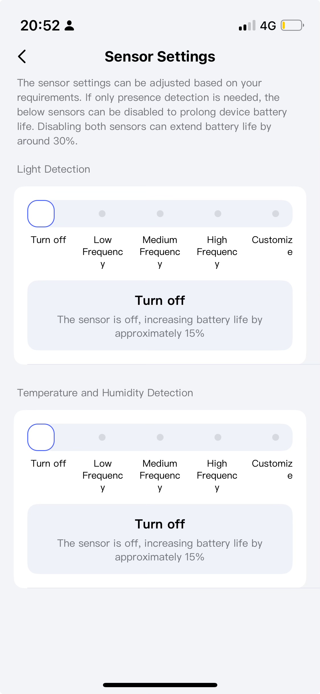

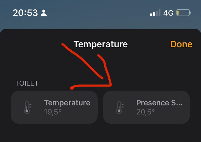

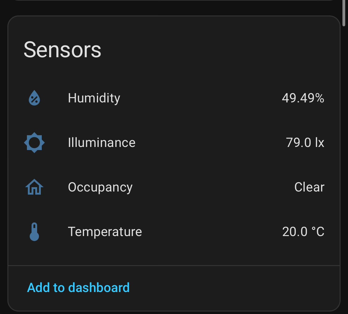

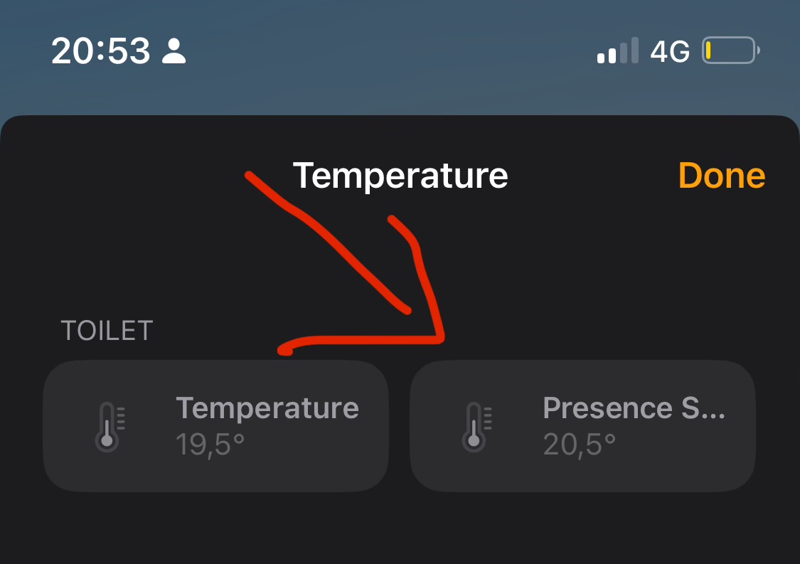

  1. I have turned off the temperature/humidity sensor as well as the illumination sensor, and yet I see these values in HomeKit and when exposing over Matter through my M3 hub (in Home Assistant)
HomeKit:
Home Assistant:
Is there a way to disable them also in HomeKit and over Matter? How do I know whether the battery saves power with 30%?

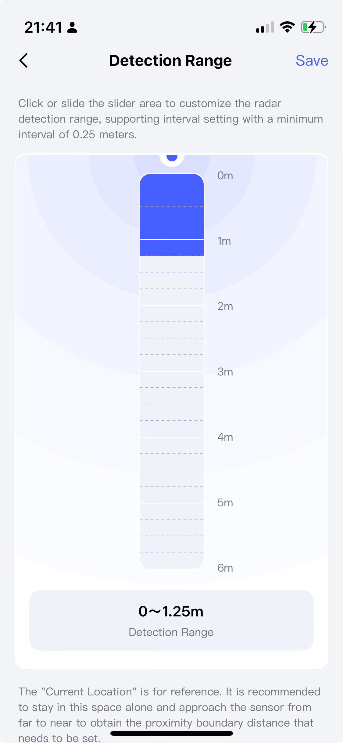

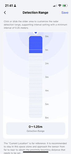

  1. When I tried to configure the detection range in the configuration settings, I was standing in the middle of a room, 1 meter away and in front of the sensor, and yet the ‘current location’ does was not within the range but outside. Proper optimalisation of the settings can therefore not be done.

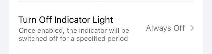

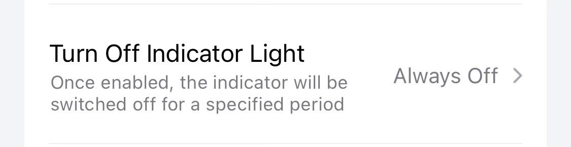

  2. The ‘Turn off indicator lights’ settings are confusing. You enable the setting to turn off the lights at certain times. With that you would expect that if this setting is disabled, the indicator lights would always be on. And yet it shows as ‘always off’ when the switch is disabled. I would simplify it by saying if the switch is enabled, the indicator light will be on.

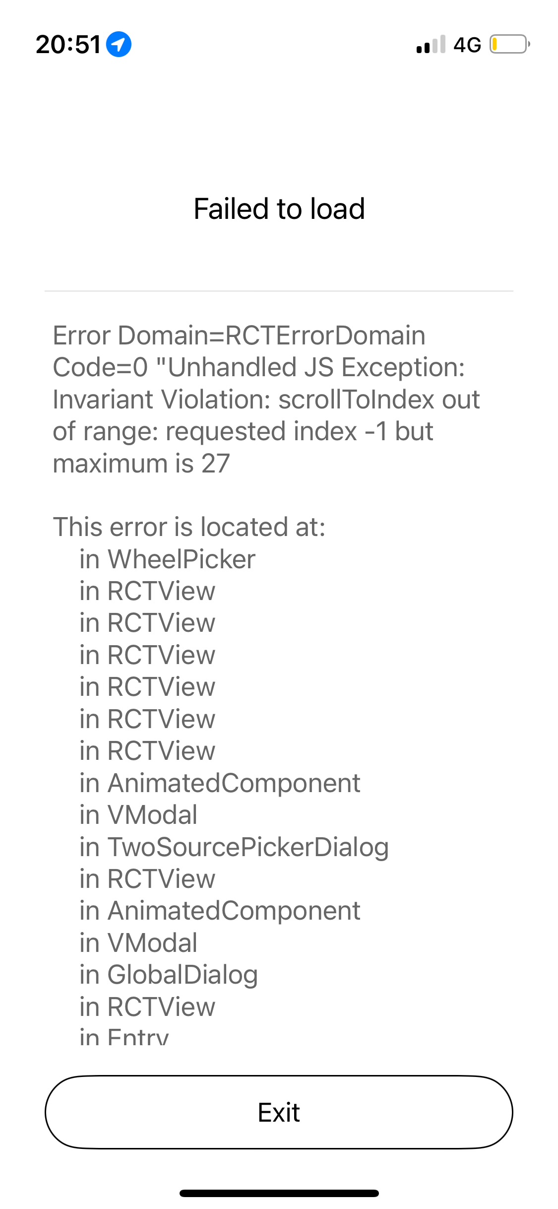

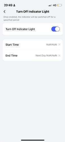

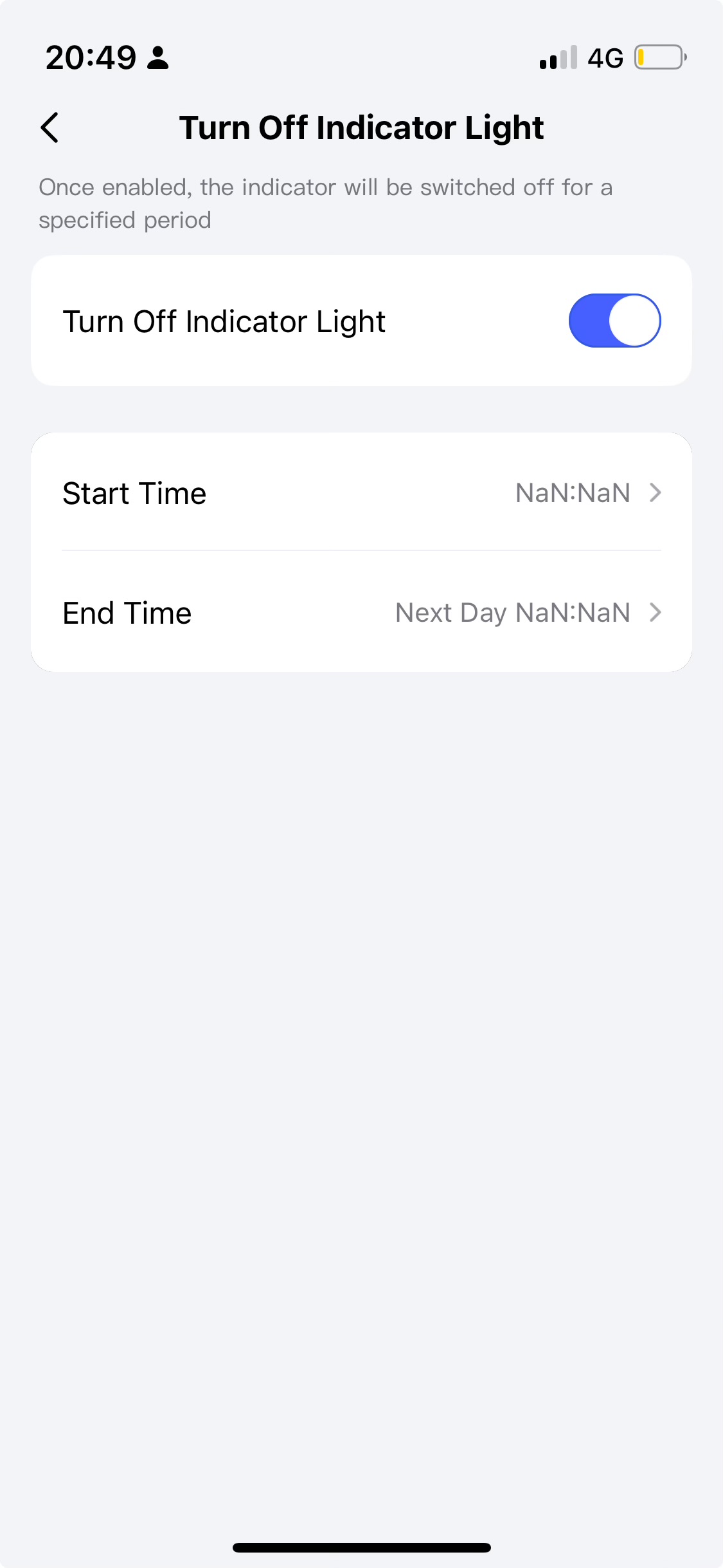

  3. When setting up the time for indicator light to be off at certain times, you see ‘NaN’. When trying to change it, you get the following screen:

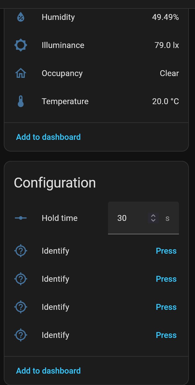

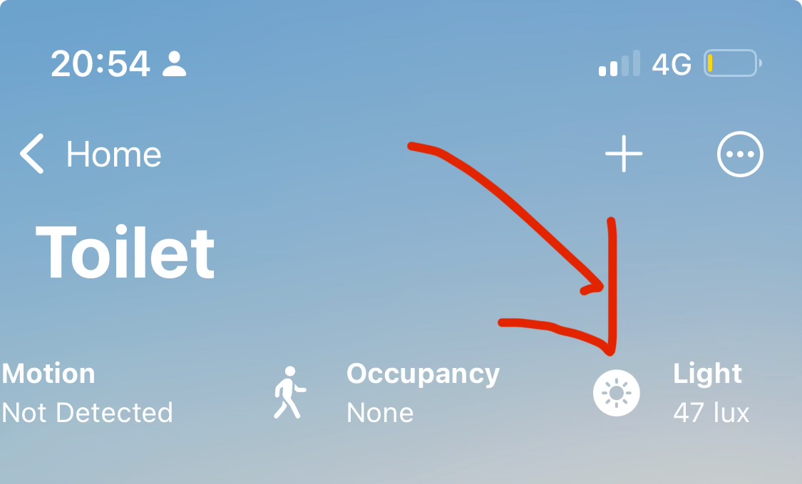

  4. In Home Assistant, where my sensor is exposed over matter through the m3 hub), the motion sensor does not see t0 be exposed. I cannot create any automation based on motion. Instead, they seem to be identify configurations:

Reading your post I am under the impression that maybe you are experiencing a translation issue in the wording used.
For example in 5. There is no “Motion” sensor because it’s actually an “Occupancy” sensor and it shows clear at the screen shot moment.
In example #3 I think you are experiencing the same sort of translation issue
In example #1 that is normal, HomeKit and Home Assistant see those features even though they are disabled in the Aqara app. Aqara I don’t think has any say in those examples, that would be an Apple HomeKit feature and Home Assistant software feature. Aqara is not able to tell Apple nor Nabu Casa or the Open Home Foundation how to interpret software features.
Thank you for clearing up several points. I agree on the translation issues in 3.
Regarding 1. I understand that Aqara can’t control how other platform interprete software features. Yet I would expect that if they are disabled in the Aqara app, they simply would not be exposed over HomeKit and/or Matter. I did discover by now that the values are not updated. So the entities are exposed but simply not updated.
The reason why I mention 5, is that in the Aqara app you can create an automation based on motion OR occupancy. The motion detection is much faster than occupancy, (which makes sense). Therefore, I had hoped the motion detection was also exposed over matter.
If the motion is exposed in the aqara app can you create a “signal sync” in the app and then expose that via matter to home assistant?
I have done the same sort of thing with my g410 motion as in home assistant nothing is exposed via matter for my g410
I’m experiencing the same issue with disabling the temperature and humidity sensors as you are.
In the Aqara app, the functions are switched off, and no values ​​are displayed.
However, the values ​​are still shown in HomeKit.
The sensor is connected to my M3 via Zigbee, and all my Aqara devices are exported via HomeKit integration.
