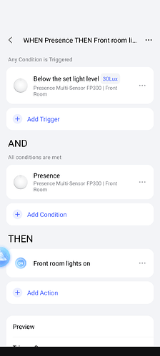

It sounds like the primary trigger for your automation should be lux with presence as a condition, so that as the room darkens the automation runs. Is this the case? You can share a screenshot of your automation. If the automation starts with occupancy, you’ll need to trigger presence to kick off the automation.

I’ve just updated it to how you say, see attached screenshot. Hopefully this will work.

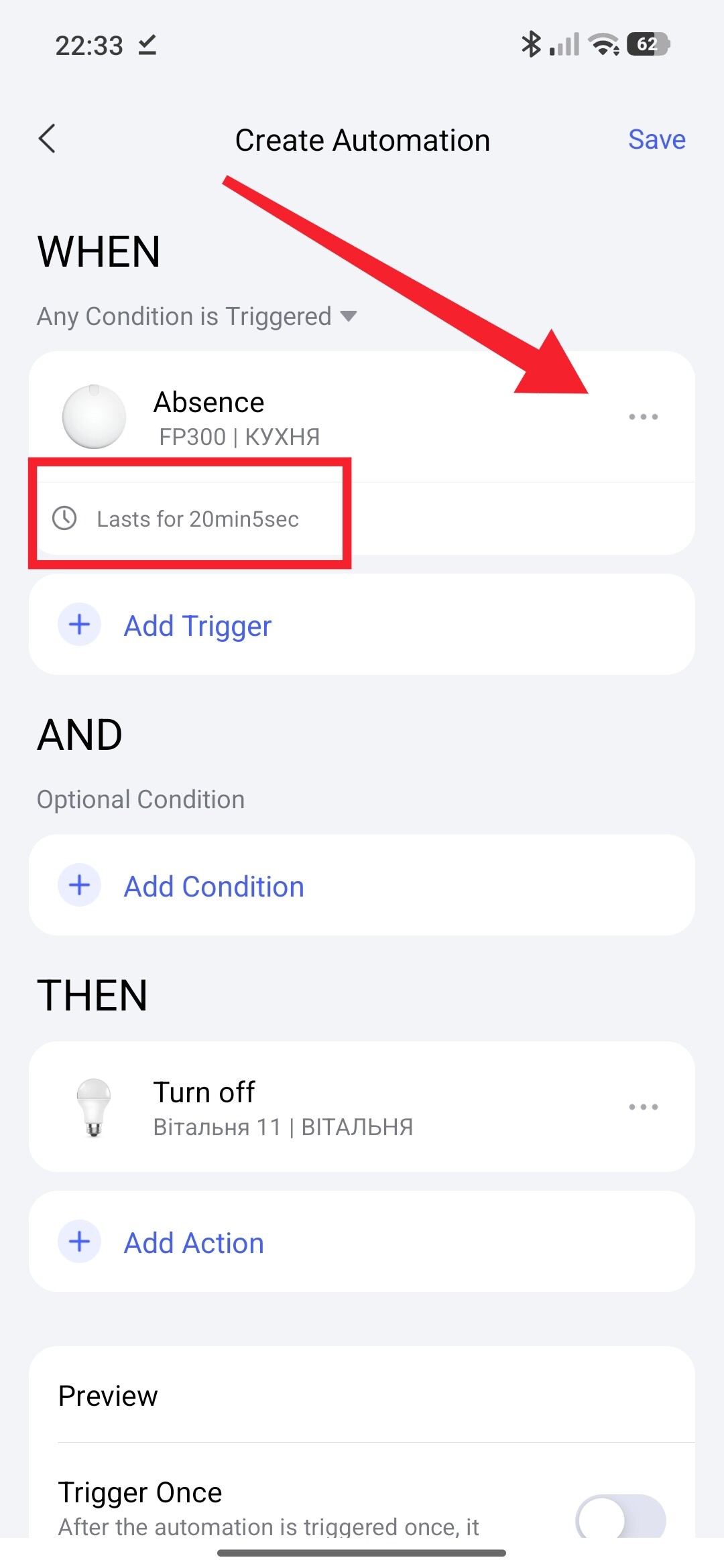

Can you advise how an automation to turn the lights off should work? I have one that says when their is no presence for 20 minutes to turn the lights off. However if I leave the room for a short period and return, then the automation will run 20 minutes after if left the room - regardless of I was still in the room

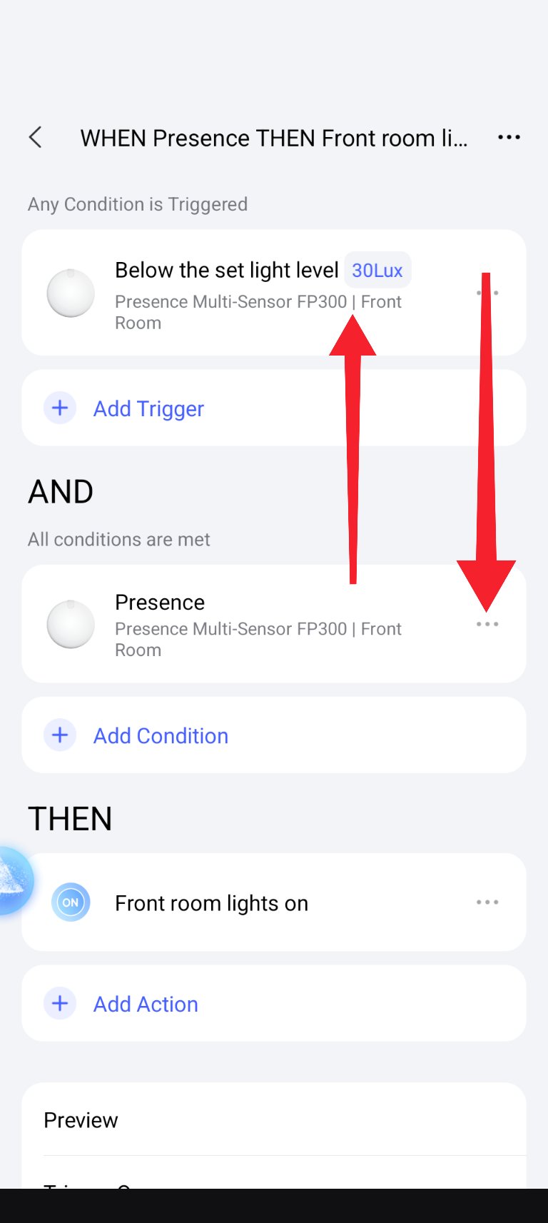

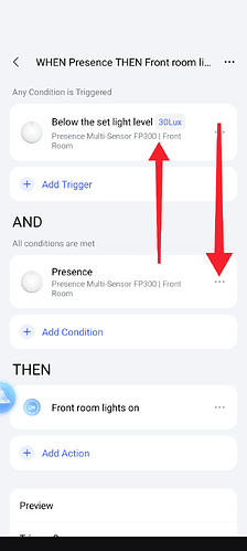

Hi, swap the WHEN and IF conditions. Then the automation will work fine.

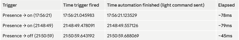

To be transparent, I have the FP300 devices exposed to Home Assistant via Matter, the automations run in HA and not in Aqara Home. That being said, here are my trace logs from a few automation runs today with one of my FP300s
In every case the light-service call itself goes out within 2-3 milliseconds of the state change, and the whole automation (including a timer-cancel step) wraps up in under 100ms. Nowhere close to “several minutes.”
Hello, show all the automations (On, Off) that you use for the light bulb that you described. Thank you.
