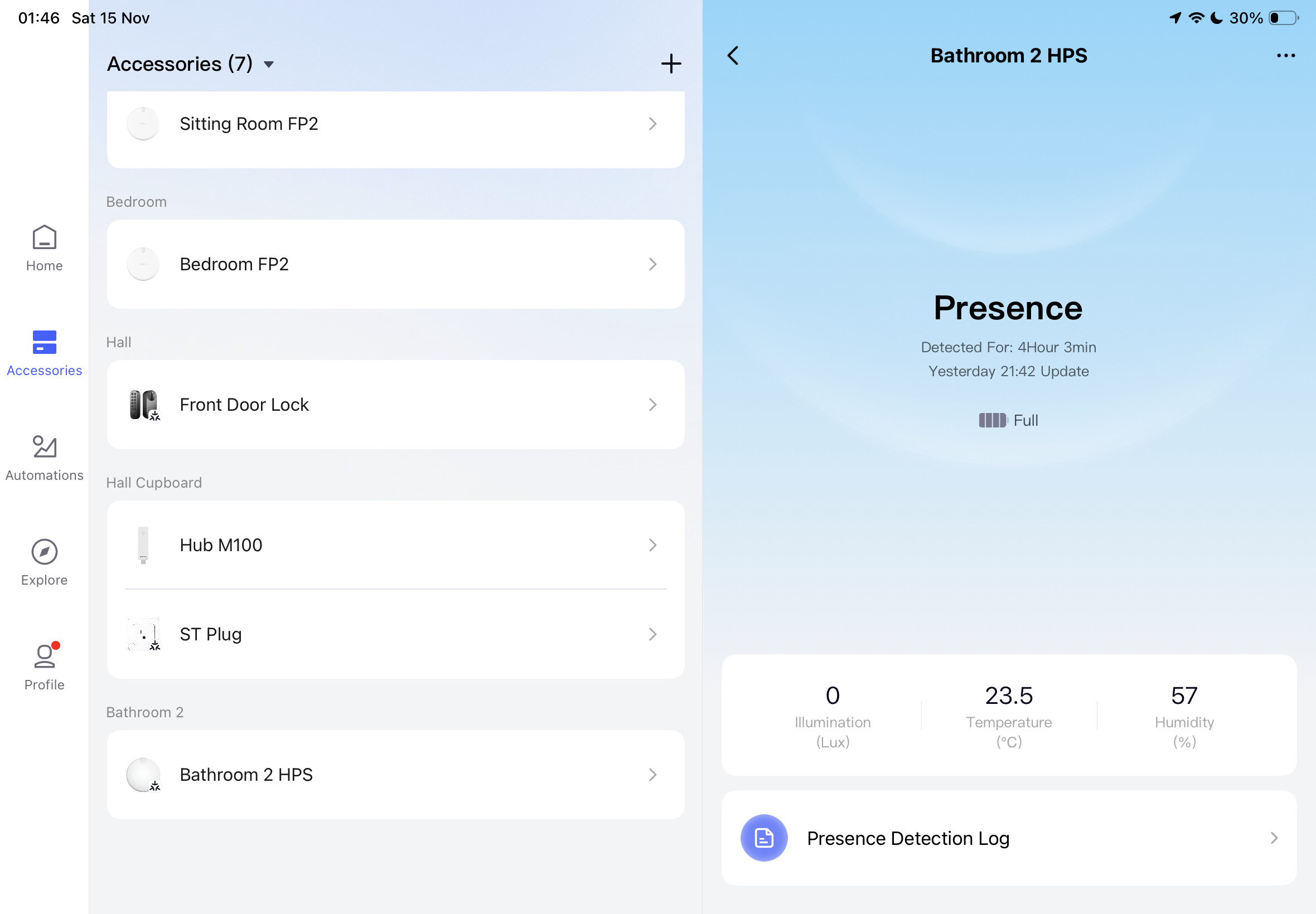

Just installed my first FP300 in the Aqara App in Thread mode and it is stuck in ‘presence’. The settings are default and firmware latest.
I tried a factory reset to no avail.

The FP300 is in a small shower room with no interference sources that I am aware of.
I will leave it overnight and then I guess I will have to use zigbee which is annoying.

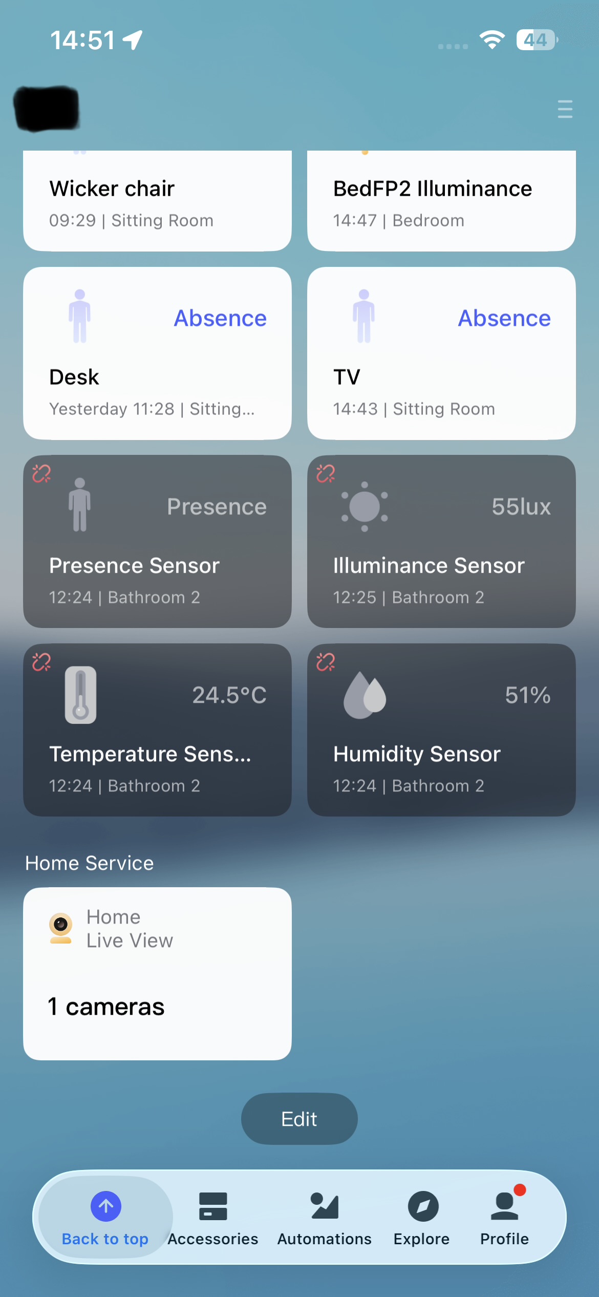

I left it overnight, no change. Reset and working normally with Zigbee. I will try setting back to thread.
I reset to thread. We are back to my original post situation, shows presence when there is none. I will leave it overnight!

I was able to cure this.
But I had to remove all of my Aqara hubs to do so. They are severely congesting the thread network for me, after removal all of my thread specific devices work fine.
I think I will wait for a firmware update.
I pulled the sensor for now. The hub removal actually helped me.
