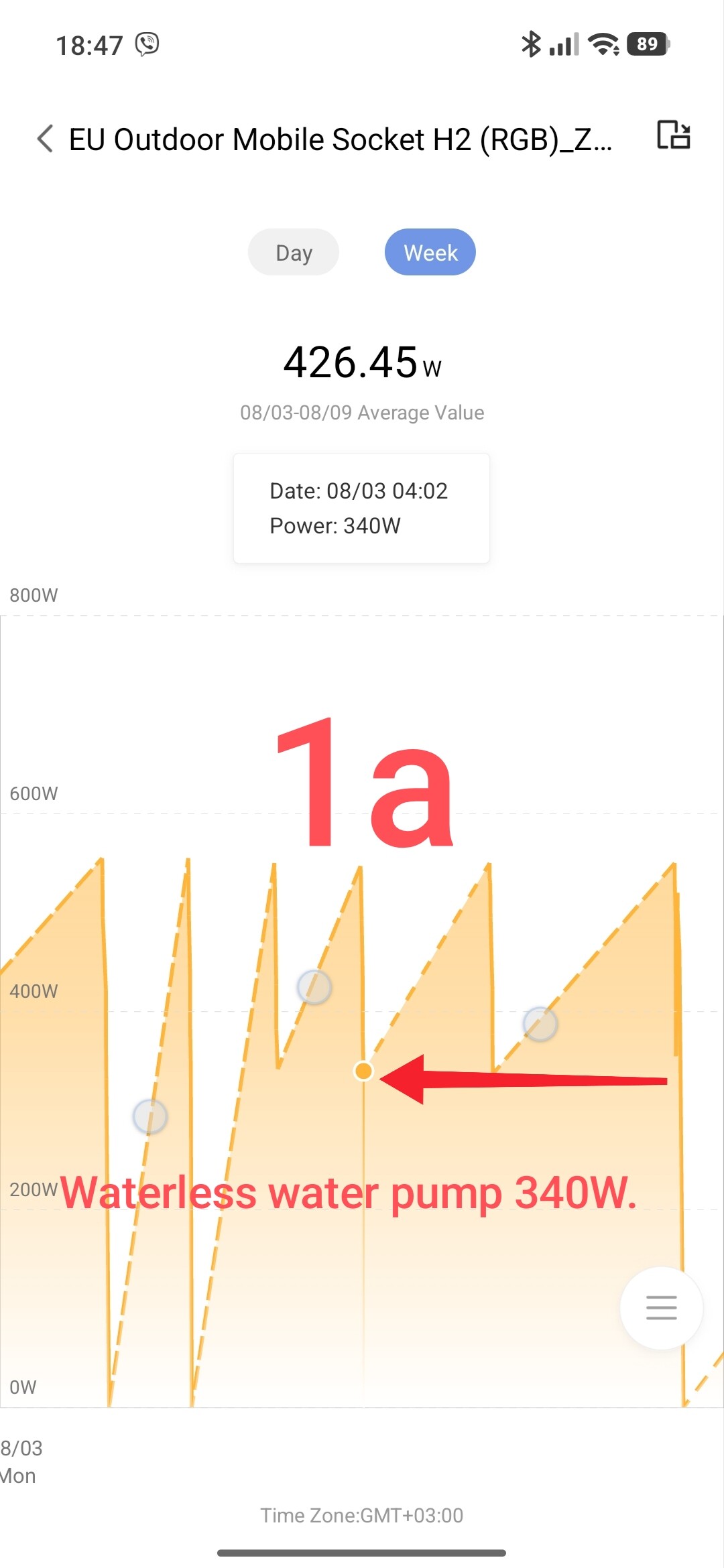

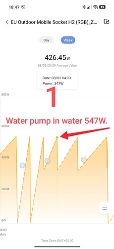

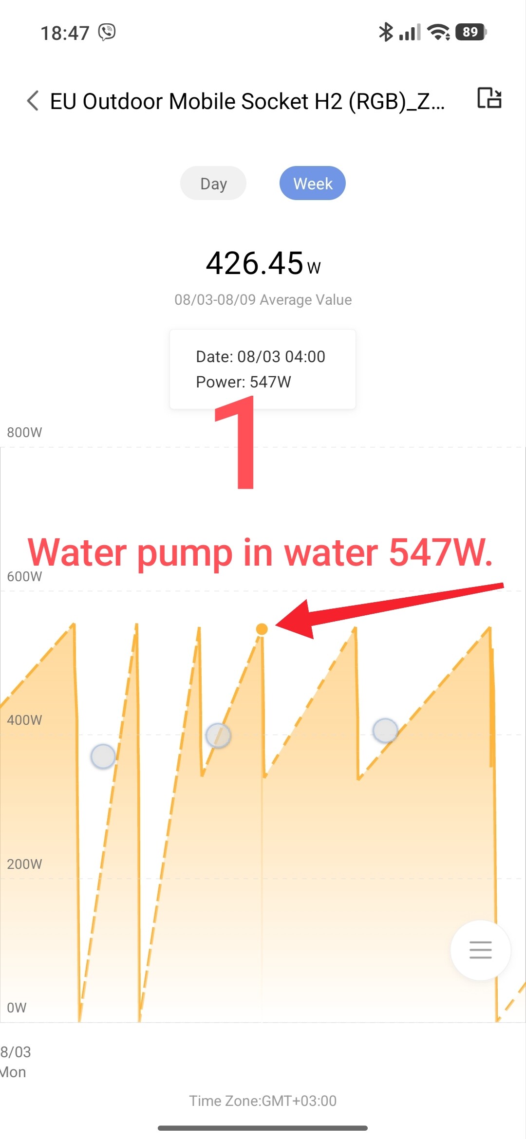

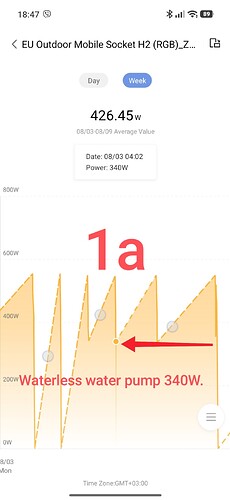

- the water pump works in water, consumption 420-560 W;
- the water pump works without water, consumption drops to 300-380 W.
Fig.1

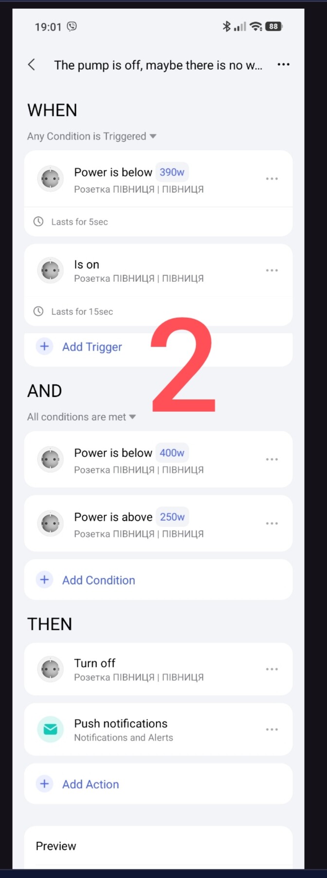

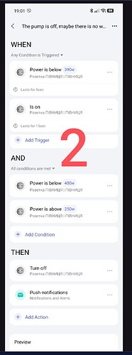

Based on this, I made an emergency automation of dry running control. At the end of the automation, I gave a push message “there may be no water in the well”.
I will not explain the algorithm of the automation. The automation is 100% working, it has been tested in critical conditions.
Fig.2.
