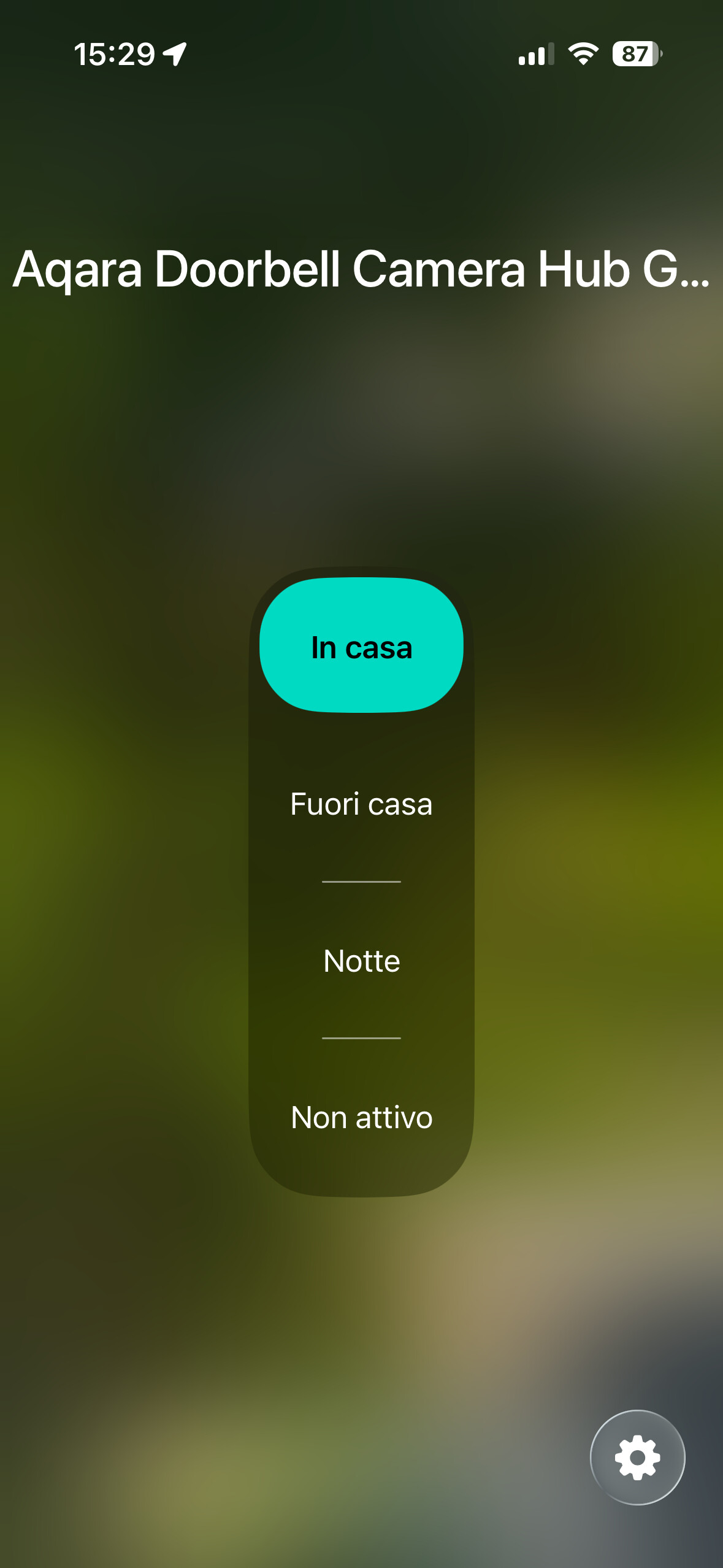

What exactly do you mean? The card in the Aqara app or as a widget in iOS?
Yet I do not see why that menu is shown upfront as if it were a decisive setting to set, when probably it is the geofencing to select if one is at home or not.
Can you make Screenshot?
This one, in Italian.
That’s just the view of the security system in the Apple Home app when you tap on the security system.
If you don’t need it, just tap and hold it, then remove it from the Home view, and it will be gone.
Or have I misunderstood something? :thinking:
Actually that menu seems not to go away, even pushing it. But my question is about its function.
The Aqara Doorbell Camera Hub G410 is several devices in one: camera, doorbell, and hub with alarm system. And several devices are displayed in the “Home” view of the Apple Home app. It should therefore be displayed once as a security system (alarm system) and once as a camera in the “Home” view.
When you tap on the security system, you will see this switch, which you can use to change the alarm system mode:
  • “In casa” means that you are at home and have configured various sensors that trigger an alarm, for example, when a trespasser is detected by a camera.
  • “Fuori casa” means that you are not at home and have configured various sensors that trigger an alarm, for example, motion detectors in the house.
  • “Notte” means night alarm – you are in bed and have configured various sensors that trigger an alarm, but not the sensor on the bedroom window, for example, because you sleep with the window open.
  • “Non attivo” means that no alarm mode is activated (the alarm system is off).
You can only use the Aqara Home app to specify which sensors you want to use in one of the alarm modes, as shown in the video.
If you don’t want the alarm system to appear in the “Home” view, you can remove it from there. Tap and hold the device, then remove it from the Home view. Alternatively, you can do this via Settings (gear icon). And than turn off the “Show on Home Screen” option.
You can display it again via “Home settings.” There, you can also show/hide all devices and change the hub settings or see how many devices are connected via the hub.
