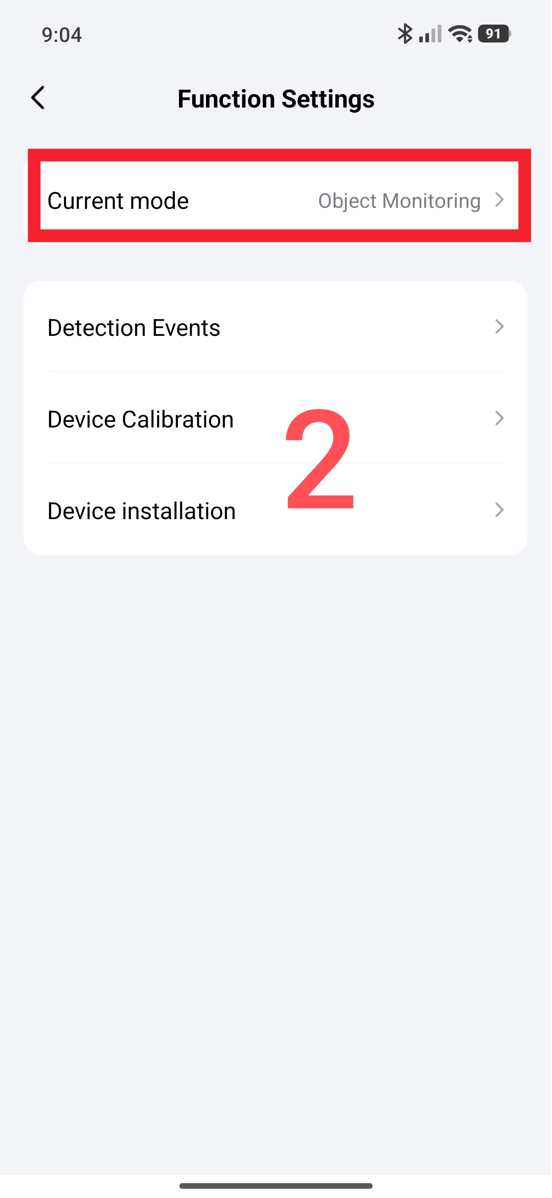

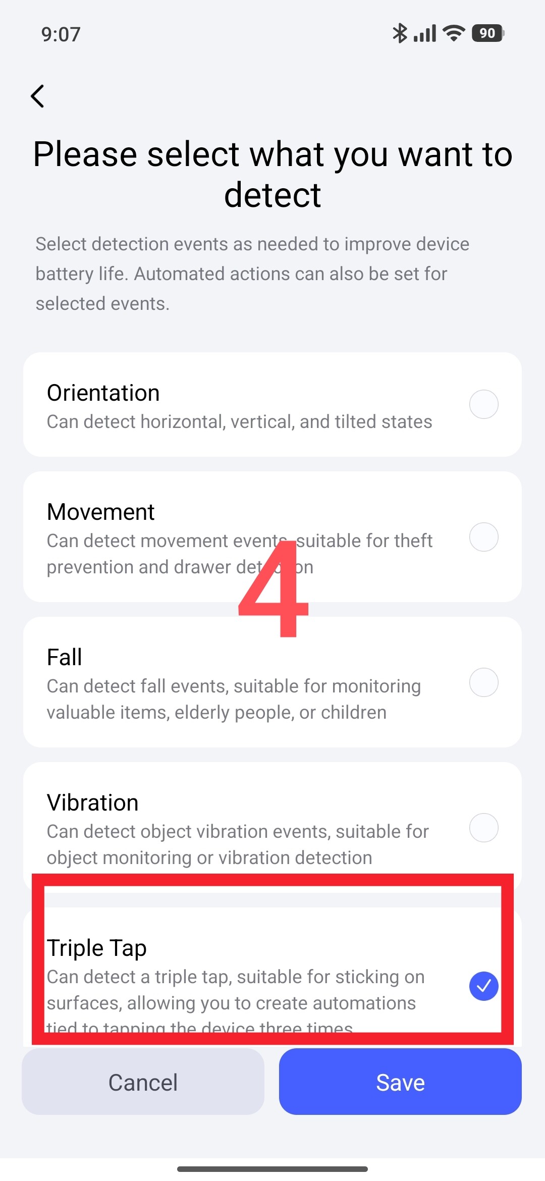

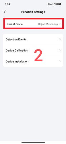

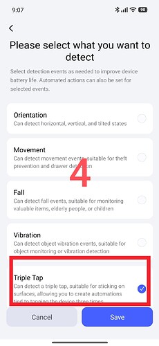

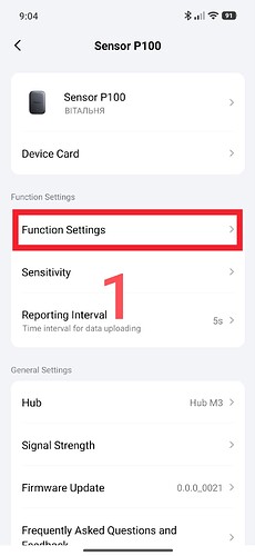

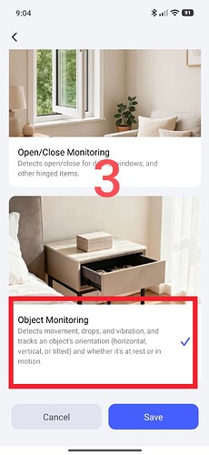

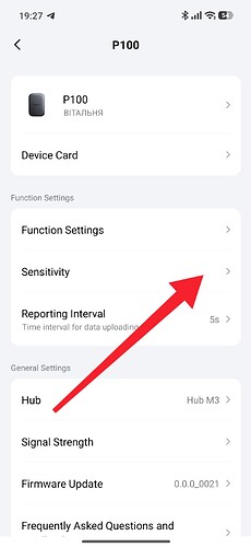

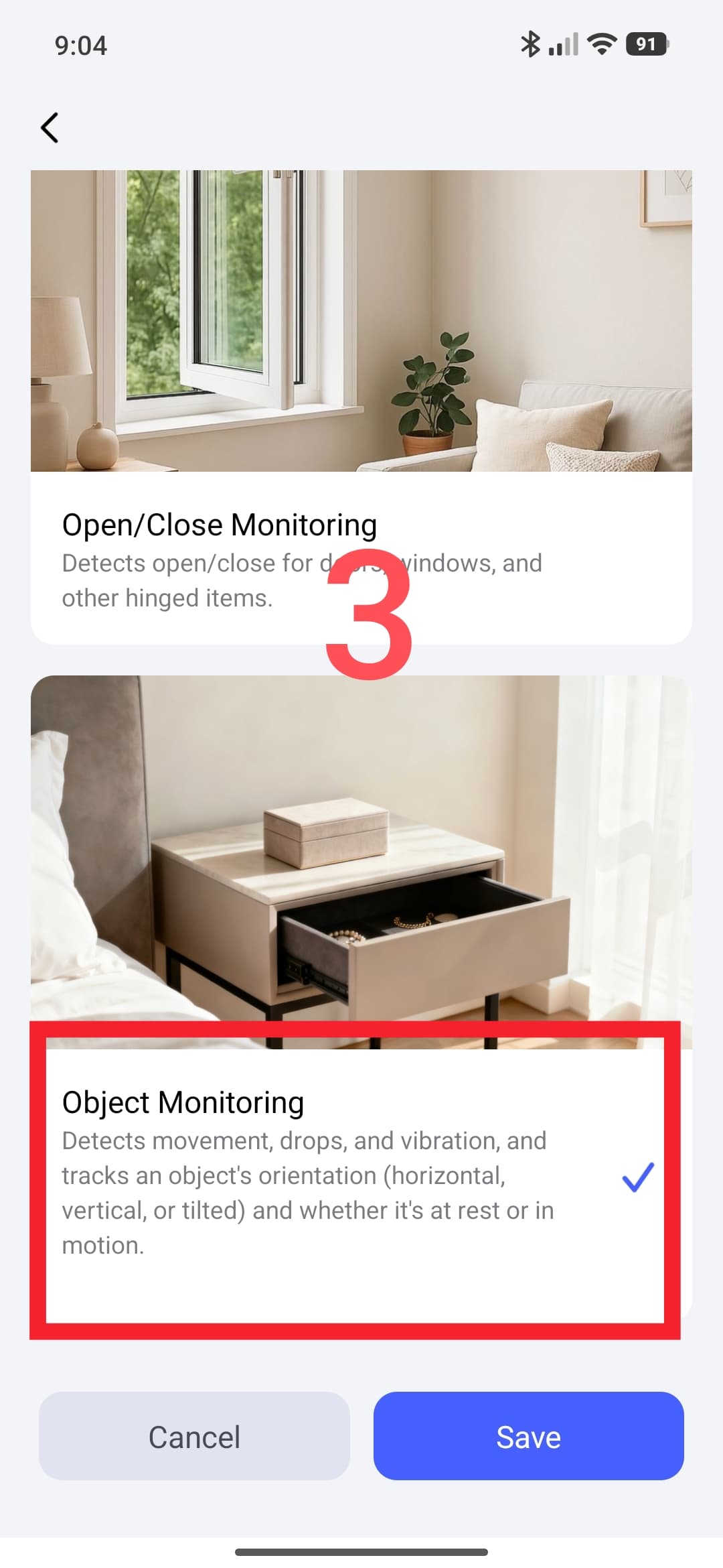

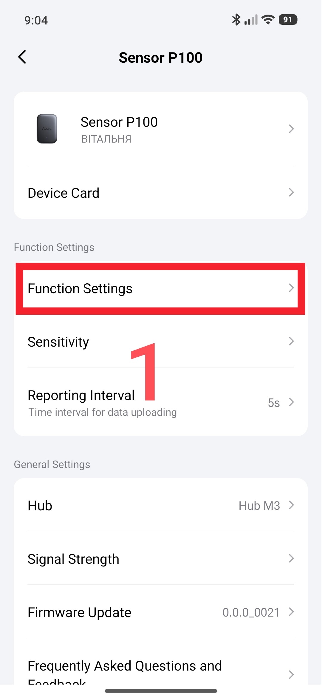

You simply attach the P100 from the back. Make the following settings for the P100 sensor.
Fig1,2,3,4

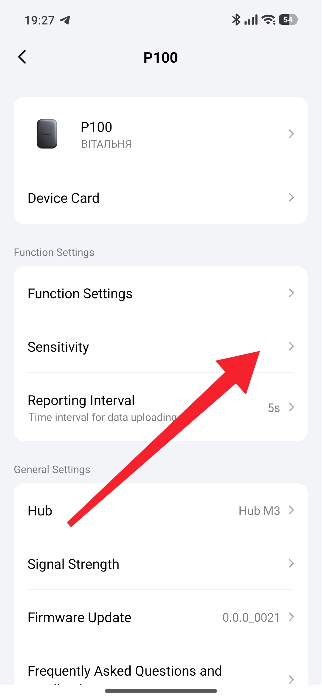

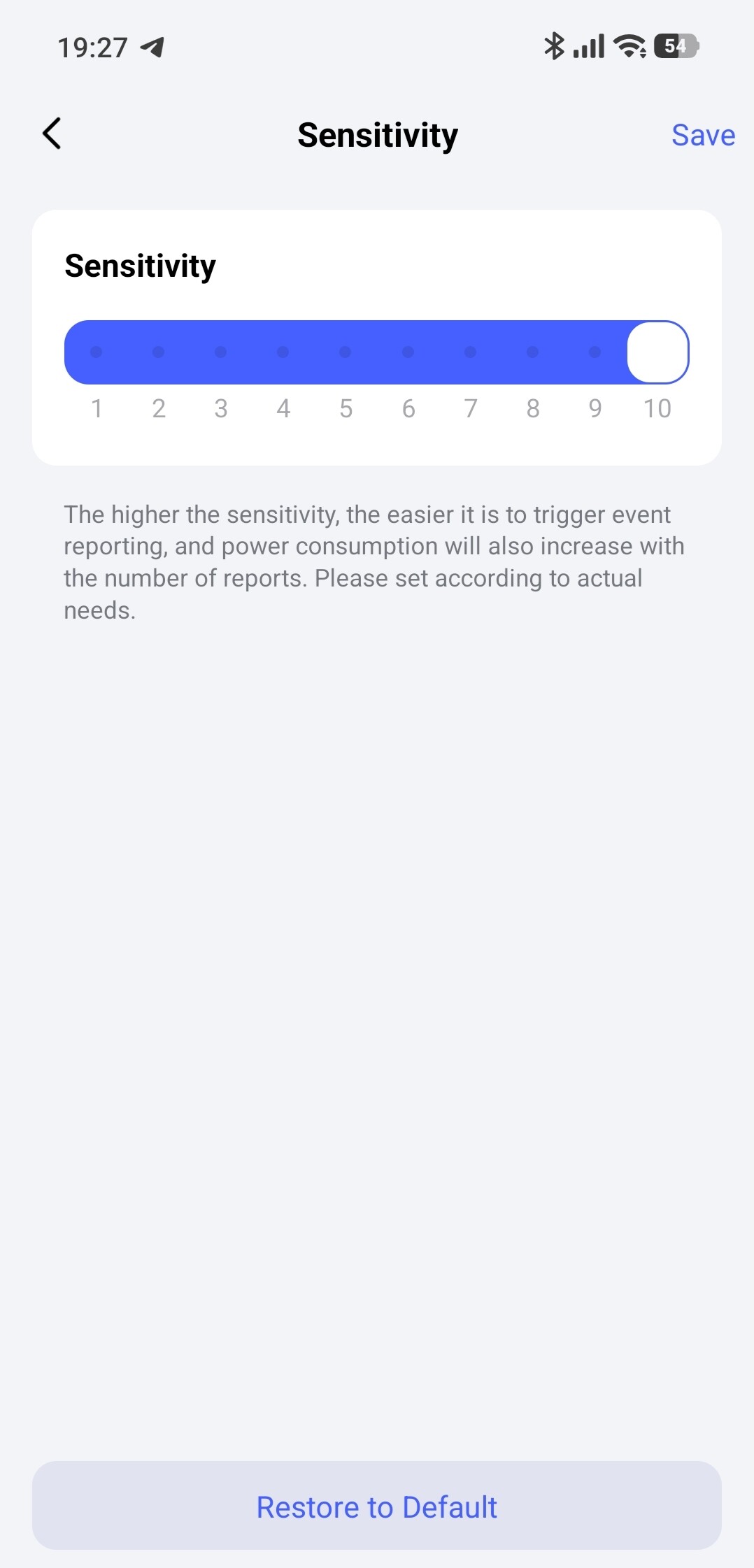

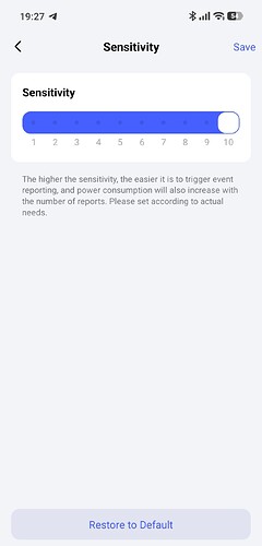

Special attention to the sensitivity setting of the P100 sensor. A correctly set “sensitivity” level will ensure reliable operation without “false” doorbell activations. This parameter is selected experimentally, depending on the type of door.

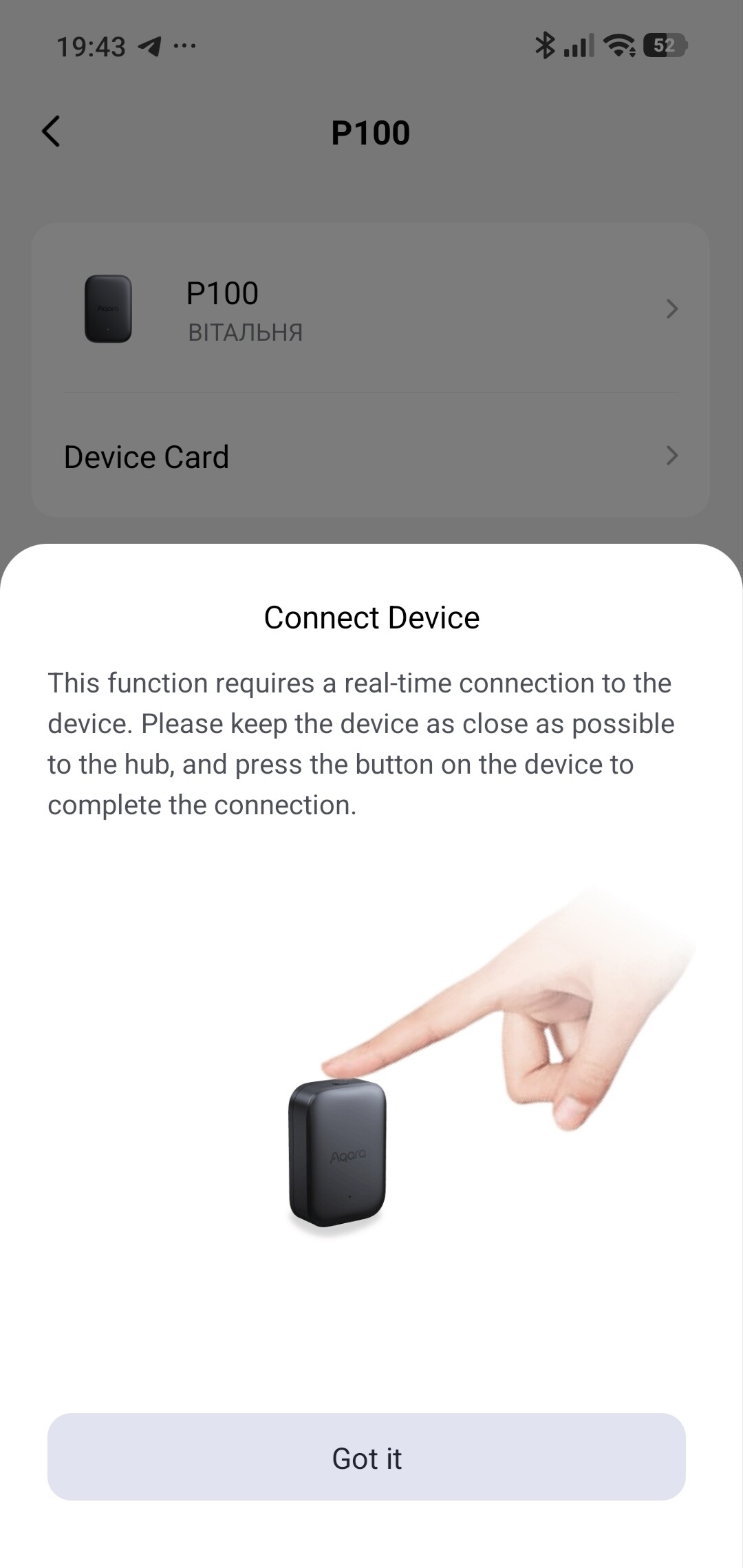

ATTENTION!! When selecting the “sensitivity” parameter for the first time, press the button on the sensor once. Press the “sensitivity” parameter again in the APP and continue the settings.
Fig.

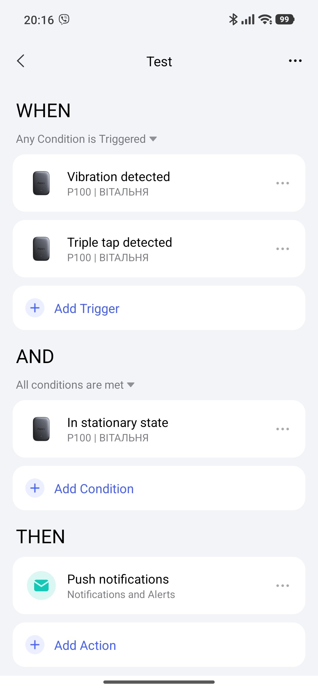

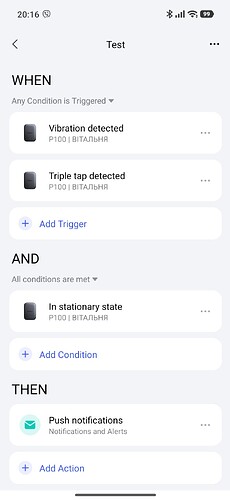

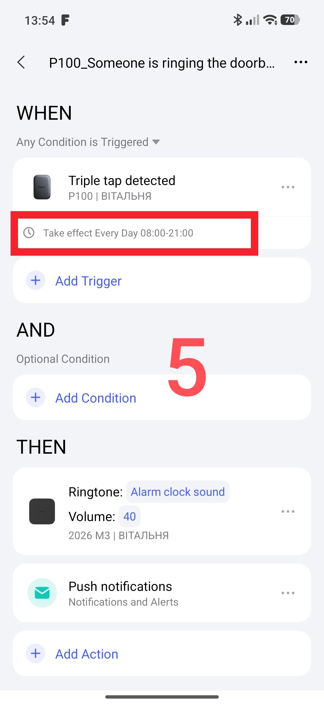

We are creating automation 2.0 that will turn on the sound on the Aqara gateway (which has a speaker) after a triple knock. Also, a time limit is set when you do not want to be disturbed.
Fig5
Now we have a doorbell with a push notification to your phone.
