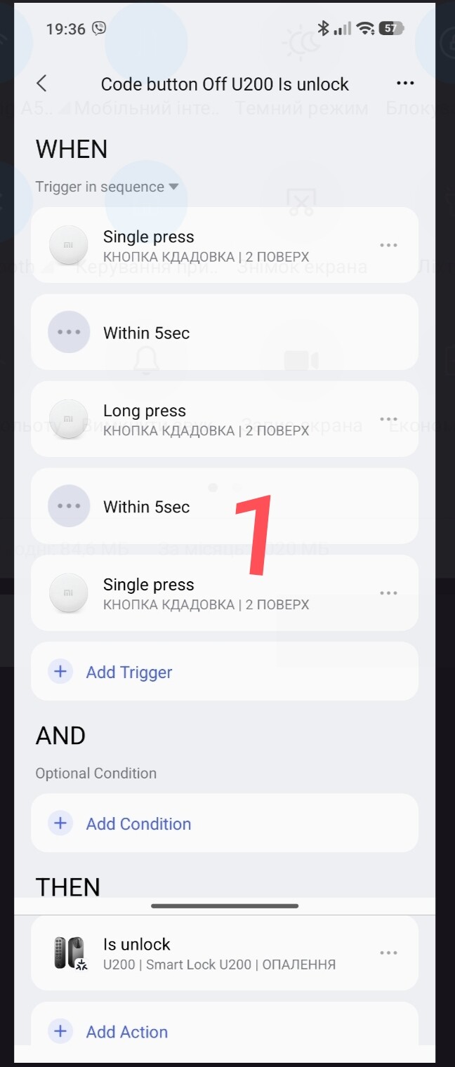

Good afternoon, today’s lesson is related to creating automation of “pseudo” code entrance to the yard, door using T2 relay or any other Aqara lock.
What prompted me to create this automation. I have a private house from which I often enter and exit through the front door. The U200 lock has a peculiarity, a wet finger does not want to see the fingerprint scanner, and this is very annoying. The code must be dialed from 6 digits, which is very inconvenient at once. I want to note that this is an auxiliary door opening. For every day when you do something near the house.
Chapter 1.

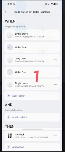

The essence of automation is ridiculously simple. We use the sequence of pressing a wireless button that starts the automation. This sequence can be different, the main thing is that there are no two identical combinations in the pressing chain (press-press…).
Example of automation.
Figure 1.

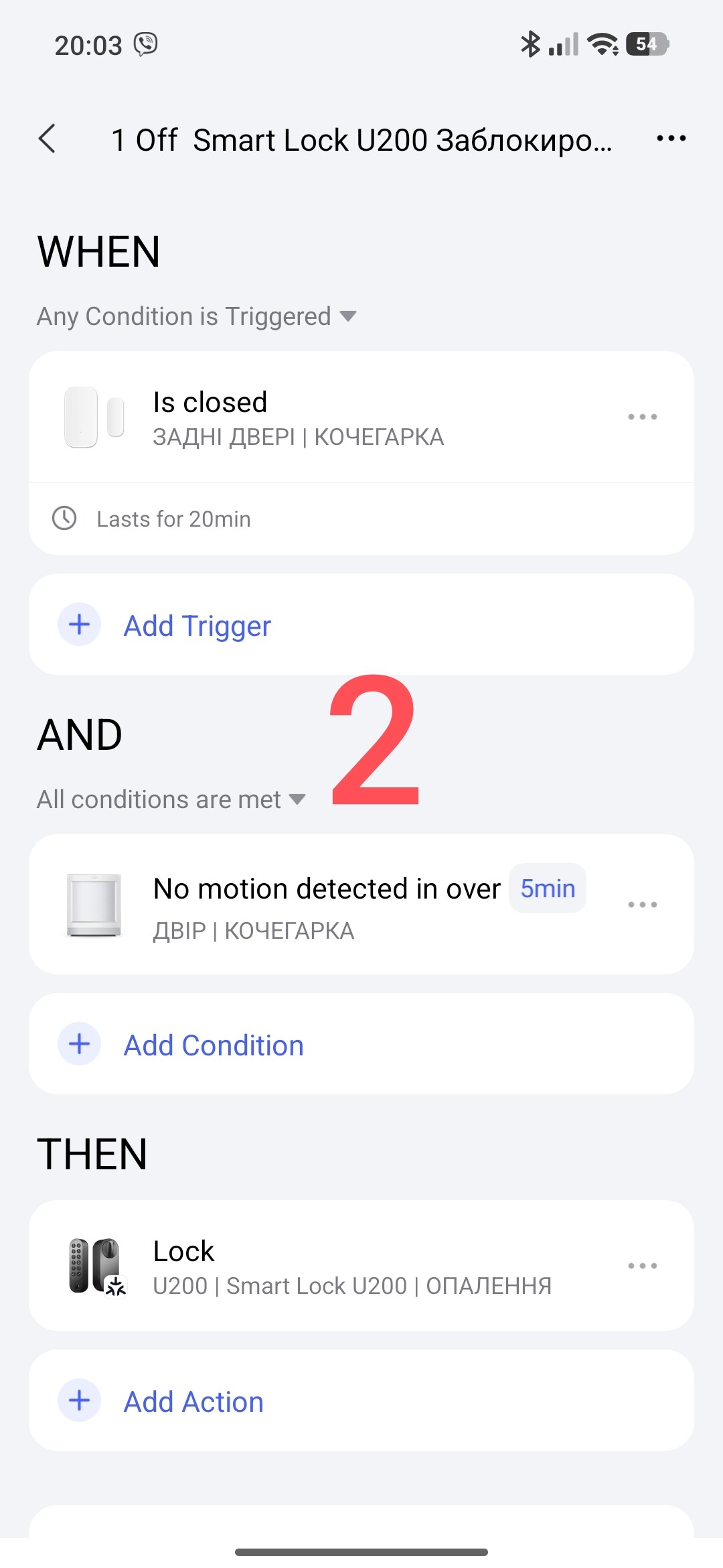

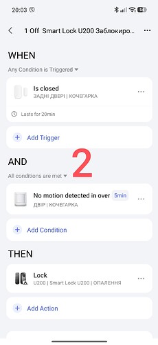

I want to show automation for the U200 lock that automatically closes the door when I go outside for technical issues.
Explanation
The closing trigger (THEN) is the closing sensor when there is no movement for 20 minutes.
The condition (IF) is the motion sensor (no movement for 5 minutes) placed above the entrance door where the U200 lock is.
The condition (THEN) closes the lock.
Automation created
Figure 2.
Chapter 3. Safety of using the created code signal (section 1).
To ensure the reliability of the front door, the automation (Fig. 1) turns off at 22.00 and turns on at 09.00.
This automation also turns off when I turn on the “no one is home” mode.
This lesson was made to start your imagination.

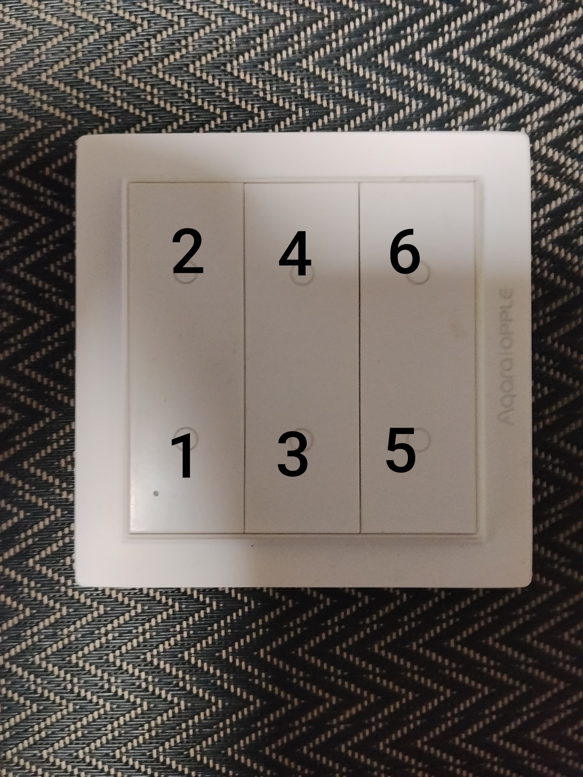

Hello. In addition to my lesson, I present a full-fledged Aqara code dialer based on the “Aqara opple” wireless switch. Choosing a code logic of 16 buttons and a combination of 6 presses — that’s 16,777,216 possible options!
