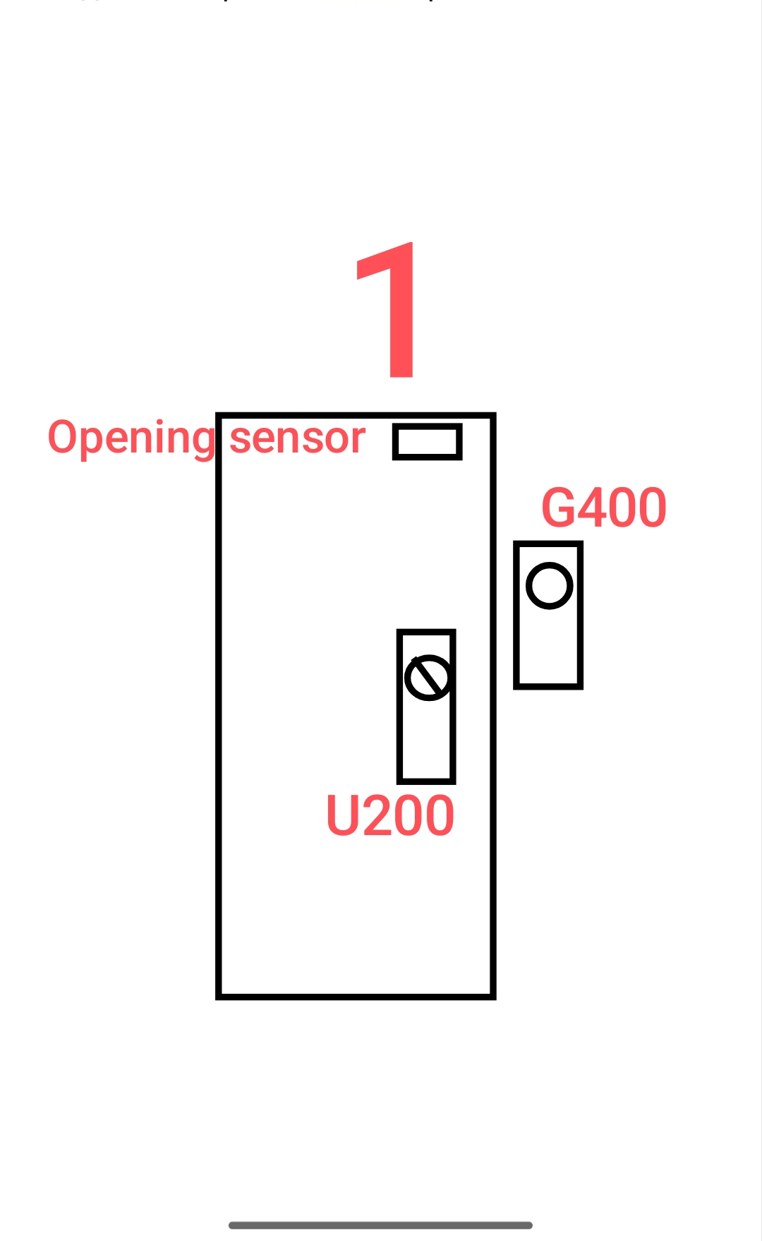

Devices that must be in a smart home to implement my automation:
- U200 lock;
- opening sensor on the door where the U200 lock is located;
- G400 video doorbell (or another Aqara model).
Fig.1

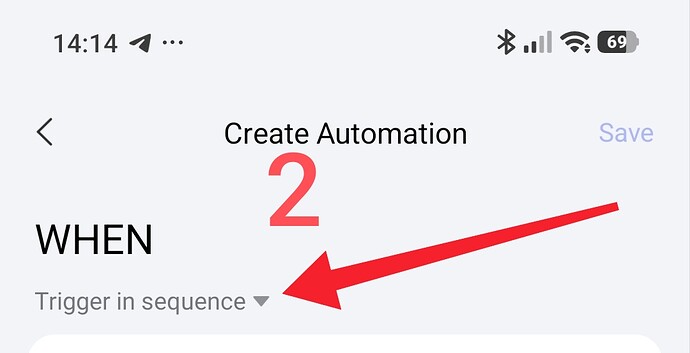

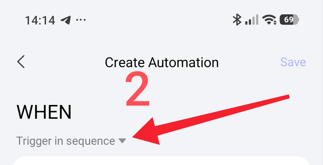

The solution to this issue is based on the use of automation 2.0, the WHEN section in sequence mode.
Fig.2.

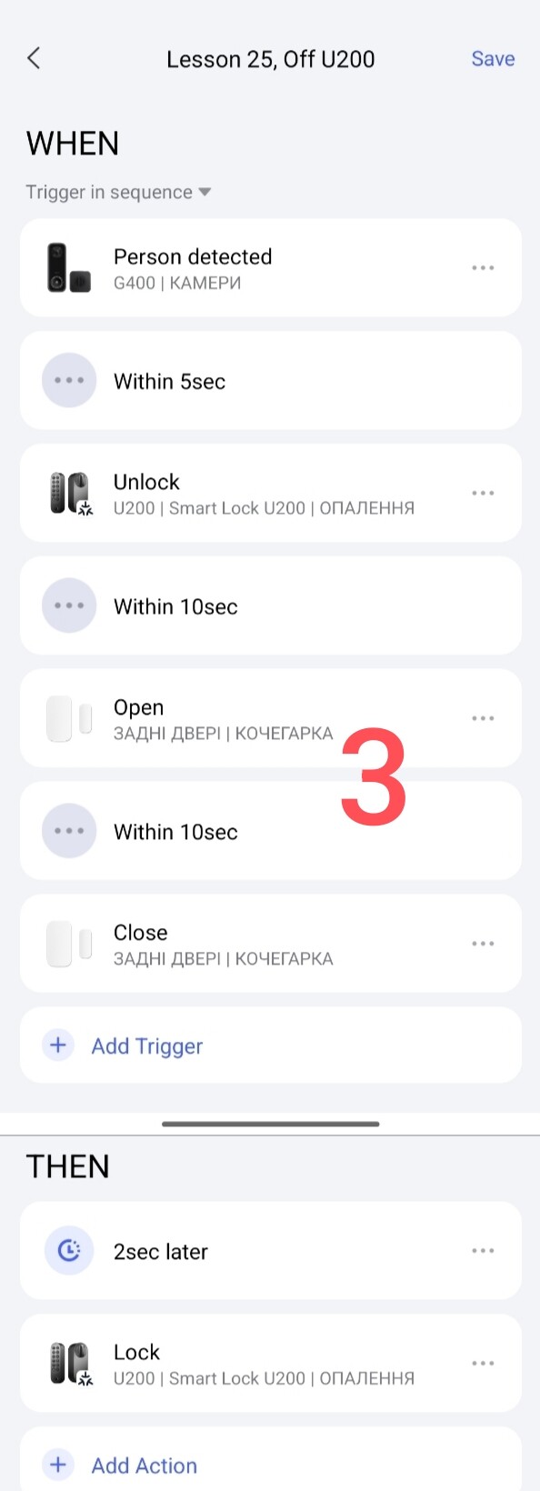

Algorithm, if the video doorbell sees a person → the lock opens → the door is open → the door is closed THEN close the U200.
The automation for this task looks something like this
Fig.3.
This automation is very simple and effective.
