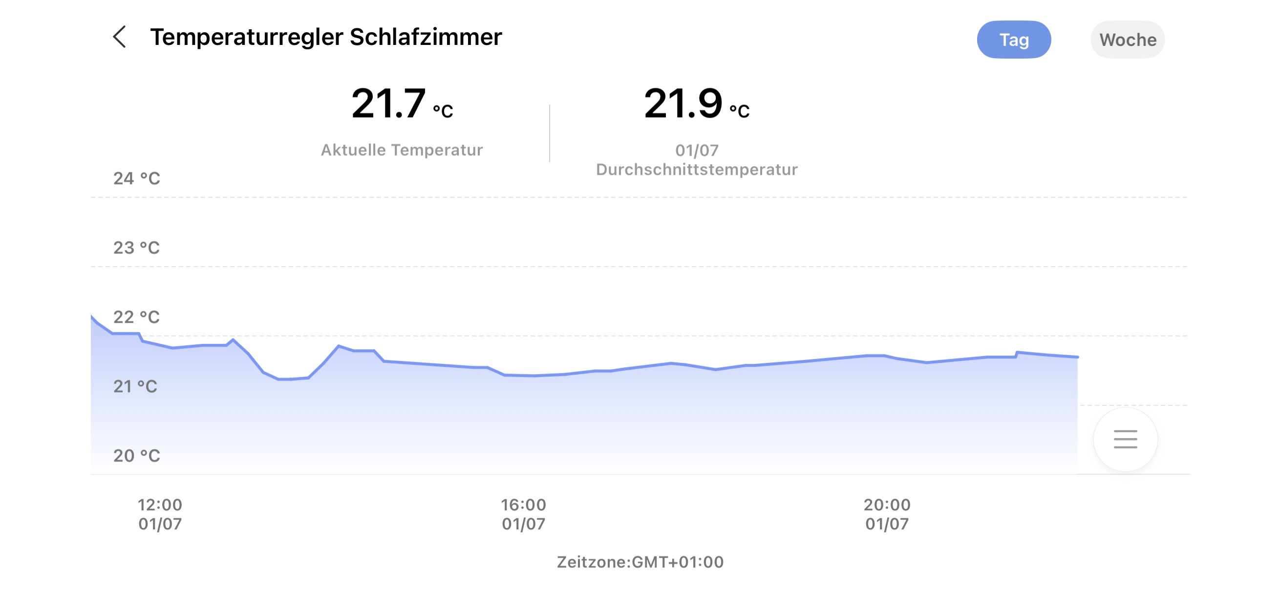

great with firmware 0.0.0_2543
-The thermostat has been running without problems for about 10 hours now.
set to 22 degrees
-The schedules have now been activated, and there will be another update tomorrow evening.
