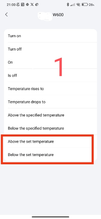

The first option is to use the smart schedule settings that are built into the E1 or W600 device.
The second option is to use my smart schedule development that I described in lesson 10 ( Automation 2.0, lesson 10, room climate control. Creating a smart heating schedule for radiator thermostats (E1, W500, W600) )
The second section.

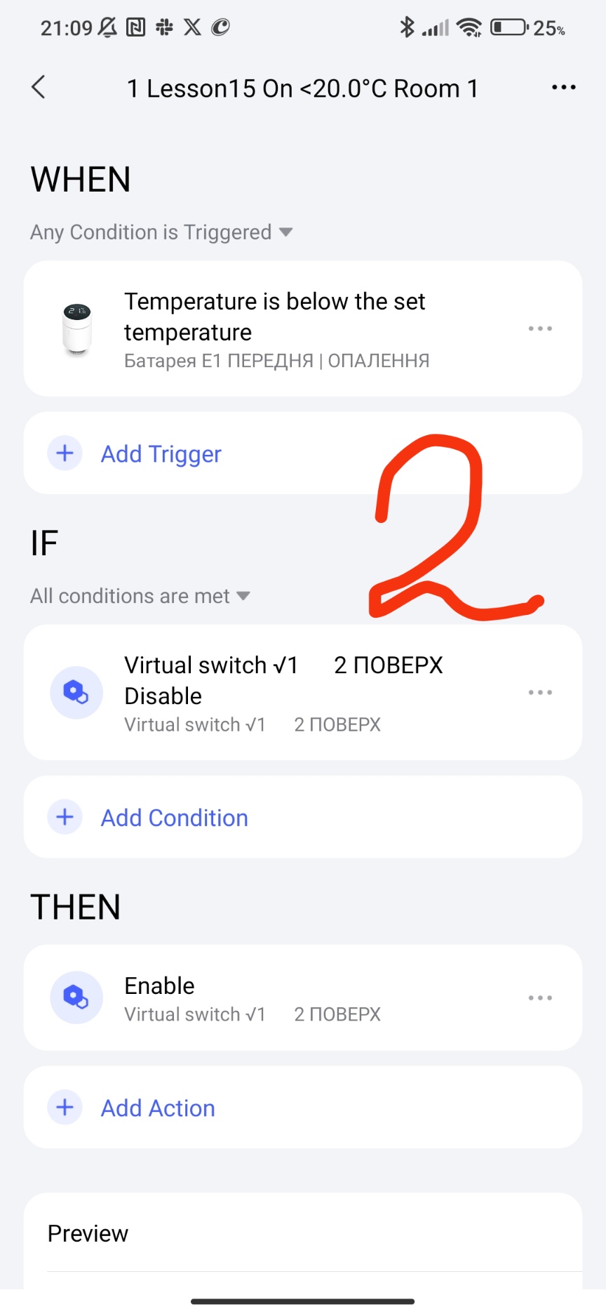

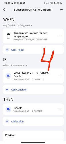

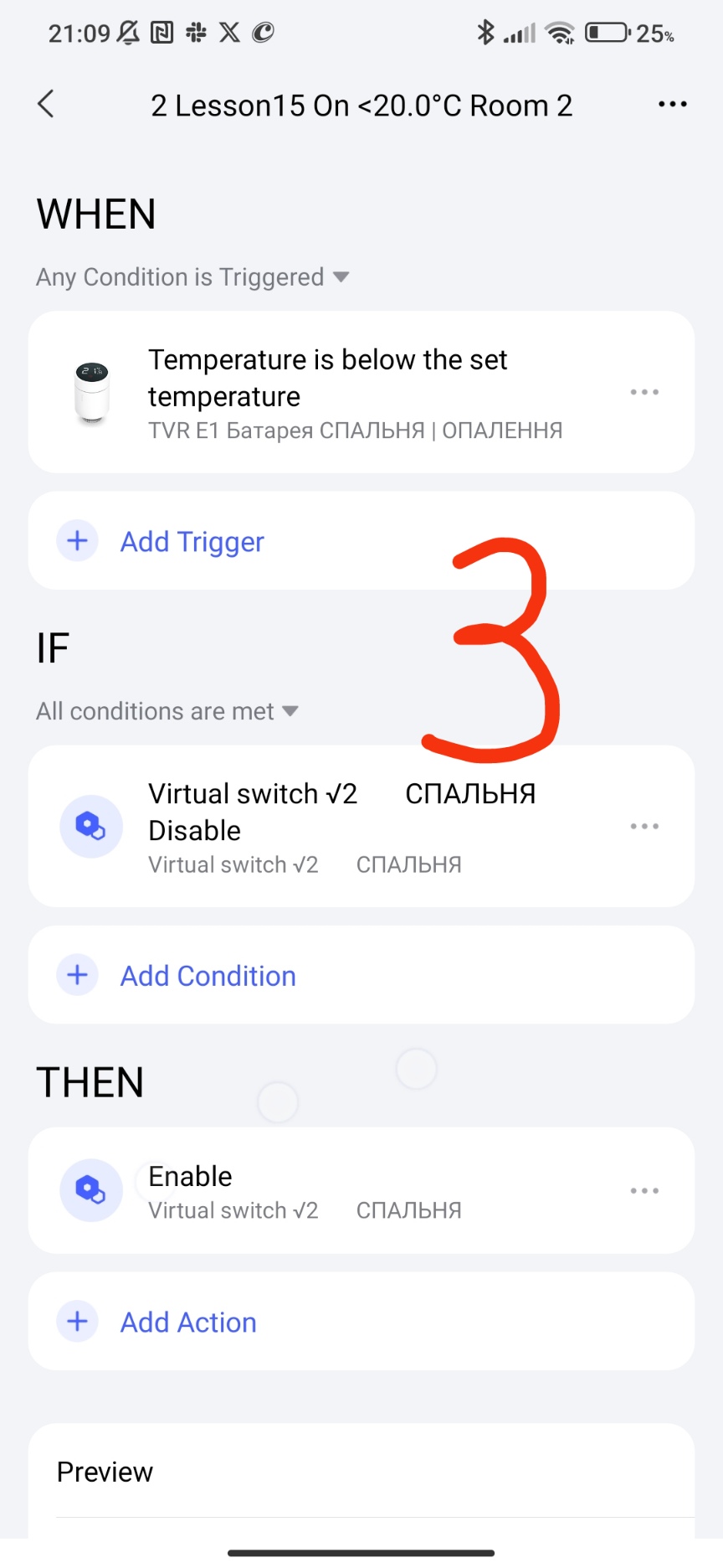

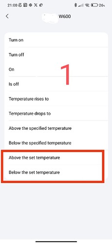

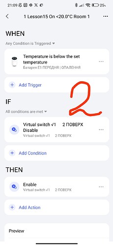

We create automation based on the automation conditions that are in E1 and W600.
Fig. 1.

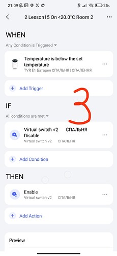

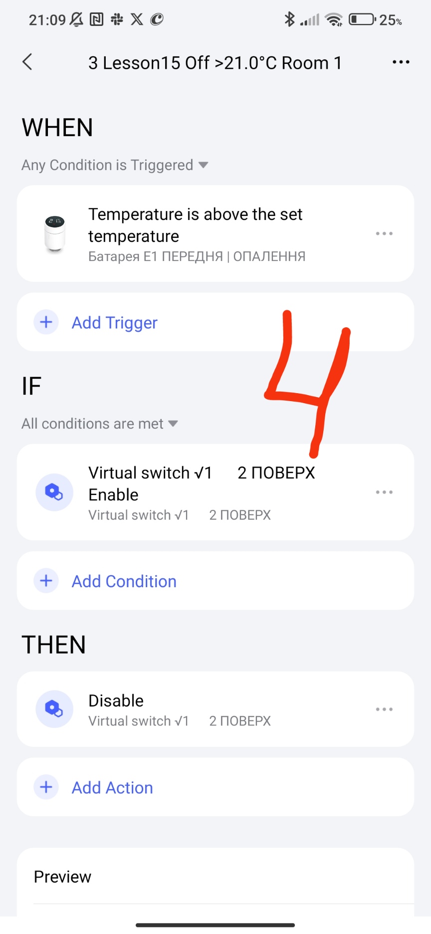

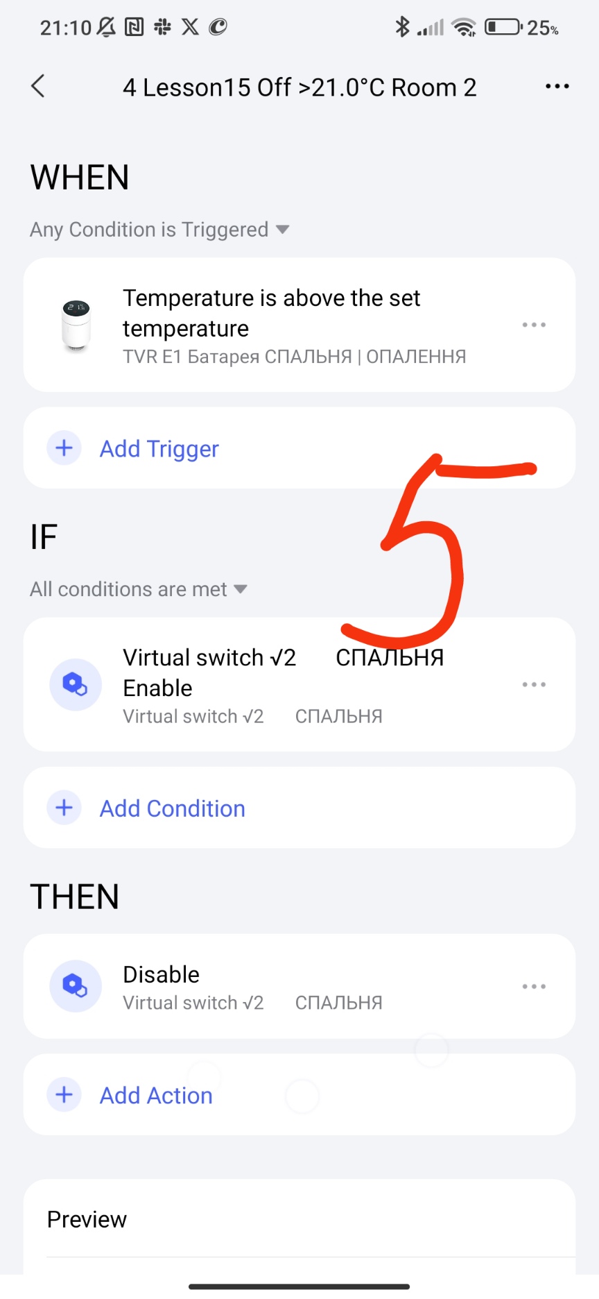

This automation uses virtual switches described in lesson 12 ( Automation 2.0, lesson 12, blitz topic, VIRTUAL Aqara switch ).
Type of automation for two E1 or W600 devices.
Fig. 2,3,4,5

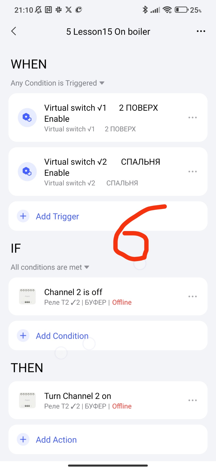

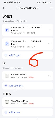

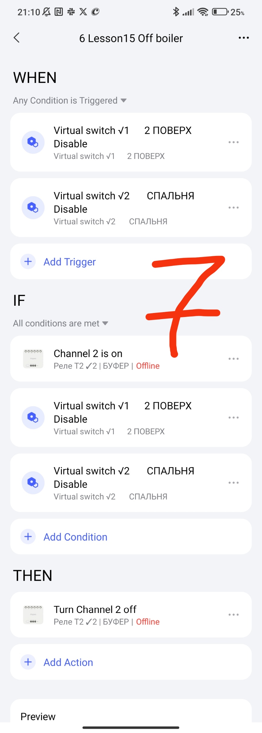

The third section.
We create control signals (On/Off) for relay T2 that controls the boiler. We looked at this in lesson 14 ( Automation 2.0, lesson 14, creating automations for controlling groups of rooms using radiator thermostats (E1,W600) and a controlled heating boiler ).
Automation looks like this
Figure 6.7
