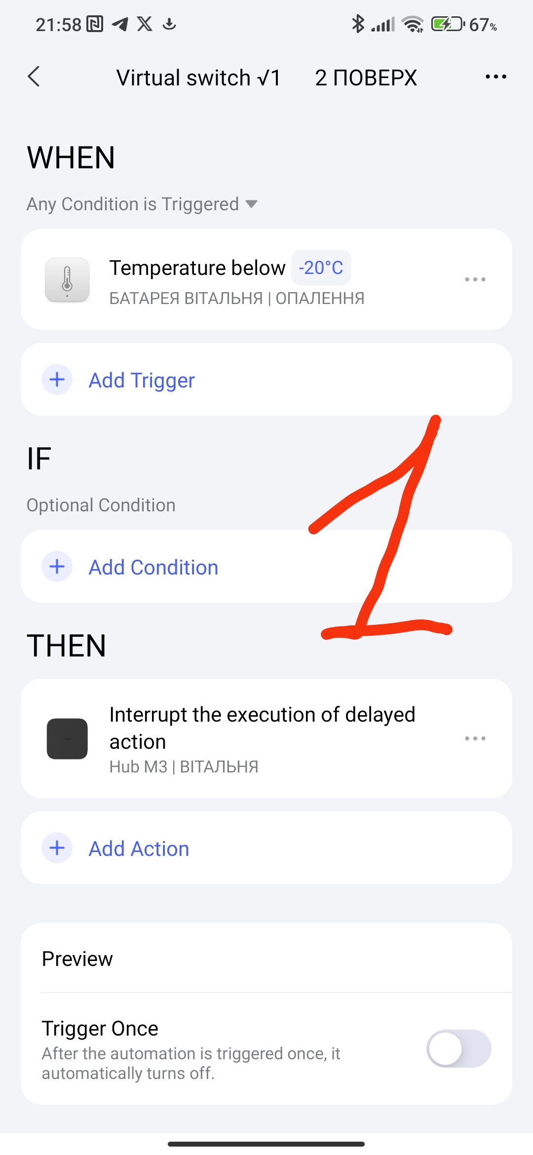

Let’s create a virtual switch based on automation. This automation is created so that it is never executed.

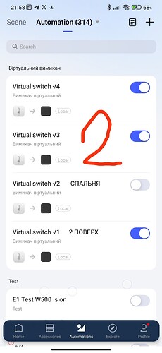

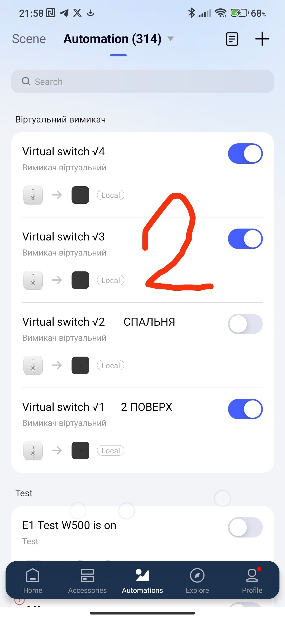

Fig. 1, 2
These are the virtual switches I created in my smart home.

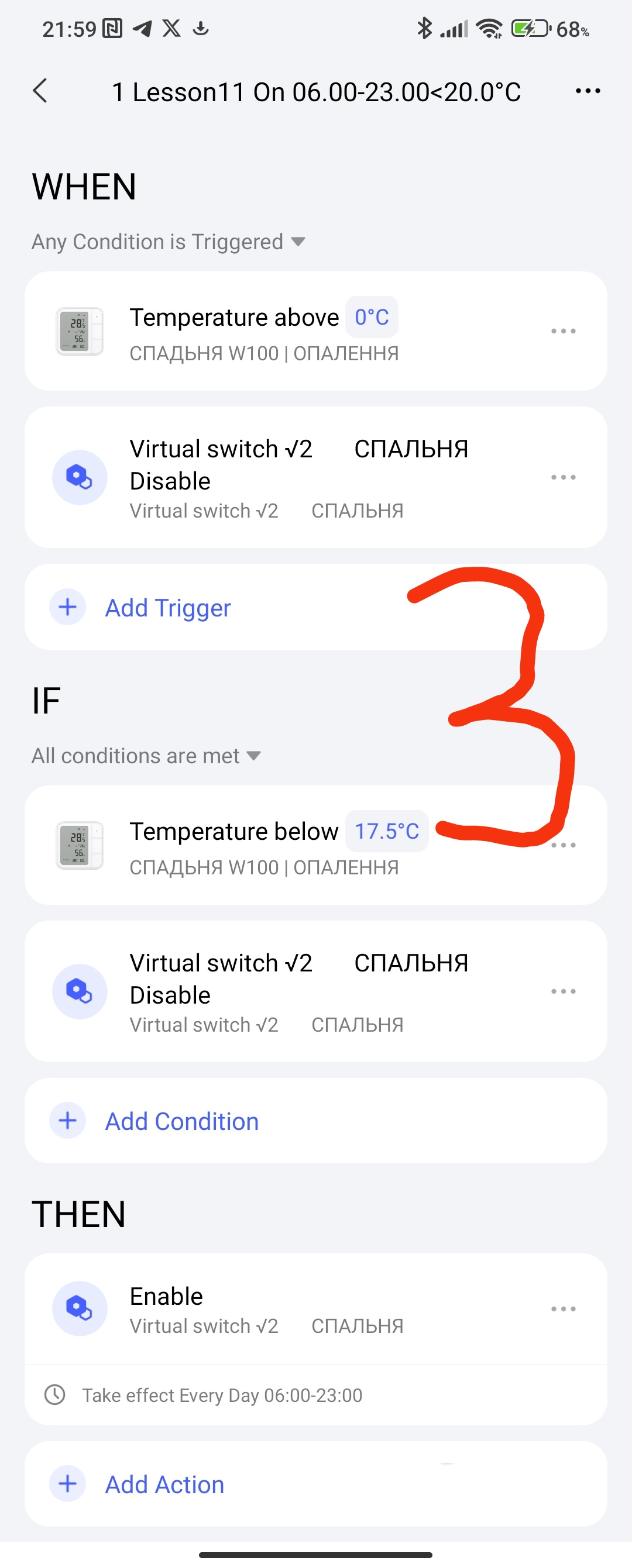

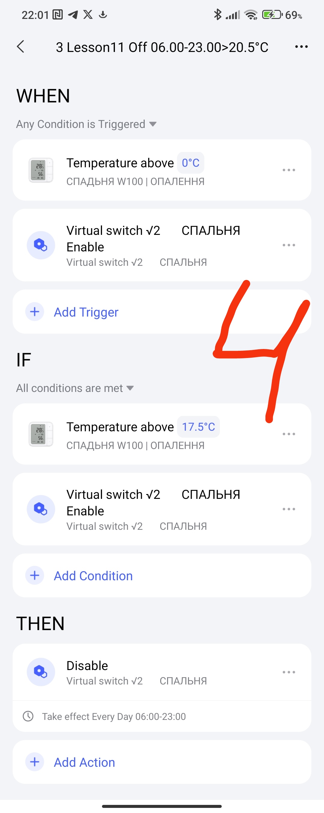

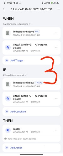

This group of switches (virtual) will be used for heating automation.
This is how virtual switches look in automations.
Fig. 3,4
ATTENTION, FOR INFORMATION! In automation 2.0, all actions related to turning on/off in all sections (WHET, IF, WHEN) are now LOCAL.

That looks good in Aqara app but unfortunately in Apple home app it doesn’t remain On the status changes immediately toggling back to Off
Hello, maybe you have an unused contact of the T 2 relay or an old Aqara relay. You can make a virtual switch from it, the status should not change there. I use it too.
