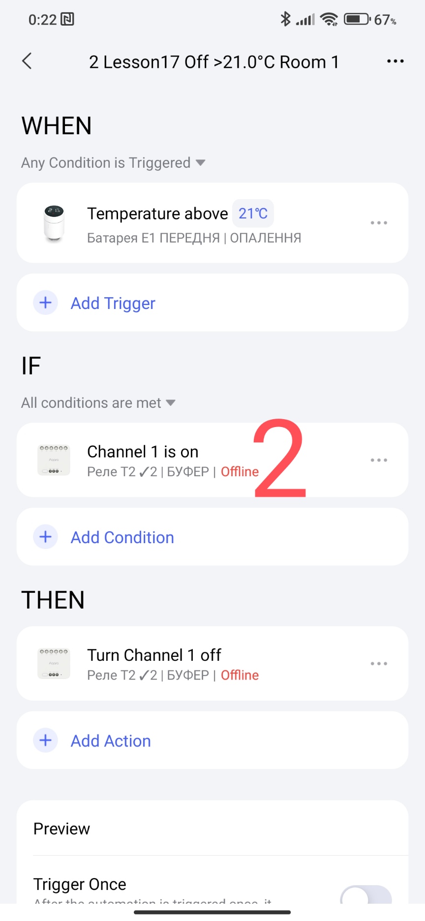

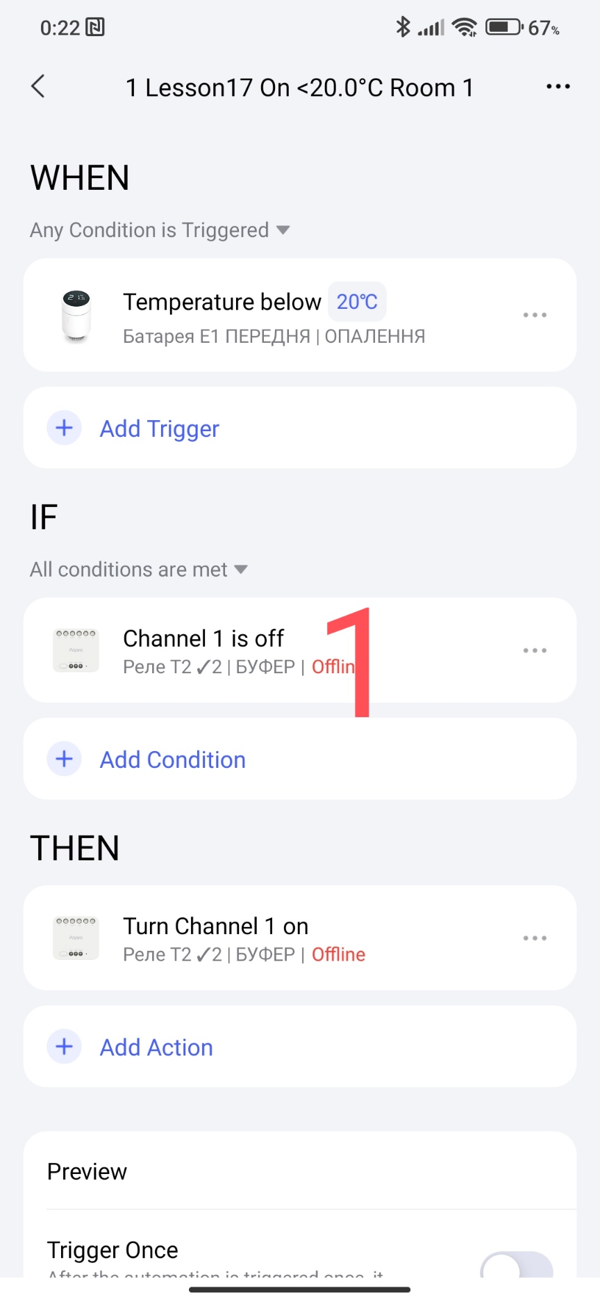

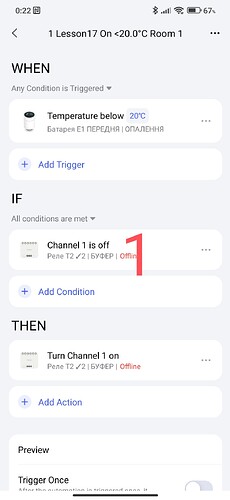

I decided to give an example of a simple temperature control automation. In my lessons, I often presented complex topics and missed elementary automation. Therefore, I want to give elementary examples of automation where there is one TVR and one T2 relay (which controls the boiler). You can see the additions to the lesson topic in lessons 10-16.
1.
On room <20°C.
Fig. 1
Off room >21°C.
Fig. 2

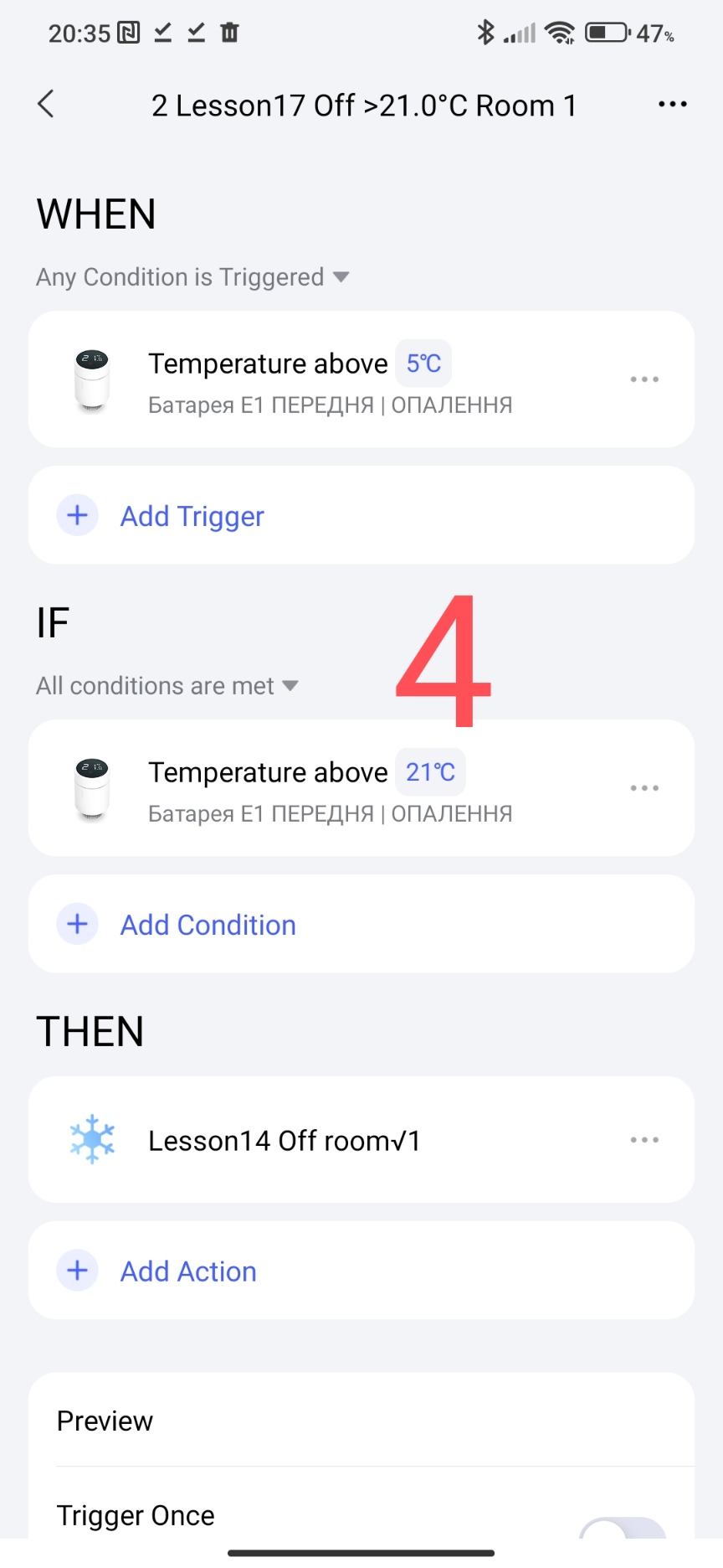

As the question on the forum progresses, I’m adding a mini lesson. This is a way to disable frequent E1 control (reduce engine noise).
Creating scenes for On/Off E1
Fig2,3,6 (lesson14 Automation 2.0, lesson 14, creating automations for controlling groups of rooms using radiator thermostats (E1,W600) and a controlled heating boiler )
We create work automation.
Fig4,5
Please note!!!
In the WHEN section, I enter a constantly valid condition (temperature higher than 5°C) that will query the IF section with each change of state (or period).
