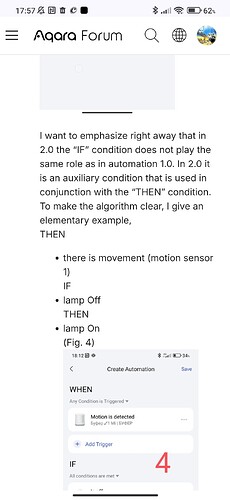

Please give an example of automation in 1.0 that cannot be done in 2.0. Screen

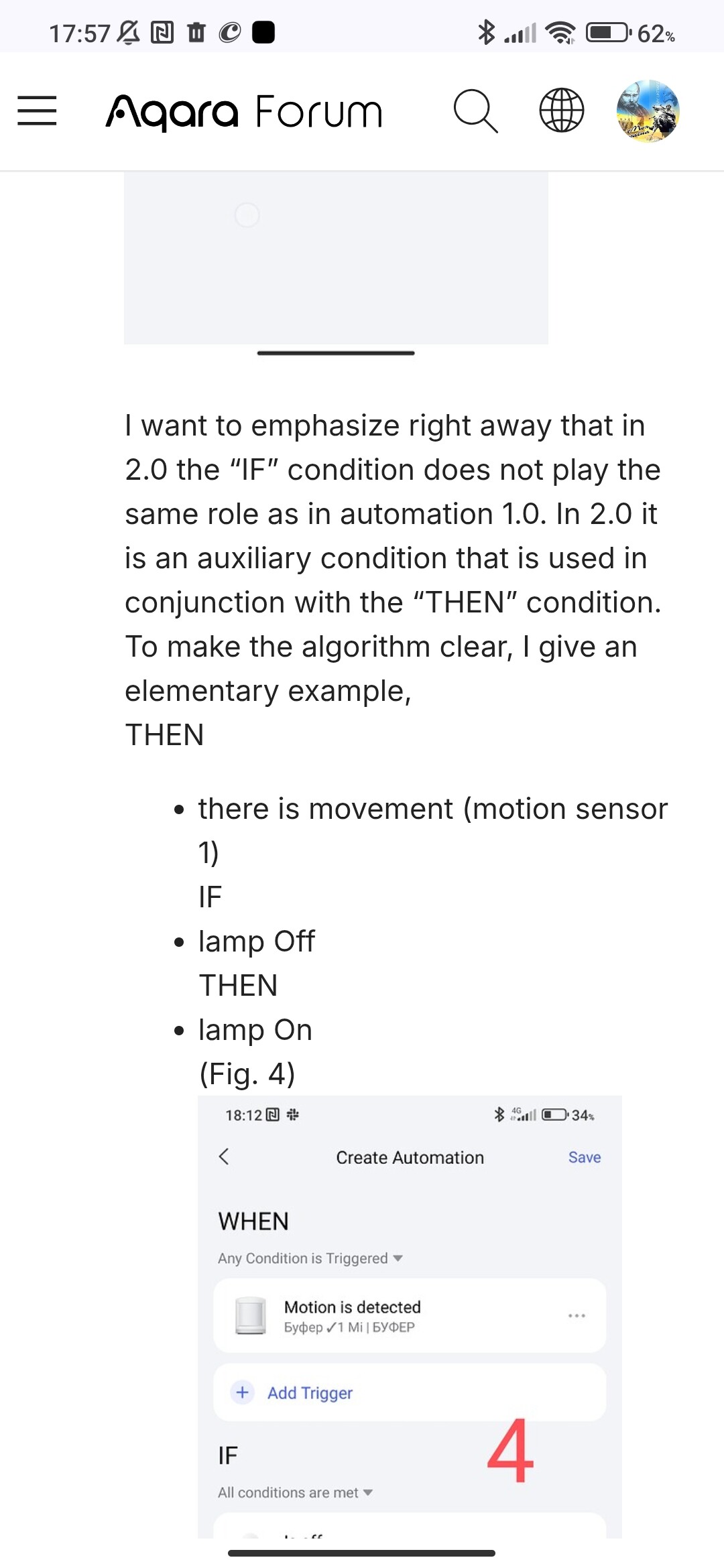

Hi, read lesson 1, I described the work of 2.0 here.
It would be a solution if the ‘When’ clause could be empty, because I only want to apply ‘All’ logic to the ‘If’, but I can not leave ‘When’ empty.

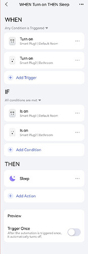

I think I have a solution to this issue, please post a screenshot of the automation you need. I faced a similar problem and solved it. I’m talking about 2.0.
I also plan to do a lesson on this issue.

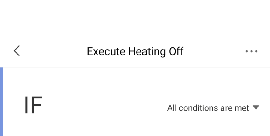

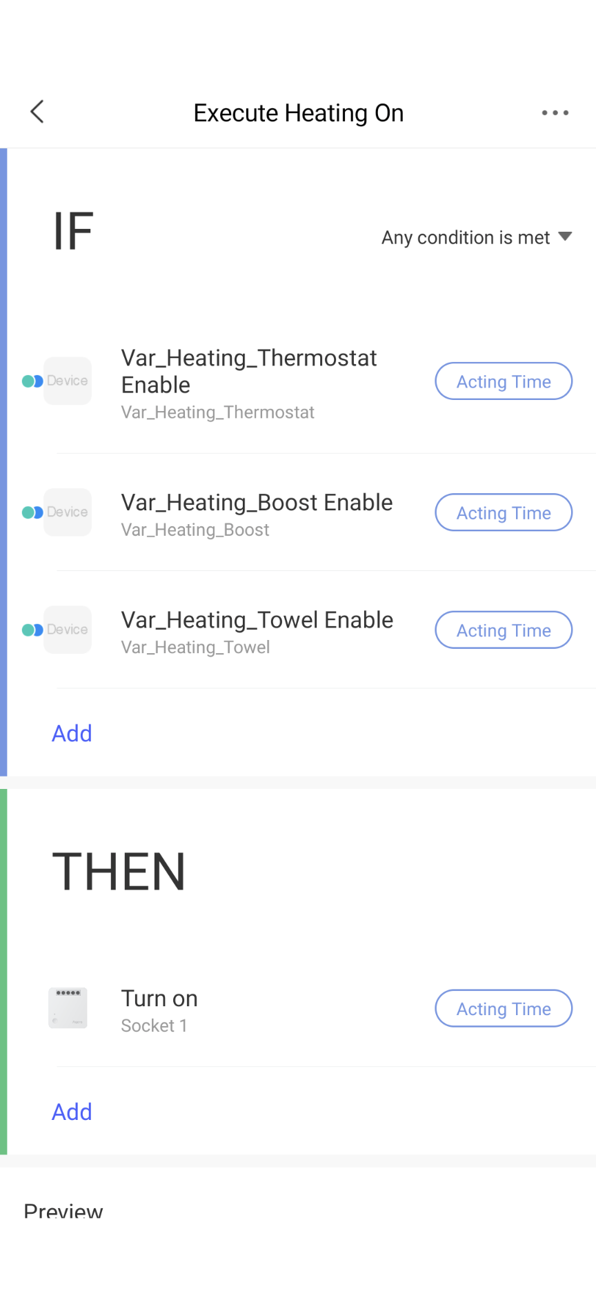

I have many automations where the logic is something like
If A or B or C
    turn on
elif (not A) and (not B) and (not C)
   turn off
endif
Here is one such example

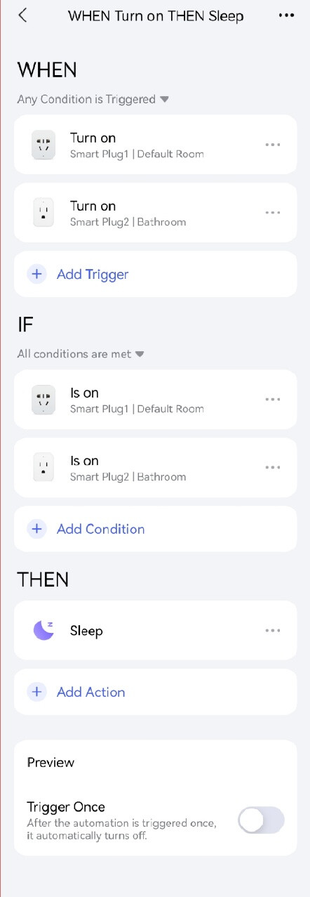

Now, translate at least one automation to 2.0 and take a screenshot here. I’ll finish the solution. There is a solution :slightly_smiling_face:
I already translated it to 2.0 and it duplicates it into the When block. Is this guarenteed to be equivalent functionality?

This isn’t actually a flaw, but rather a consequence of the new structure. When can only trigger events, simultaneous triggering logic cannot exist. So if you need to implement your idea, configure it according to this logic: any one is turned on, and all are on, then…
This is not an Aqara limitation, it was merely an issue with the previous V4.3.7 firmware. Currently, this additional logic is no longer required.

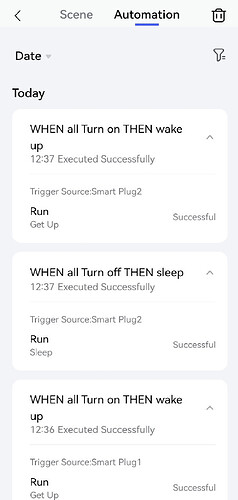

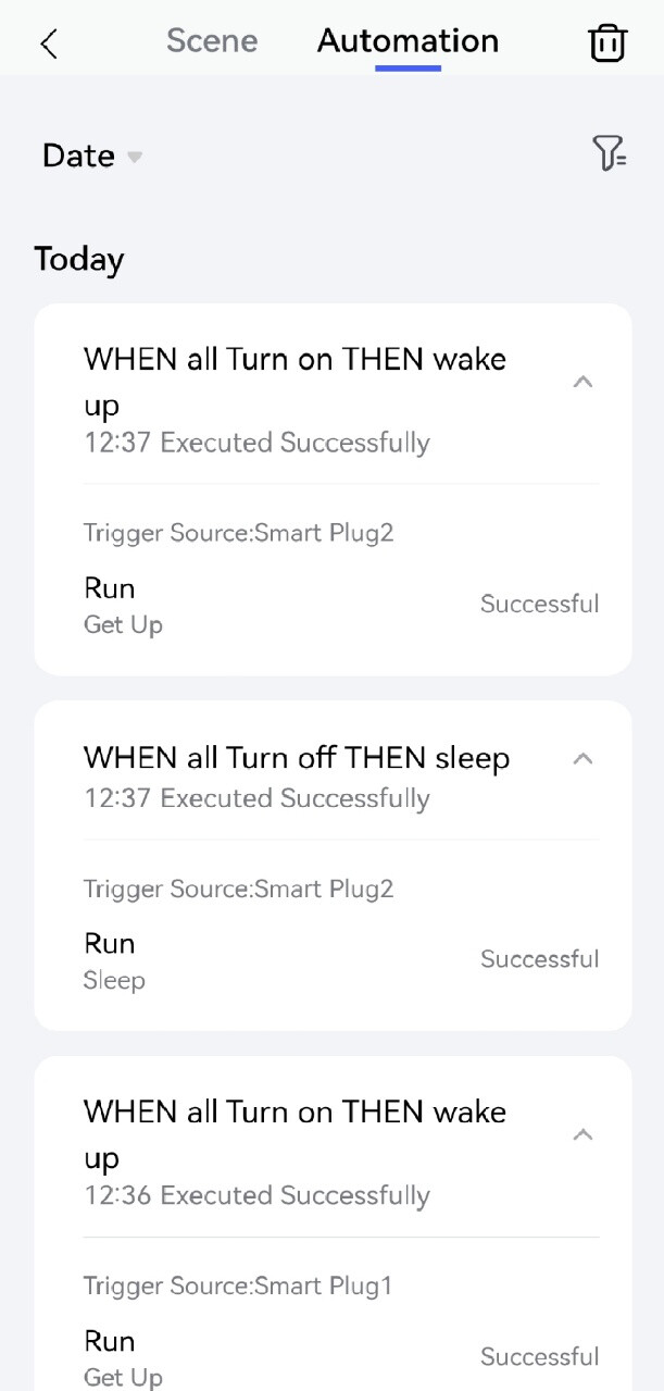

Hello, the automation you created for the example doesn’t work. Check it out for yourself.
Of course, I have many similar automations, all of which are running smoothly.
Thanks for telling me, they were down during testing. I’ll check and report back.
