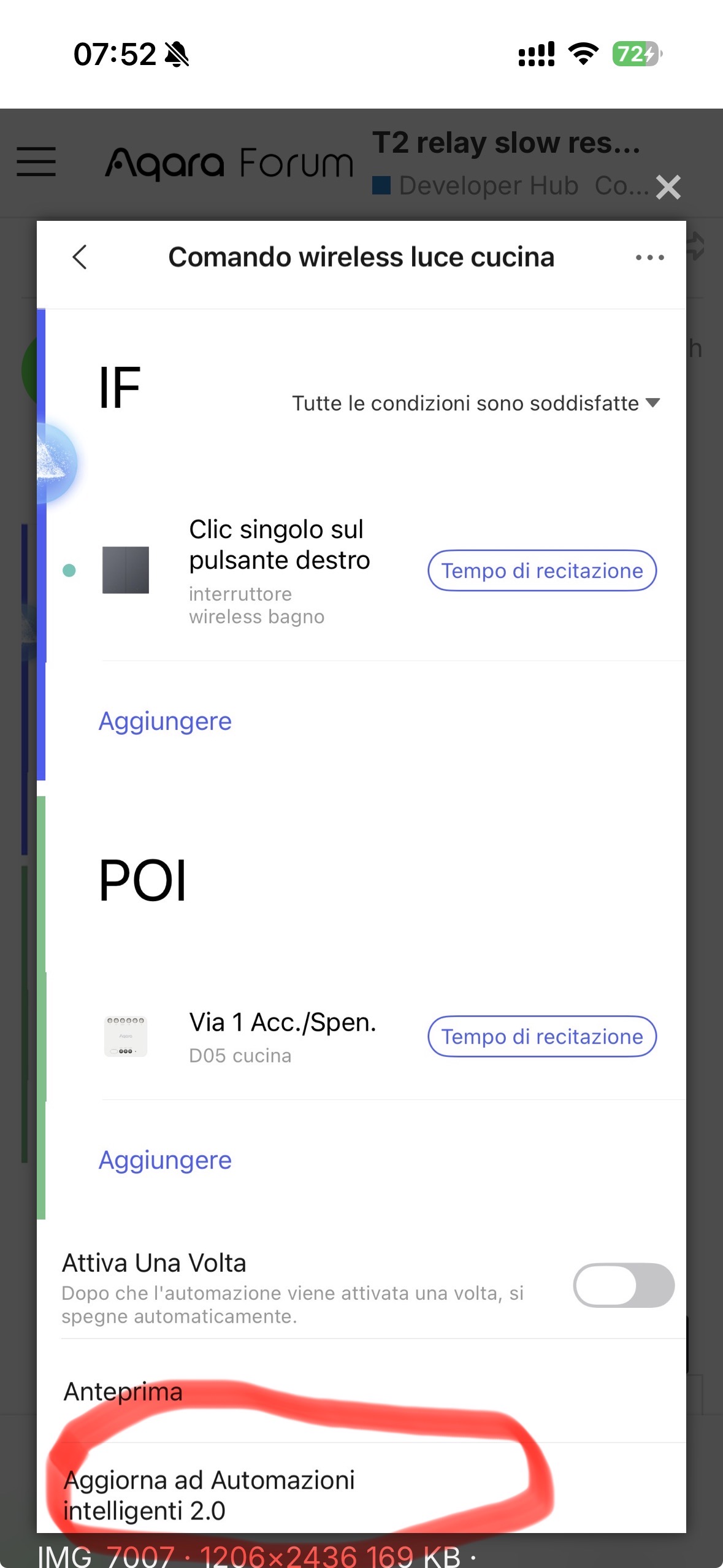

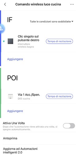

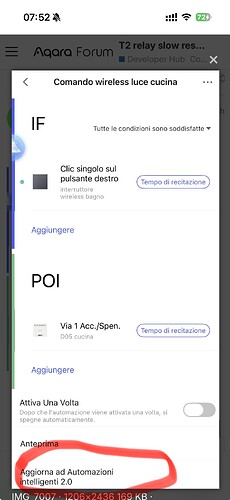

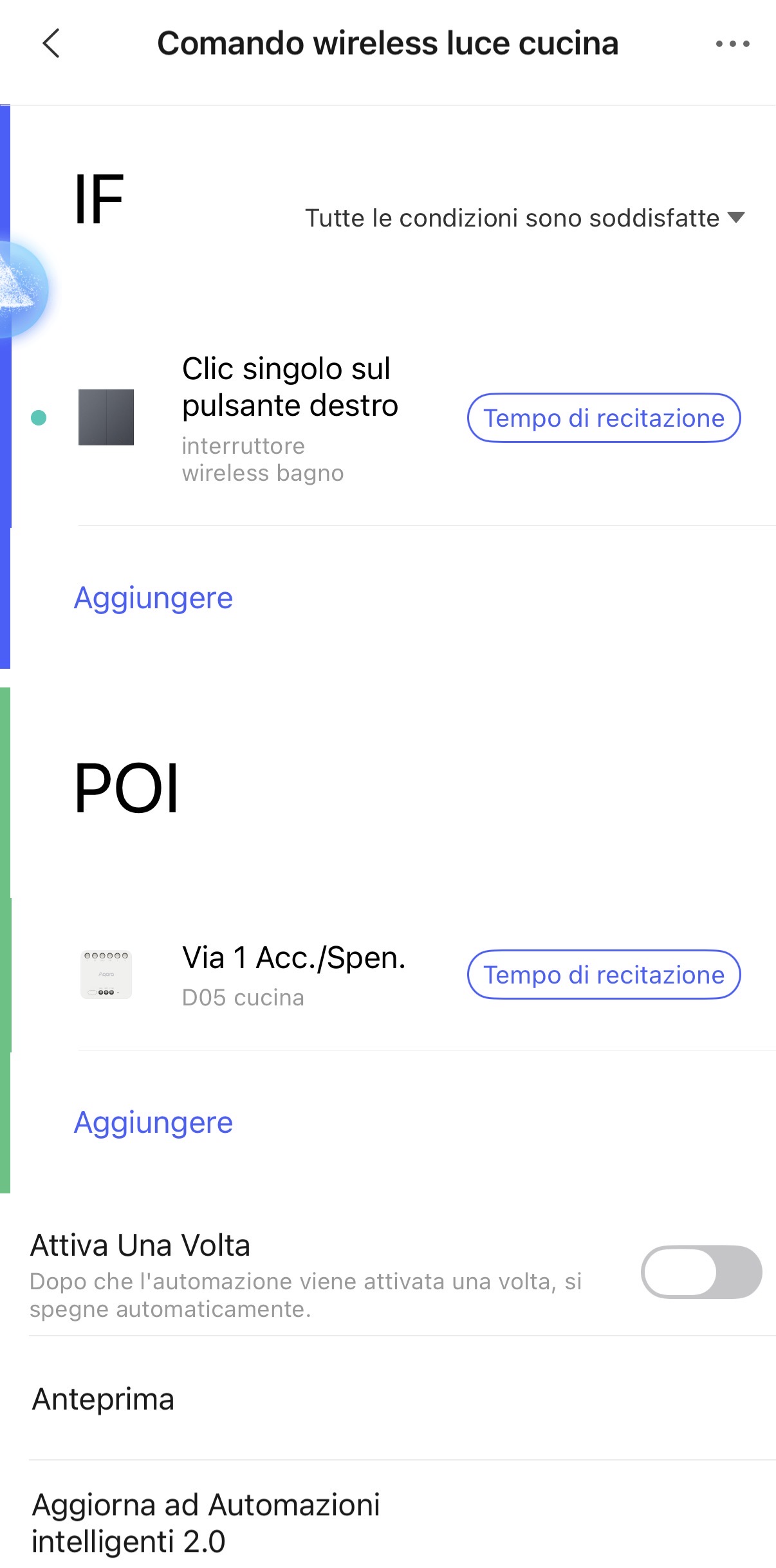

Automation 2.0 is active … but the automation is not changed to it , or? Italian is not my best language :cowboy_hat_face:

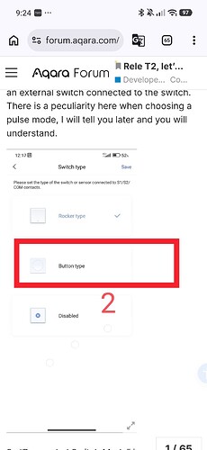

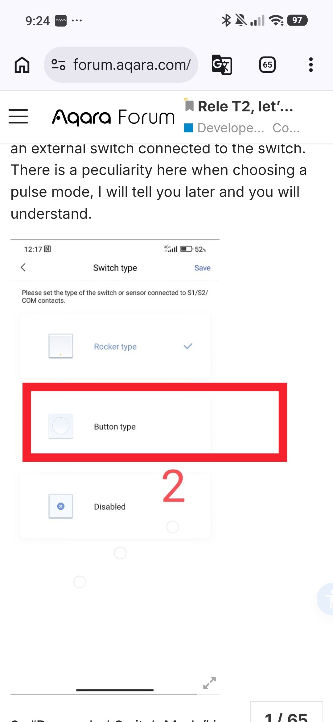

It is possible that your problem with the physical switch is related to this setting. (trailing edge delay).
Yes it says: “update to automation 2.0”, so I think it needs to be updated.
I’m not familiar with the process tho since I’m a new user of Aqara products
Hello, welcome to the forum. The 2.0 launch process is described here.
